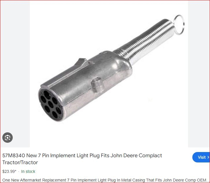

"Just wire it to tractor when it arrives" as I do not have the system yet but have looked at what is included with it, I believe it comes with clips to attach to a battery. How can it (easily) be wired to the tractor? I have ordered a Tectran 7-Way SAE Plug with Spring Guard and am hoping my electrician neighbor can set it up for me. He has a lot on his plate so do not know how quickly he will be able to do this.

As the tractor has no cab, it has no 12v outlet. The current spray system is powered by a plug to the seven terminal outlet on the back of the tractor and is easy to connect and disconnect.
Is there a reason why you can't power the new pump off the same seven terminal plug? Just get the plug end and wire it to the new sprayer. Or, add wire and battery clips as mentioned temporarily.

"power the new pump off the same seven terminal plug" yes, I could. But. I plan on keeping the old d.i.y. sprayer setup as a backup. It currently is functioning and rather limping along. I have ordered a new identical(so I know it will fit in the tractor outlet) 7 terminal plug, it should arrive shortly, the sprayer should be in at Lowes next week too. I just need to get a off/on rocker switch and I will be ready for my electrician friend to go to work.

One has to wonder if the 7 pin connector is same as found on pickup trucks..... And Why you had to order it through a home building supply....
   / can a rechargeable 12v battery power a pump? #19
Her 7 pin connector for a 5055 JD probably looks like this. Id. presume you can piggy-back 12V and ground by add 2 extra wires to the current sprayer feed (so to speak !). You get what you Voltaged for....
