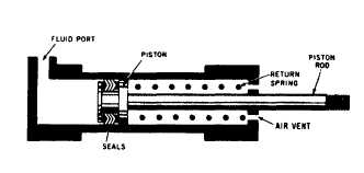

So all SA cylinder have some kind of one way vent built in to allow air in?
Yes. Some plow cylinders just have a weep hole behind the wiper seal, some do it other ways, but air has the get in some how.
   / Can a SA cylinder be used with float #12
A true single action cylinder has an air vent at the top on the cylinder, unless it has nitrogen, compressed air, or is spring returned. Look for a vent hole that might be stopped up with rust, crap, etc. It might take a magnifier glass to find it, but it is there. The cyl will have difficulty returning/collapsing unless the air is allowed in to the rod/cyl chamber.
