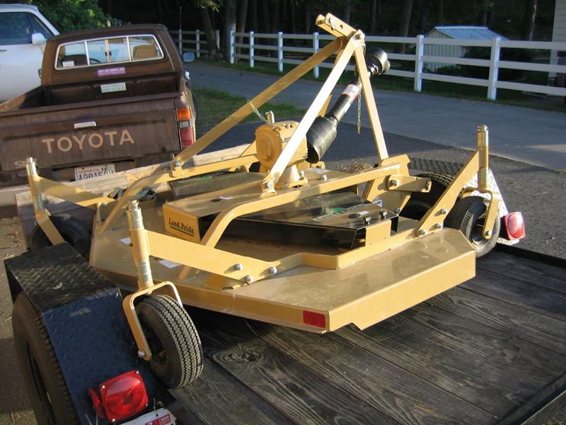

Well I can say that a TC24DA will run a 72" Land Pride mower deck just fine. It's definitely not the ideal size for it but it will handle it. When in the long stuff it was working a bit harder than I would like but now that I've got it mowed I an stay on top of it.
This is a pic of it on my trailer. It barely fit on my 5x8. There is a picture of it mounted on the tractor in another post with some other pics of the new tractor.
