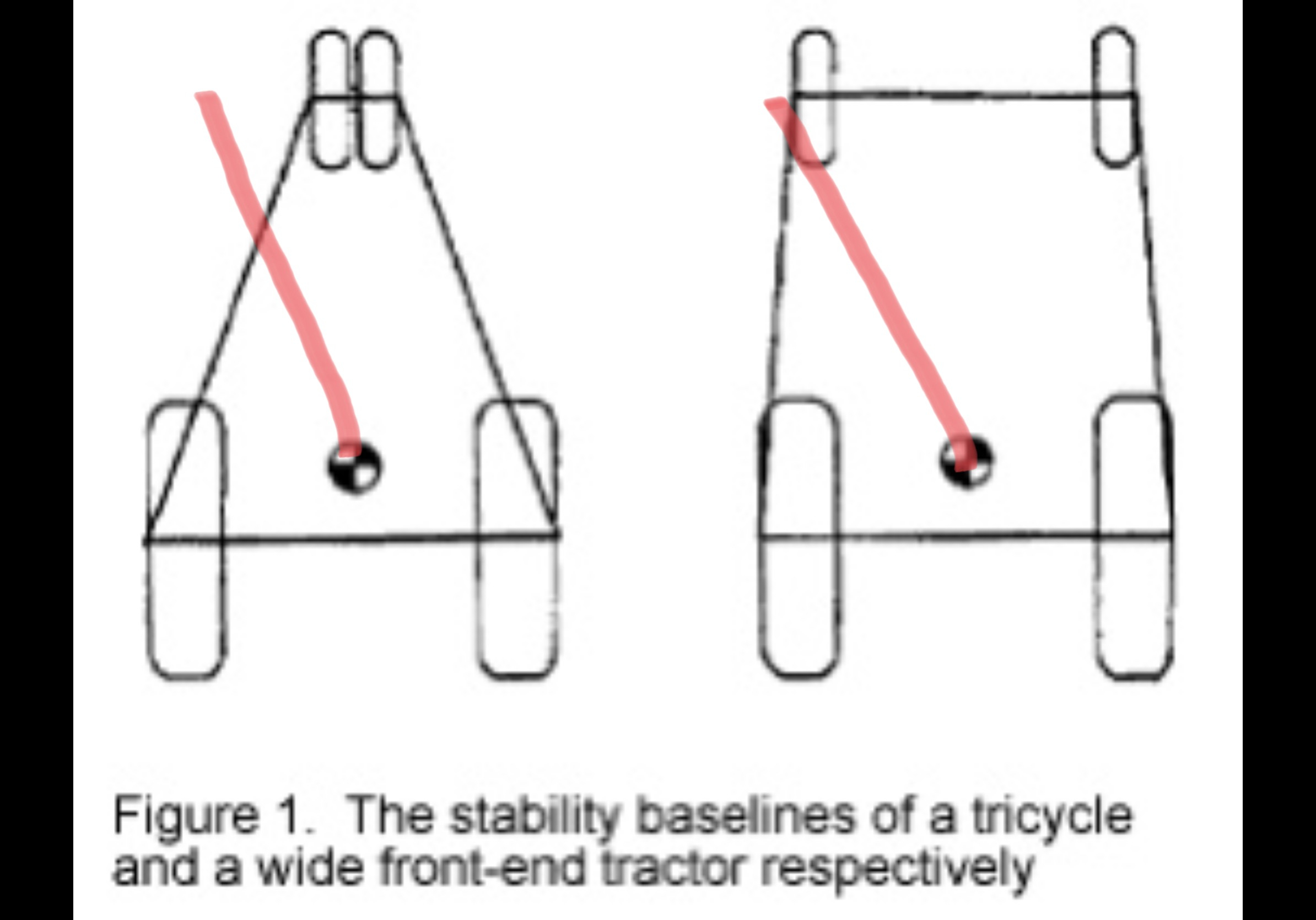

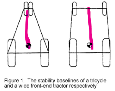

That would be true if both axles were rigidly connected. But every wide-front tractor I've ever used has the front axle jointed so that on uneven ground it isn't constanly trying to twist the machine.
You think Penn State, Iowa, Wisconsin, Kentucky, Indiana, Nebraska, etc. studies are all incorrect?
How about this one?

Oh yes they are. Once the front axle reaches the stop outboard of the pivot point (during a roll axis movement) the front wheel becomes an outrigger (FAR further out to the side than a tricycle front wheel.) Obviously tricycle tractors are more vulnerable to tipping over. The OP and his issues are not relevant to rolling tractors in the first place.

...and there are how many row tractors (tricycle) on the market today?
Correct. The pivot on the front axle limits the yaw far before the point-of-no-return on a row tractor... but those were made for a purpose.

Your drawing is right to some degree but you’re ignoring the fact that the front axel has stops.
Not ignoring them, but accounting for the fact that they don't come into play until you have already rolled a bit, and you may well have enough momentum by then to go on over, especially on a side hill situation.
