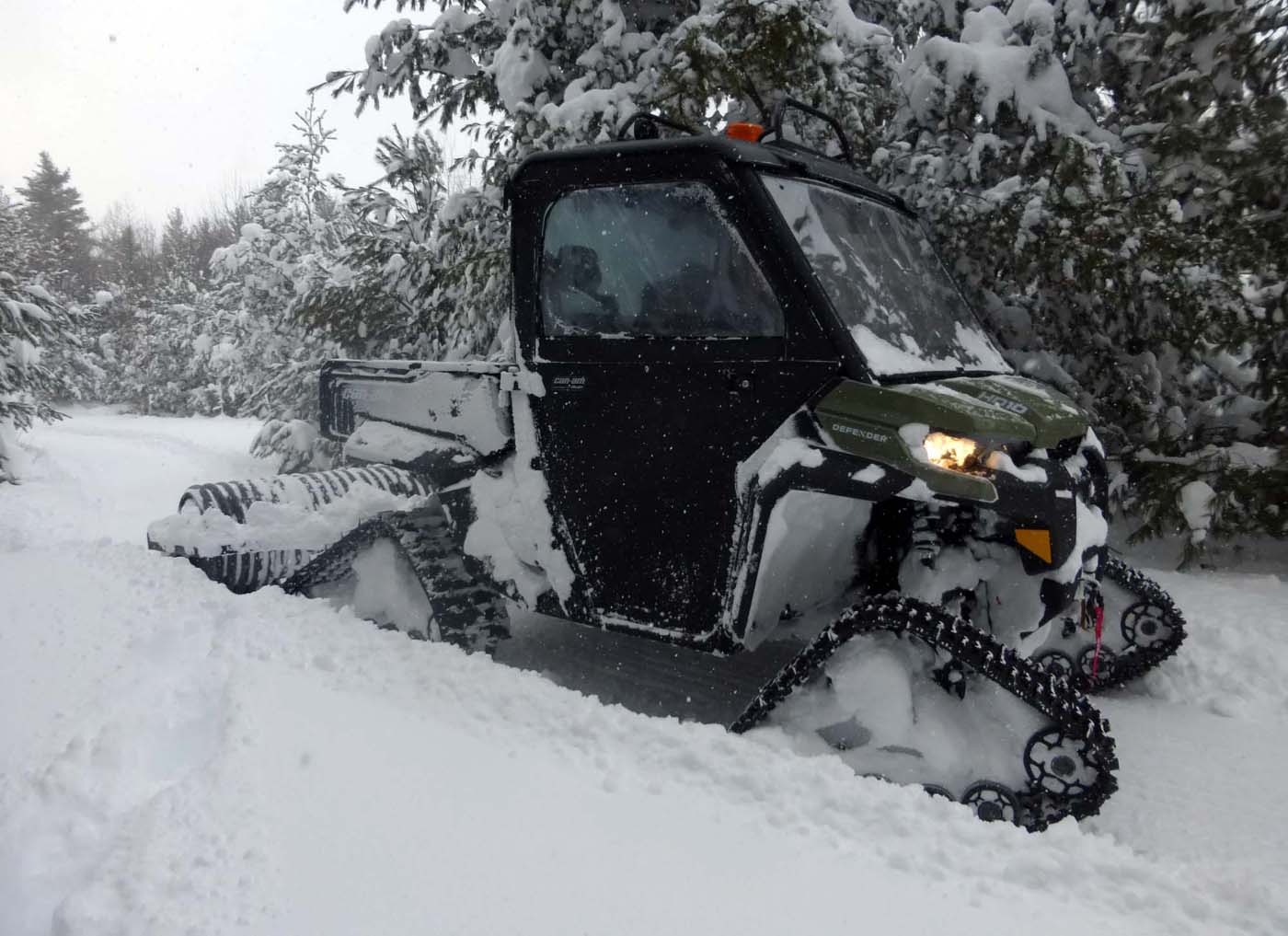

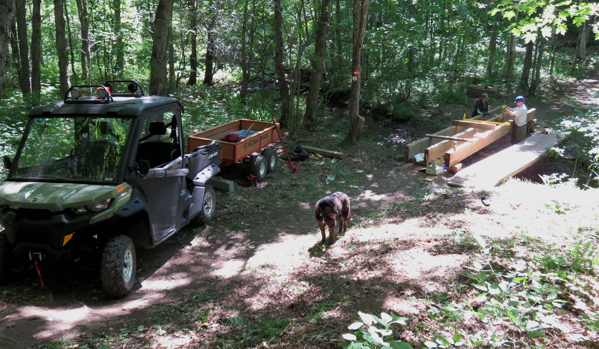

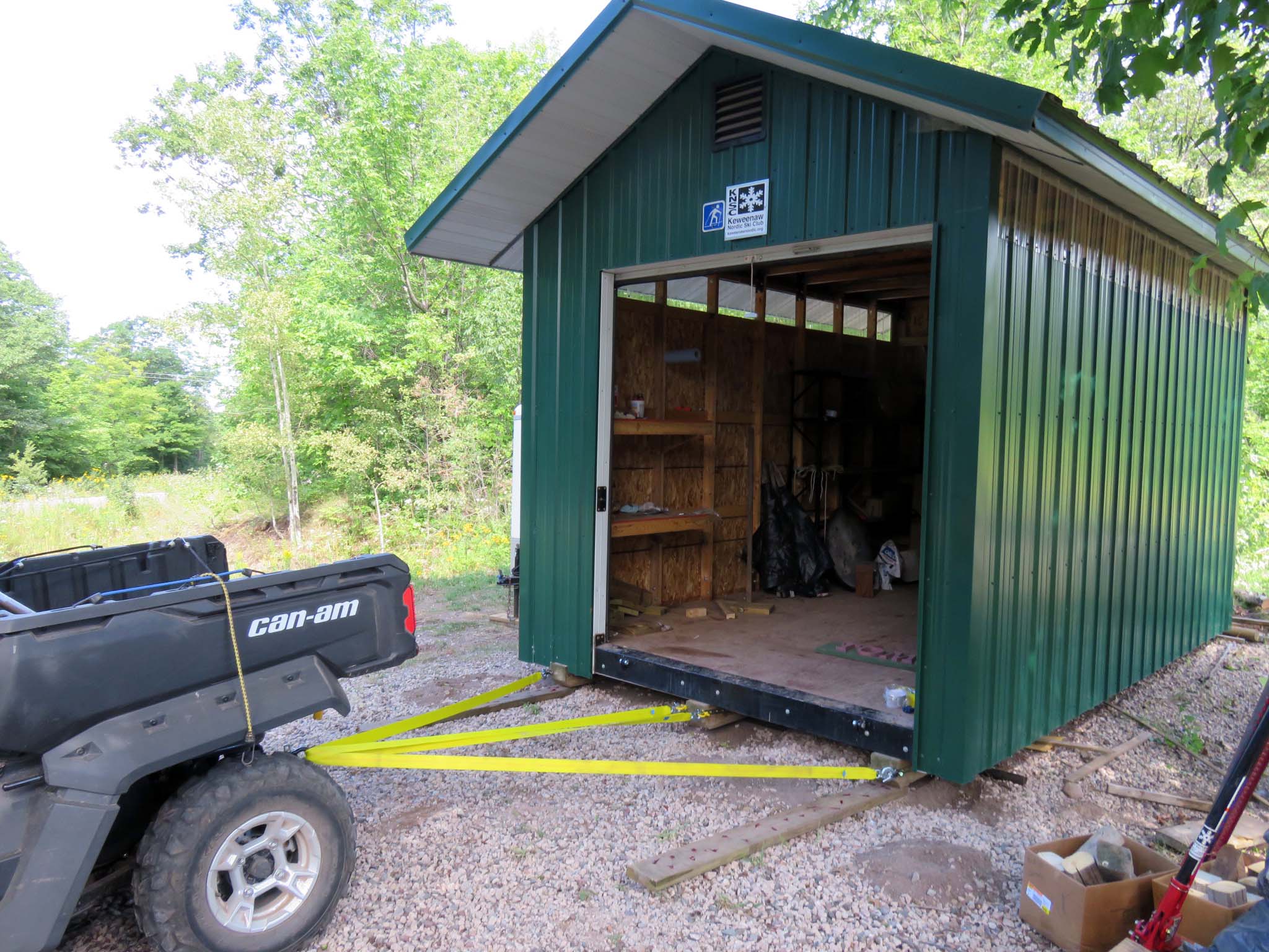

This is a can-am 2016 HD10 Defender review. Hopefully I'll not screw this up to much! I'll attach a few photos but we didn't get the defender until late, and never used it with with wheels mounted. Some photos will be of the Rhino to give you an idea what we do with these machines..
This past fall we were replacing a 2009, 700 Rhino which was at the end of its life expectancy with us and over the years found it was very short on HP while operating it with pods and in snow. We had UTV-4S pods on it. (you call tracks) So we hoped for more power in a new machine and having quite expensive maintenance grief with Camoplast products, we'd not get them again. Please note, on all the various machines we've used over the years, we break, melt or create some kind of grief while doing the heavy work we do with them so this might not apply to you. We normally get machines another trail systems have tested to help lessen our problems but we need much more power and having a good BRP dealer here, we went with this new work machine offered by Can-am. Having good service is quite, quite important for us and we do darn little of that ourselves.. I've been grooming XC trails for over 15 years, all within the Lake Superior snow belt so machine problems are not new.. We average 230" here in town. Also note, this not "my machine" and I did not pay for it. I'm just a lowly employee who suggests we need this tool or that.. We try replacing our tow machines every 5 years.

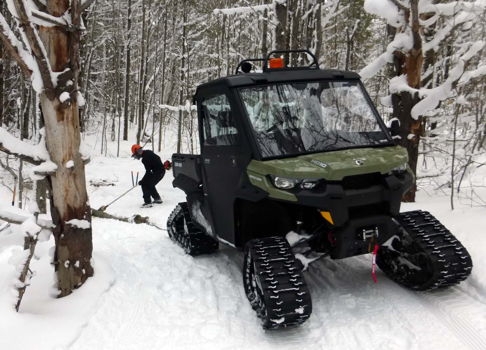

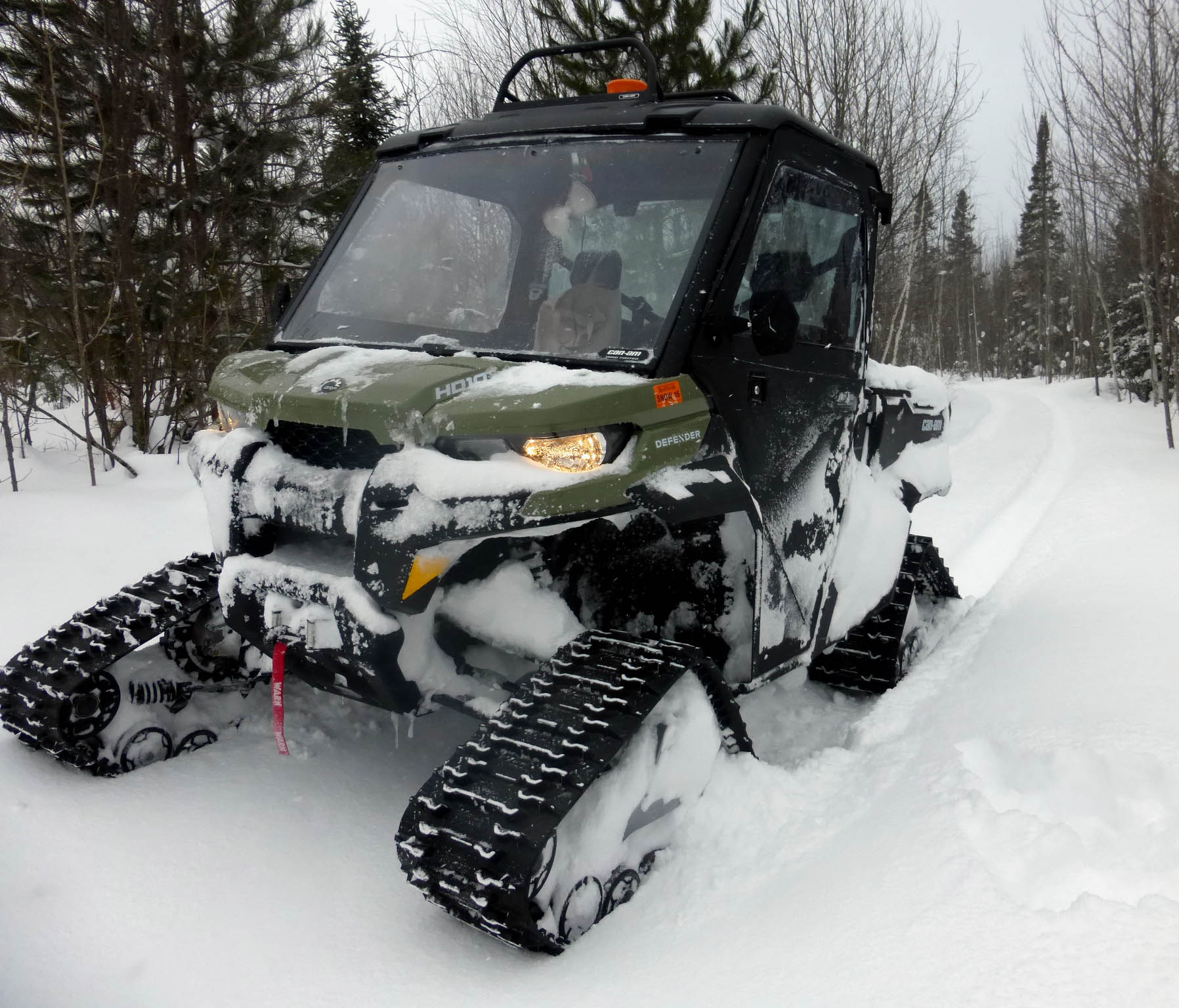

The LT Apache pods after some initial grief, are doing great.

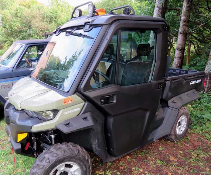

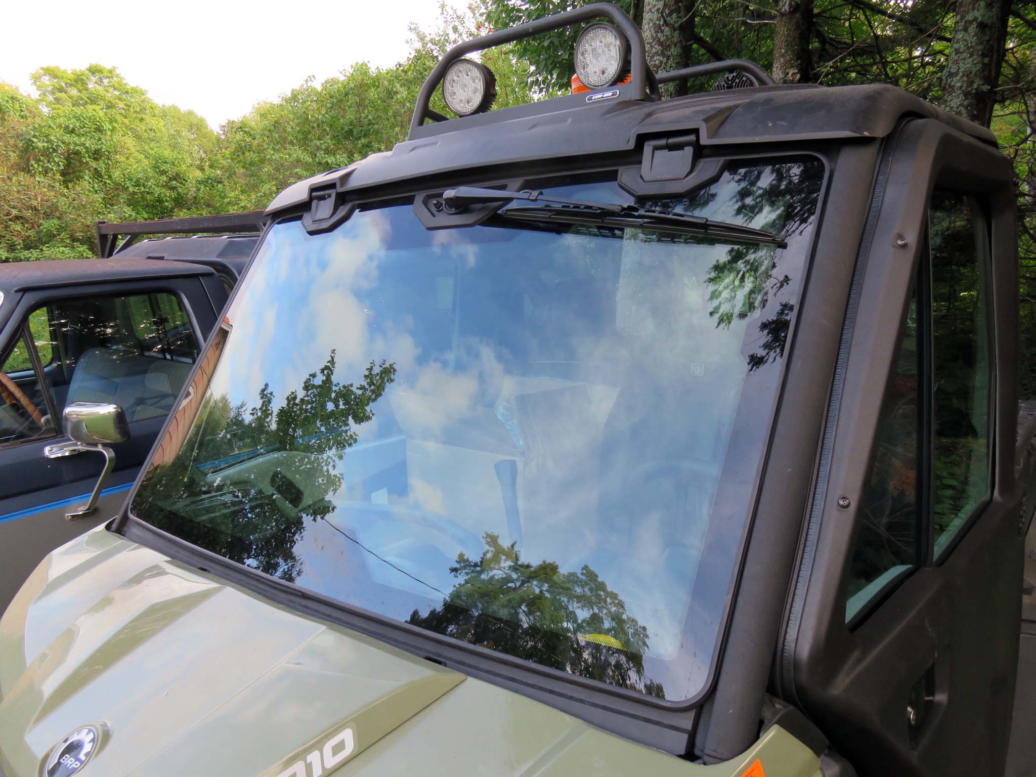

The cab visibility is great and so are the can-am door mirrors we got. We run a cab fan to help keep glass moisture under control.
Steering is effortless and you can even rotate the pods while static! Plus the adjustable steering wheel is nice.

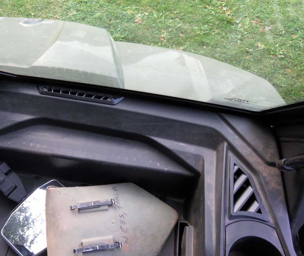

Storage space on and in the dash is really, really nice for working characters like us. We got tools and paraphernalia everywhere!! The snap in-out tool box on the dash is fairly worthless. I added "knobs" to it so we could open it while wearing gloves. We hardly use it and may permanently take it out.

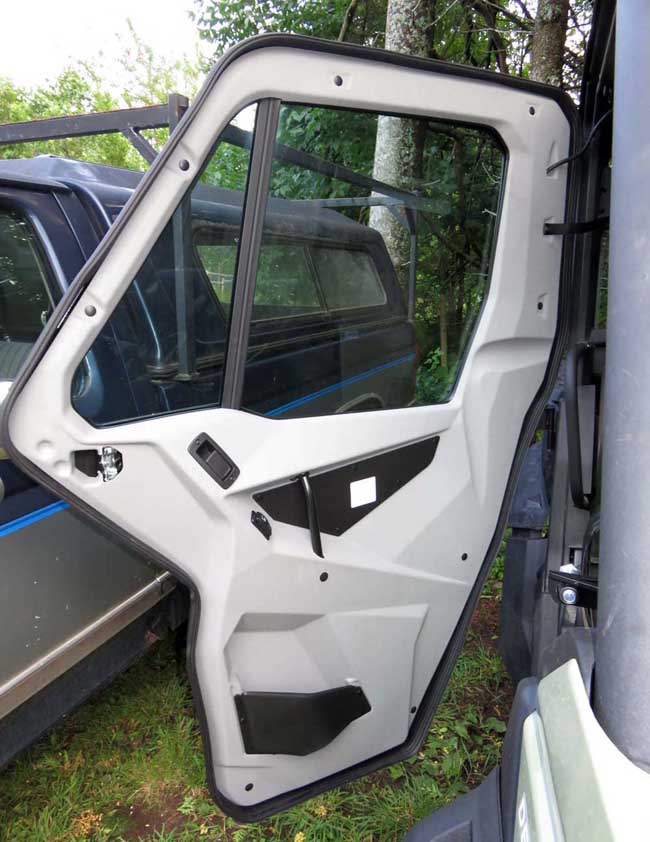

The vinyl covered, steel frame doors are worthless. The vinyl coverings won't stay attached to there Velcro plus the doors are just to hard shut or open to exit.

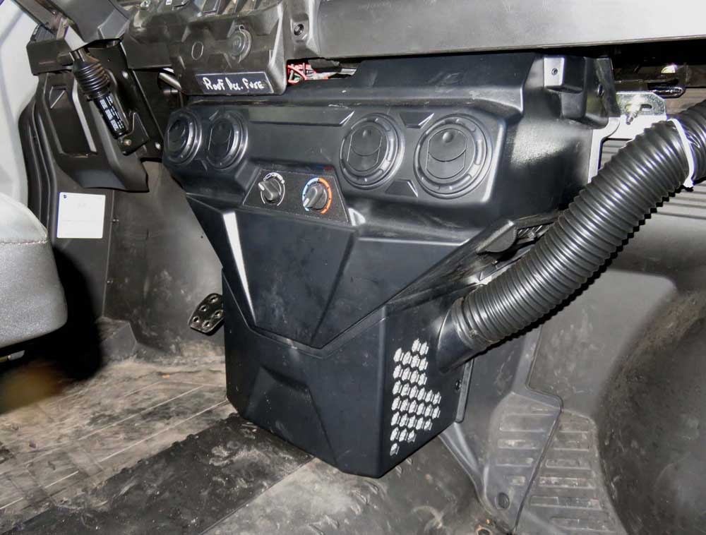

The intake on the CTV cooling system was plugged with snow within the first 500 ft and the hot belt warning light would flash shortly afterwards.. Funny we had a Defender here this fall which we zoomed right down to look at. While there I told the service manager that those intakes could not possibly stay cleared while operating in snow. So they subsequently rerouted the air duck into into the cab. Zero problems since.
