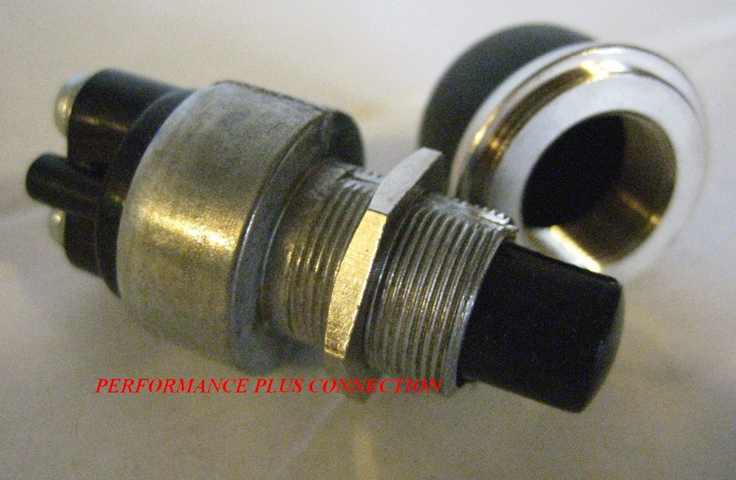

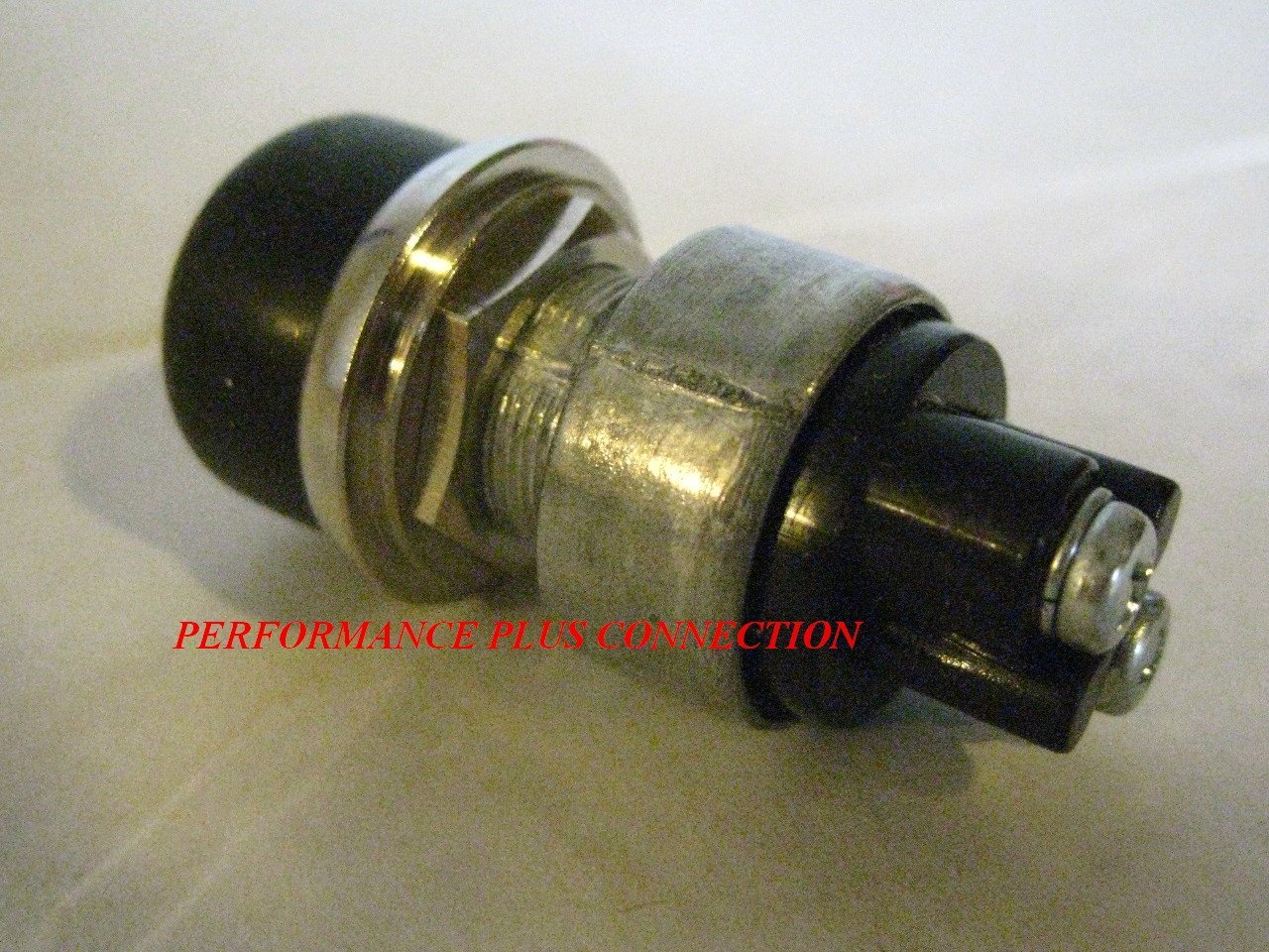

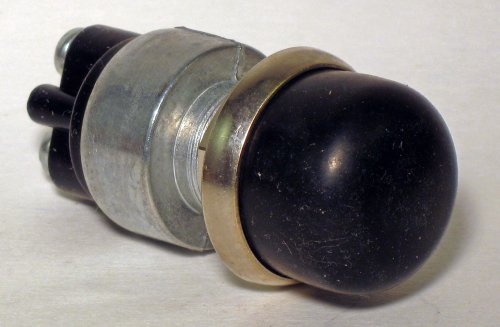

OK, here's my plan.
I am going to remove the dash, but only after I get all the "just in case" pieces needed for either fixing the current ignition switch or putting in a bypass one. I don't want to waste time taking off the dash/putting it back on if installing a remote is the answer. I found this switch online for $10 with free shipping. I like it and it says it is water and dust proof. Will it work? If so, I'll order it.
Amazon.com: Momentary Button Starter Switch w/Boot: Automotive
For an inline fuse and holder, is the tube style or blade style best? You said 20 amp, right? Question, how do I attach the fuse holder wires to the switch wires? In a house, I'd just use wire nuts, but sure those won't work in the tractor...lol.
I'll be busy the next couple of days getting chores done before the next monsoon storms hit and everything turns to mud. The tractor and the jumper wire to start it will be used. I WILL BE CAREFUL...I PROMISE!! :tractor:

That switch looks perfect. Can handle 60amps and has nice screws to attach a lug to. Either fuse type is fine. I went with 20 amp so it would be high enough never to blow starting the tractor but still bring in a bit of safety. It should be close to the battery. I bet the draw is quite a bit lower than 20 amps but can't be sure at this point. This would be my suggestion for the order: wire soldered to lug to go to battery, next soldered to fuse holder, then fuse holder soldered to lug to connect to one side of switch, soldered lug to the other side then wired down to the starter with the appropriate spade type female connector. I like to solder as much as possible using heatshrink to cover the splice and any bare connectors. Someone mentioned connecting to an existing fuse but that will be tougher to do and the fuse may not be rated high enough and may blow often. With a fuse you can remove it if you want and the tractor will not start accidentally. Good for when doing an oil change or if kids are around.
I'd still like to see it fixed the proper way and I bet you have it in you to do it but this will get you by. Changing the ignition switch and safety relay may do the trick but obviously not guaranteed. At least the bypass switch is much safer than what you are doing now to start the tractor.
