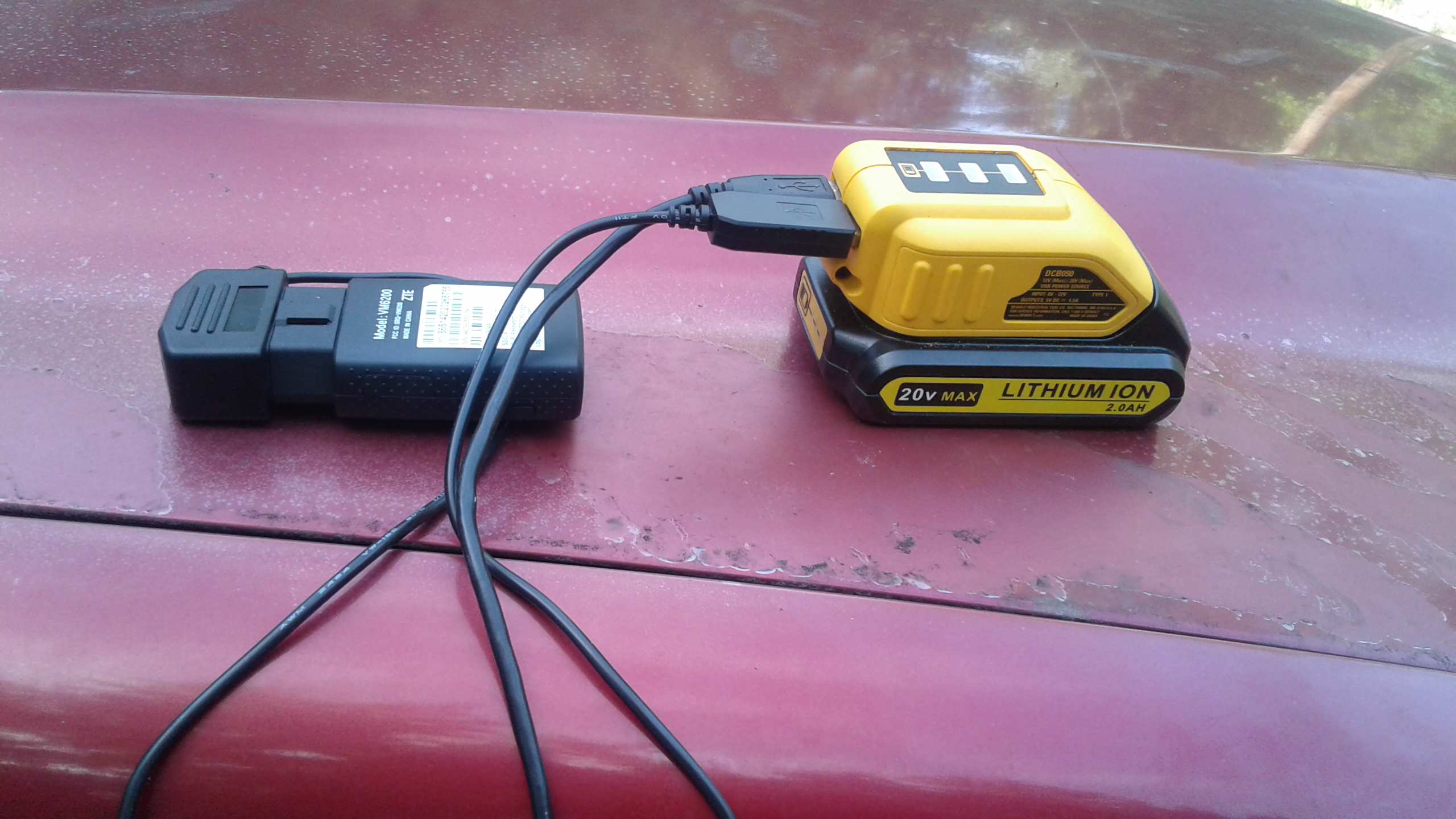

Well I like to "wrap up" threads.
Bottom line is that I got "Mobleyed" and it travels with me.
Right now our internet wired data link is supplied by the local phone company. We pay a hefty price for a mere 5Gb link that I was going to hook up to the fiber.
I was wanting 20Gb max. My cheap-20-month-stand-alone is giving me 20GB NOW without an antenna. Streams lots better than the local phone company and the local is talking about jacking rates soon. And I plan on keeping my Mobley until AT&T phases it out or something better comes along.
