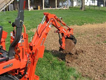

On the thumb I use, an easy twist if the top link adjusts the thumb to where it's needed and when I'm done with it a simple fold up and pin keeps it out of the way for digging. Very simple and easy to use.
I've not had need to adjust the thumb during operation once its set but then again I'm only useing it for simple home type usage. It would be interesting to see a hydraulic setup tho, and I'd say it would be handy, even if it is unnecessary.....
Oh and btw, my back hasn't been strained not once since I went with a BH & thumb to handle the heavy stuff :D :D
That Bro-Tec thumb should be a required purchase. The utility it adds to a BH is astounding and it is so darn simple. I would tend to agree...for the size of the BX, hydraulics seem a little excessive.
I would be very, very, very, very, very, very, very, very, very, very, very, very disappointed if for some odd reason it didn't fit the Woods BH6000. But where there's a will (read: hammer and welder), there's a way.
Nice rock, too. It's worth $300 just to pluck up a single rock like that JUST ONCE when you really need to...all the other years of use/abuse before and after would then be free!!!
