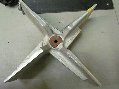

That impeller looks very primitive and I wonder if it was balanced, likely not which could explain the wear in the pillow blocks. With the square ends it must be very loud. How is the vibration in use?
Yes it does, and some ape has been in there before hammering on the impeller hub with a BFH. I couldn't find any evidence of balancing but the use of two 2 inch square head bolts in the hub may be an attempt - I'm going back using cup end set screws. I suspect this blower is a US made product of the '70's (one bearing seemed OK but the other was too loose in the housing). I'm speculating that it was also powered by an electric motor before since it had a multi-sheave pulley on it, and turned in the opposite direction. I have not run it yet, so we'll see.

Both of the side pieces have slots next to the openings on the outside which suggests there were sliding sheet metal pieces that regulated intake air flow. I'm not sure of the reasoning behind that. I'm going to cover the openings with expanded metal after I get it running. The red paint is not original, I sanded all the rust off and repainted for a smooth surface. The impeller is very similar in design to a Billy Goat debris blower.

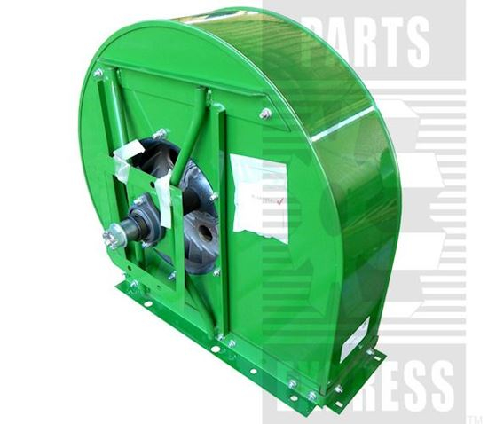

Can't find a photo of a AC stripper blower fan, but here is a pic of a John Deere fan.
