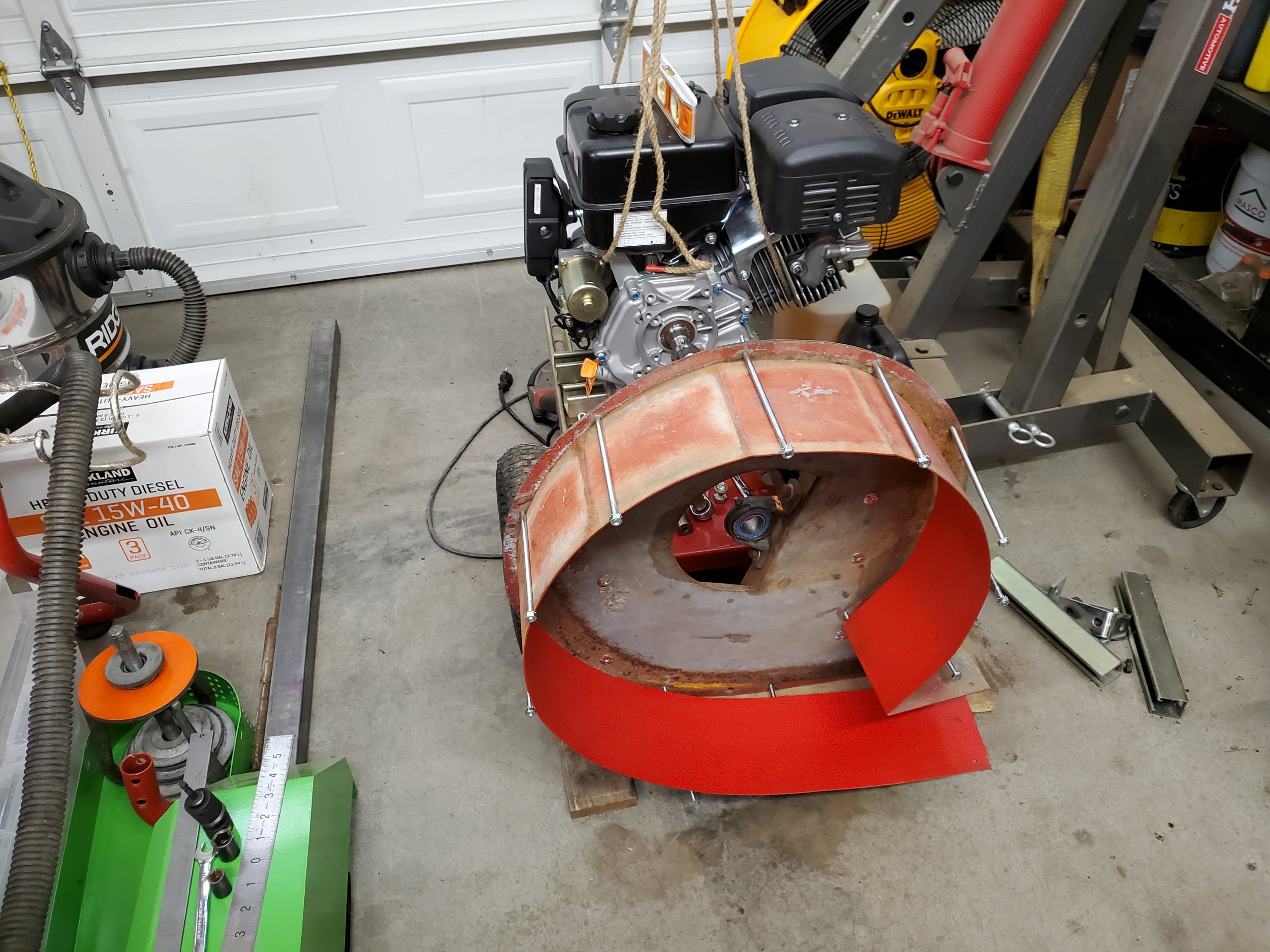

I saw this blower unit on CL for $25 so I jumped on it. I can't match it up to any of the known brands. I had a pressure washer cart and a 12HP Harbor Freight engine on hand so I decided to make a pull-behind leaf/debris blower. The unit has pillow bearings, four blade impeller, and a 1" shaft. It is about 30" in diameter. Any suggestions/advice is also welcome.

Yes, "someone" is me. That is a good looking unit you have there, but I dare say it appears much larger than mine.
/ Can anyone identify this blower?
Yes. A "before" picture might help some one recognize it easier.

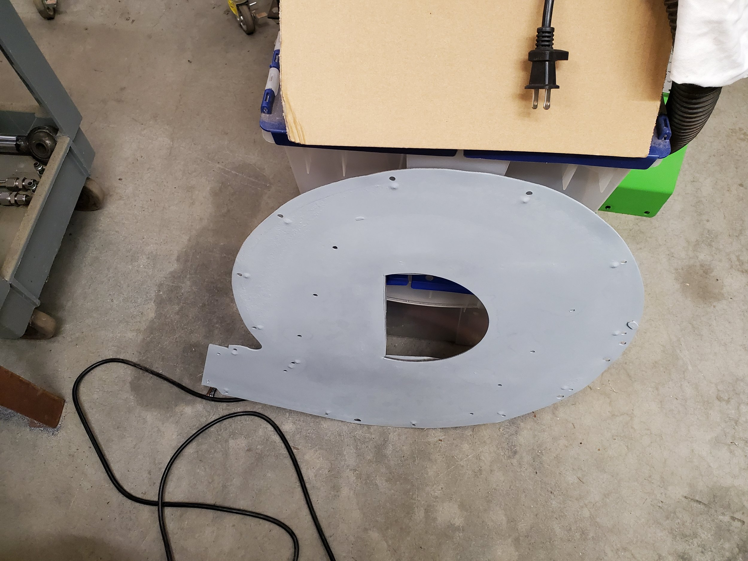

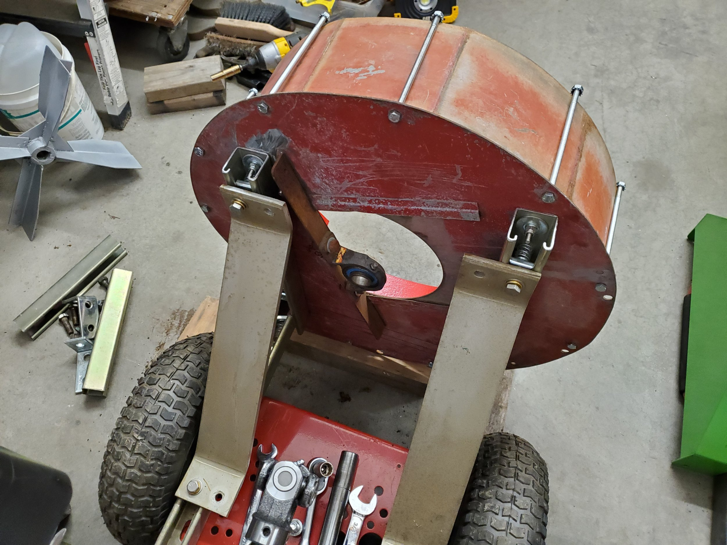

I did take a couple of pics after I bought the blower unit, but danged if I know what happened to them. All it had was a stepped pulley on one side, and there was no evidence of any mounting points. The sides were clean except for the pillow bearing mounts, which seem to be at an odd angle too. I used hurricane bolts to mount the Unistrut, which gave me some flexibility in mounting. I don't believe this is a home made unit. Currently waiting on new pillow bearings.

Thank you. I just took it all apart and cleaned it up. The pillow bearings were questionable so they are being replaced as well as the 20 1/4" bolts that hold it together. Using Unistrut as a mock up to see how well/if it performs. If it goes well then I may weld it all together. Stay tuned. :D

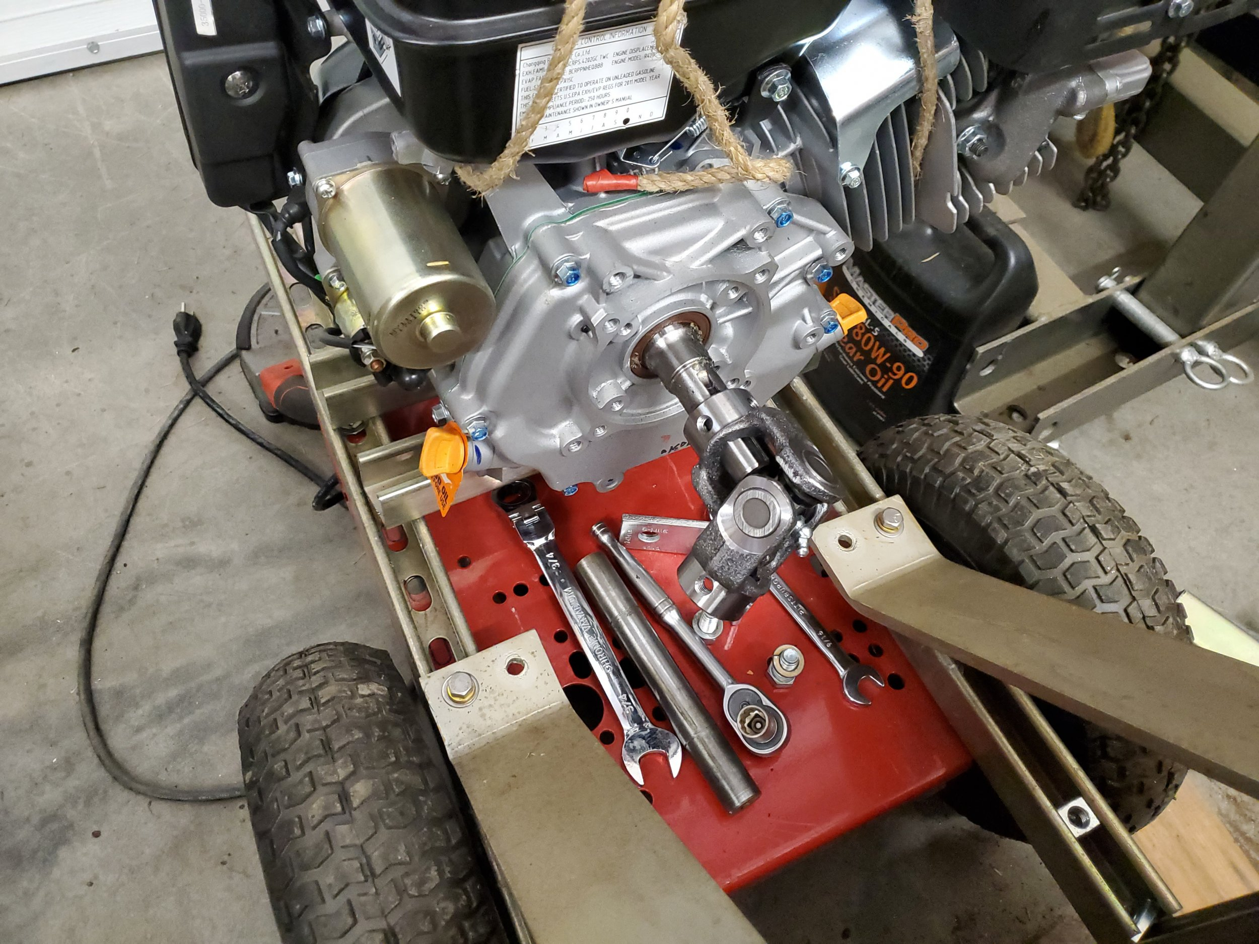

Also i would suggest that you use a coupler rather than a universal joint to connect the engine to the blower.

Also called "sidewalk bolts". They are stainless steel with full threads and a very low profile and large (truss) head (great for using on sheet metal instead of fender washers). I used these to maximize impeller blade clearance. Sidewalk Bolts Slotted Stainless Steel Hurricane Bolts 3/8"-16 x 1" Qty 25: Amazon.com: Industrial & Scientific
Originally I thought about using a Lovejoy coupling, but neither the crankshaft or blower shaft is long enough to permit close coupling, and I needed the engine moved back anyway so the cart will balance. So I'm using a jack shaft with two U-joints. And alignment won't be that critical either.

OK thanks for that info. I never heard of them and being SS, quite pricey.
And on the use of U-joints, just remember, they don't like to run straight, they need the shafts to be offset a little.
Richard
Yep. Make those needle bearings earn their keep. :ROFLMAO:

You should always research what you are talking about before you post. For best lasting use, there must be at least some angle on the u-joints.

Thank you for your concern Richard. I'm a Chief Engineer and have been doing shaft and coupling alignments for many years and am also schooled on the subject. I just thought in the interest of brevity I wouldn't go into details. My last ten-point alignment task was a 3 megawatt TEWAC alternator to a EMD 710-G diesel engine. That took a little while considering vibration isolators were involved.

That impeller looks very primitive and I wonder if it was balanced, likely not which could explain the wear in the pillow blocks. With the square ends it must be very loud. How is the vibration in use?
