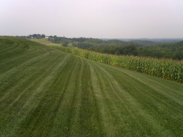

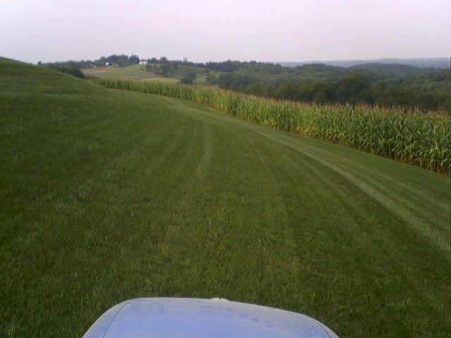

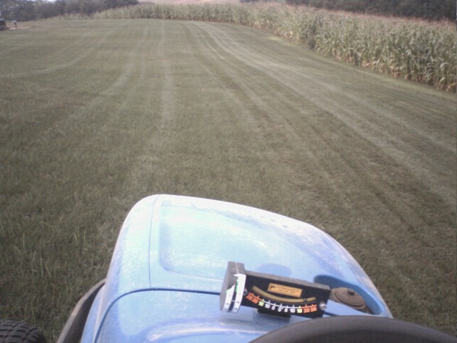

Suttles,
As has been pointed out very well, each tractor and land situation is different. That being said I can mow on slopes approaching 20 degrees going very, very, very slowly. It helps substantially that I know every dip and bump since this is a lawn I planted. I never attempt this in fields or land I am not familiar with. In those situations 15 degrees is the absolute maximum. See pic 1 below for an area near the bottom of a slope of about 15 deg. Pic 2 is a little further up at about 20 deg and pic 4 shows the tilt meter for reference running near the upper shot.
Before this summer I would not think about cutting across these slopes until a local farmer who has hundreds of times more experience cut our grass while we were gone. When I got home I felt he was nuts for trying this. They have a couple of big old Oliver's and two White tractors. The land down the slope gets a good bit steeper than this. After talking to him he convinced me that it was possible at the right angle across if done safely. If I do not approach it right I can feel it and back out. But done correctly it saves about 3/4 hour of mowing time and only feels a little concerning. I should also say what is obvious but I never mow/travel cross steep slopes when the ground is wet, the grass even damp from dew, or the ground very hard from no rain. All of these affect the ability to get lateral traction even the very dry and hard ground. Learned this the hard way and took a ride into the corn last summer..
I would STRONGLY suggest that you not try to get to this point unless you and your equipment are set up for this. I have a NH TC33DA with loaded (a little over 50%) Titan Multi-Trac C/S Turf Tires dished out and a mid mount mower that rides on spring suspension so it actually helps to lower the CG since the tractor carries it's 550# down really low. The Titan turfs have proved to give very good grip in out soft farm soil.
This combined with my big butt hugging the uphill fender makes for a fair slope mower. For those who feel that does not make a difference where you set, I contribute a little under 10% to the weight of the total machine/operator weight. So move 10% of the weight 10" moves the CG 1", etc. It may only be a little but looking at it the other way and let your but slide down against the down hill fender and the total difference is 2" on a 29" horizontal dist to the outside wheel (58" wide stance) with a 26”+ distance to the point of rotation and the movement is 8% +/-.

drm, from looking at your pics and reported angle of tilt it looks like my BX23 is well over 20 degrees in the pics I posted. I figured between 15 & 20.

Volfandt,
It would sure appear that way from your pics. If you want to know for sure grab a 4' level. Measure the fall in inches over the length of the 4 foot level and divide by 4 to get the pitch (__ /12). Then convert to degrees:
3/12 = 14.0 deg
4/12 = 18.4 deg
5/12 = 22.6 deg
6/12 = 26.5 deg
7/12 = 30.3 deg
8/12 = 33.7 deg
A buddy has a BX and claims it can not only traverse but turn on slopes steeper than I will dare go on sideways. Lots of the locals have them for their claimed low CG and ability on slopes.
Personally I do not like to mow across slopes greater than 15 degrees. But, I have typical western PA land (up/down/and around) and it has to get mowed. Just gives me more seat time. When I rode dirt bikes more frequently it seamed as though hills I would guess to be 30 degrees were straight up. After mowing my place (some slopes are up to 25 degrees) I would like to try those impossible hills again. They would probably look as daunting as ever and I am no longer daring enough to go all out. So I'll stick to tractor for the steep stuff and putting along with my boy for the gentle dirt bike rides.
