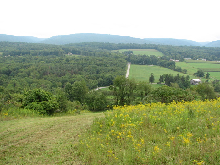

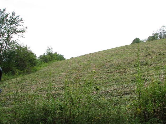

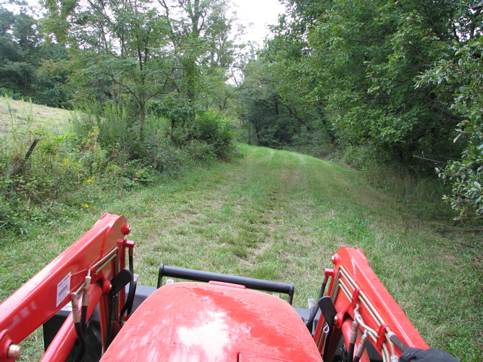

I've got three pictures attached here. On the two shots, "path" and "from_side", I tried to keep the camera as close to level as possible to give a good indication of the angle. "Path" is the path I take to travel to the top of my hill. "From_side" shows part of the hill that I'm climbing. My neighbor can mow nearly all of it with his older Masseys. They're very wide-set, more of an orchard style tractor. Me on my 1540, I'll probably only ever touch about half of the hilly areas. The rest of it is way beyond my pucker factor.
"Top_down" shows the view from about 4/5ths of the way up the hill. That's the roof of my barn visible down there to the far right. There's a lot of climb in not much distance!!

   / Can anyone post some pictures of hills #55
Is the hill in the first picture about 20*?
   / Can anyone post some pictures of hills #56
Jerry, can't say for sure. It's all one big hill, but it rolls and dips in various places, so there's anything from a couple degrees up to probably 40+ degrees depending on exactly where you are on the hill. But 20 is probably a fair guess for that particular spot.
