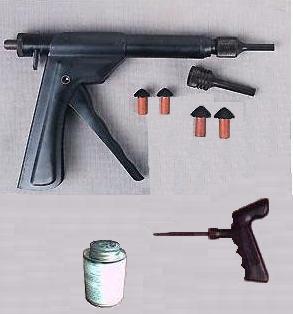

I had this tire repair kit on my Adv. motorcycle and figire it was a good time to familiarize myself with it in the comfort of my garage.
It uses a mushroom plug, has an installation tool, and the various reamers. You use the enclosed allen wrench to push the plug down the installer tube to push the plug though this tube that you insert into the hole. The head of the mushroom is on the inside of the tire, and the base of the mushoom head goes agaist the inside tire wall, so its actually positive air pressure that keeps the plug seated agaist the inside tire wall. I think there is also some glue to use as well. Once you have the plug installed you just cut off the excess. That was two years ago and still no leaks. I would recommend it to any that has had issue with other plugs. Here a picture of the kit I used.

I pick up one of these about twenty years ago. The hand lever makes it easy to push the plug through to the end. I have been out of plugs for a while.
