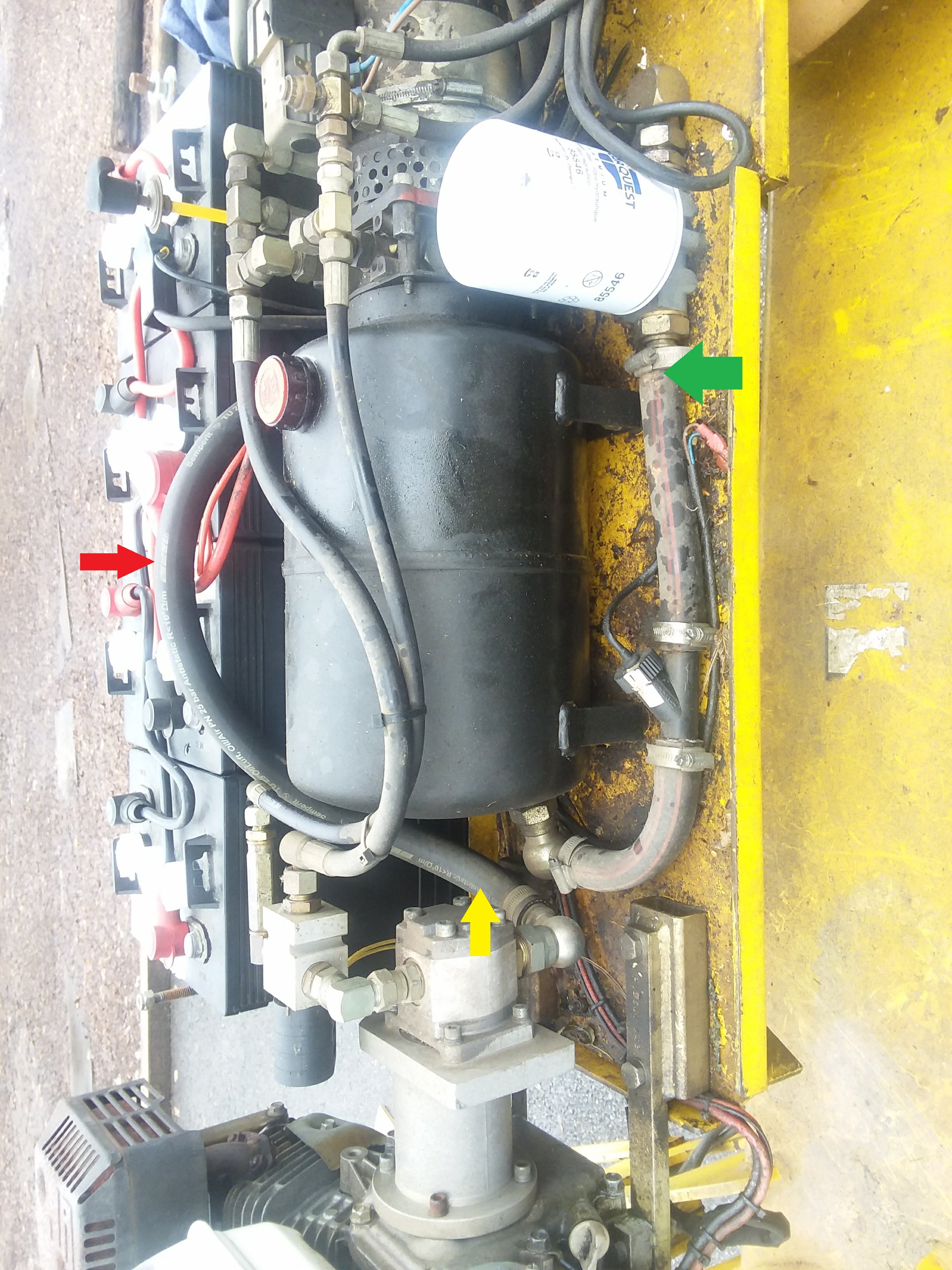

One more question, in this photo the yellow arrow points to the inlet on the gas driven pump. I'll pull that hose and connect a short piece of hose that I'll stick into a pail of new hydraulic fluid. The green arrow points to the hose that comes out of the bottom of the reservoir, goes into the white filter, and then turns back under the reservoir and pops up on the other side where the red arrow is pointing. My question is why did they run that hose up in the air where the red arrow is pointing? It would have been cleaner, easier and cheaper to keep it flat behind the reservoir and just plumb it straight into the spot where the yellow arrow is. Can that big loop up in the air serve any purpose?
   / Can I change hydraulic fluid like this #13
no reason I can think of to run the hose like that. Possibly not original hose and previous owner installed a piece of hose that he could find or guessed at the length

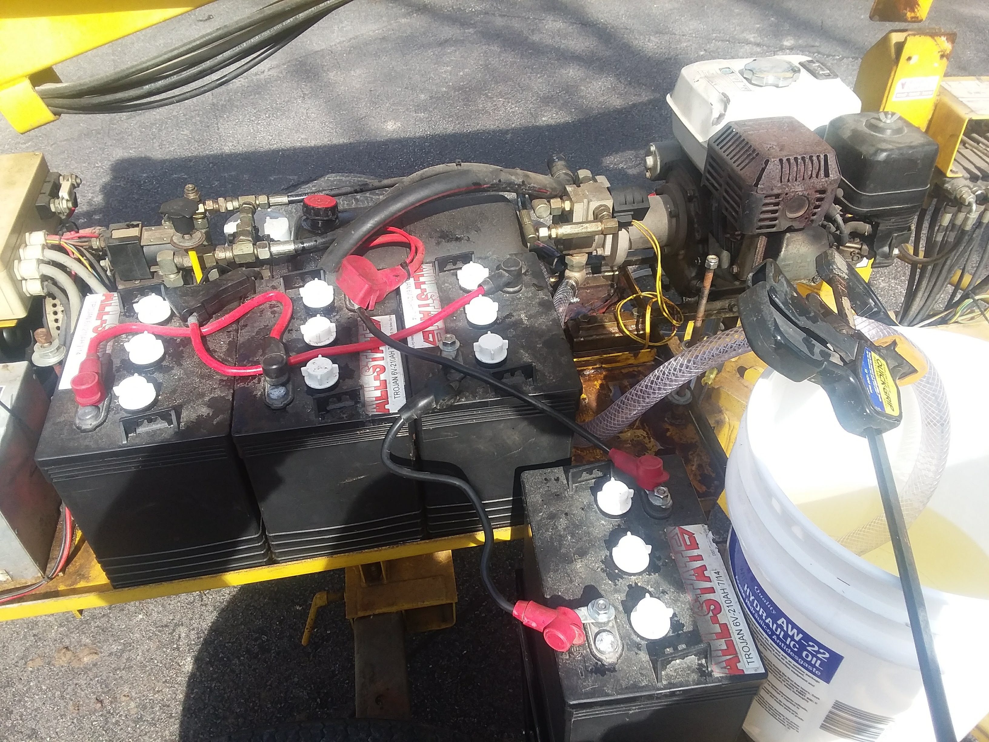

Another question, when I hook a length of hose up to the pump and put it in a pail of new fluid, that means there's about 3' of hose filled with air. Do I need to fill that hose length with fluid and keep it filled until I get the engine started? I was thinking I could hold the hose up like an elephant trunk, pour fluid in it, then hold some kind of plug lightly in the end while I put it in the pail. Then start the engine and remove the plug.
   / Can I change hydraulic fluid like this #19
Gear pump should self prime as long as the pressure port is open to tank.
#20
Mission accomplished. I found some cheap reinforced hose that was pretty flexible at Menards, had to remove one of the batteries to get at the suction fitting on the pump.
Here's the suction side of the pump drawing out of new pail of fluid:
Here's the drain from the reservoir:
And here it is with all cylinders extended:
