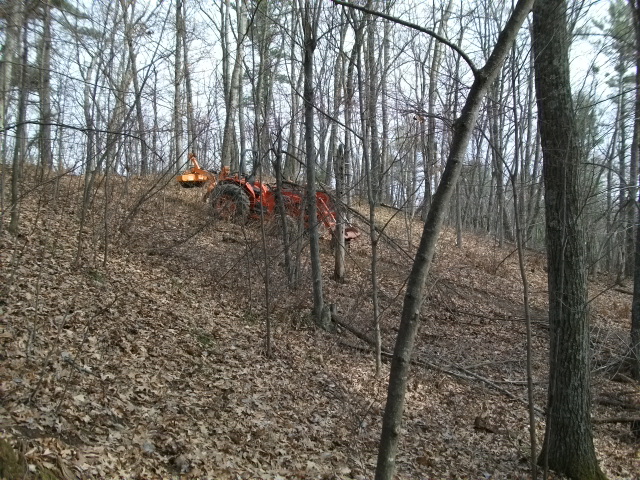

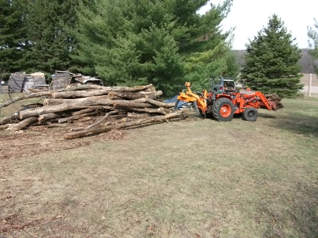

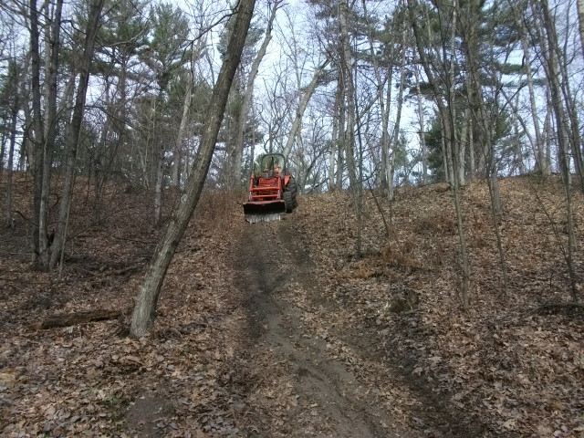

Drawing on some roofing experience I would have to agree, a 6/12 pitch roof (27.5 degrees)is about all one can do w/o roof jacks. After all physics is physics. I will say one thing though, when you are on your tractor with a load, that 30 degrees FEELS like 40!! Here are my pics, the crest of the hill has a steeper pitch than the rest of the slope and that is where I would normally have problems. Included one of the destination also.
