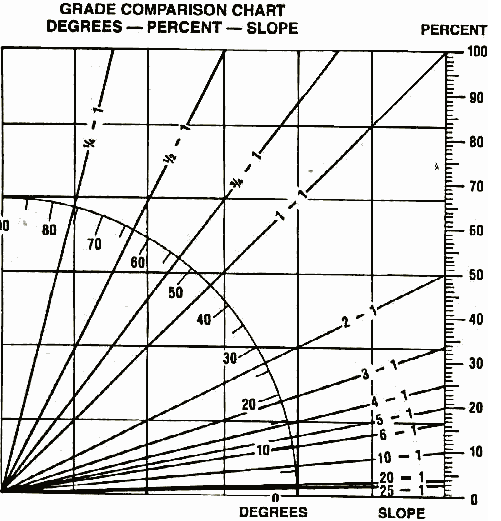

Here ya go.
Natural spill angle for a pile of dirt is 1.5:1, or 37 degrees (generally).
For your reference, a dozer will start to slide sideways at that angle. For your further reference, a dozer will climb up a 1:1 slope...perhaps slightly steeper....without a load. Less able to back up same slope.
Generally, it's really hard to gauge your slope accurately without measuring it. Unless you have an inclinometer/declinometer on your compass, I'm sure you can rig something up fairly easily to figure it out....a 4' level and the chart below would seem to be all you'd need. Use the 4' level to get the chart plumb (perhaps mounted to a board), then use the 4' as a straight edge and sight along it to a landmark at the top or bottom of the slope. Mark the position of the level on the chart. Voila.
Report back---we're dying to know!

Want to measure your tilt? If you've got an iPhone, there's an app for that. (Stanley Bostitch Level)

Drawing on some roofing experience I would have to agree, a 6/12 pitch roof (27.5 degrees)is about all one can do w/o roof jacks. After all physics is physics. I will say one thing though, when you are on your tractor with a load, that 30 degrees FEELS like 40!! Here are my pics, the crest of the hill has a steeper pitch than the rest of the slope and that is where I would normally have problems. Included one of the destination also.
I would think a 6/12 pitch is 22.5 degrees, a 12/12 pitch is 45 degrees.
pclausen
Both are difficult to work and can be very dangerous. Alot depends on the ground you are traversing and the real value of what you are attempting to do. Sometimes we have to get off the tractors and work on foot.
   / Can I descend a 40 degree hill on my 4700? #35
I would think a 6/12 pitch is 22.5 degrees, a 12/12 pitch is 45 degrees.pclausen.
A 5/12 pitch is 22.5 degrees, a 6/12 pitch is 26.5 degrees, sorry looked at my framing square w/o my glasses.
In any event while in the woods this AM I took my inclinometer w/me. Took readings up and down the hill in question with the instrument on the base of the roll bar which gave me a zero reading on level ground. Hill measured 20 degrees, but on the steeper portion measured 25 degrees. This is where I would experience problems with the front end coming off the ground with a real heavy log on the back. The grapple acts as a lever hence the heavier log giving me problems. Anything over 25 degrees I believe, at least for me, would raise the "pucker factor" exponentially. So, can you descend a 40 degree hill? Probably but it would not be for me. Ascend, with tractor? I would have my doubts. This has been a fun thread!

I'll get my 4' level and something to measure the angle with when I get home.

So I used these 3 instruments to meassure the inclination:
The angle where the 4700 was parked in those inital pics was 22 degrees.
I took about 10 meassurements from that position to the bottom of the hill, and they were all in the range of 30 - 36 degrees, generally getting steeper the further down I went.
So not quite the 40 degrees I guesstimated, but pretty darn close!
