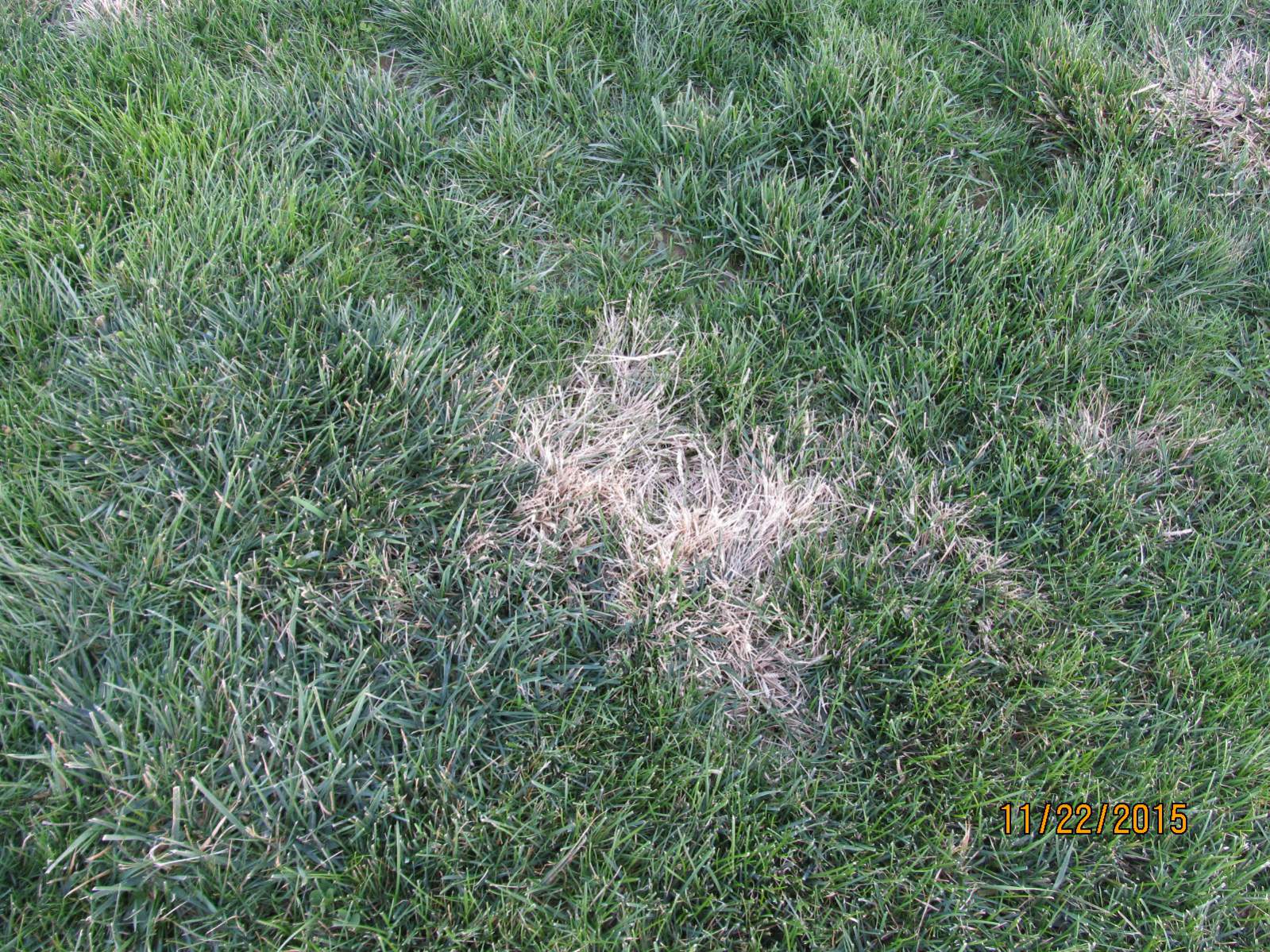

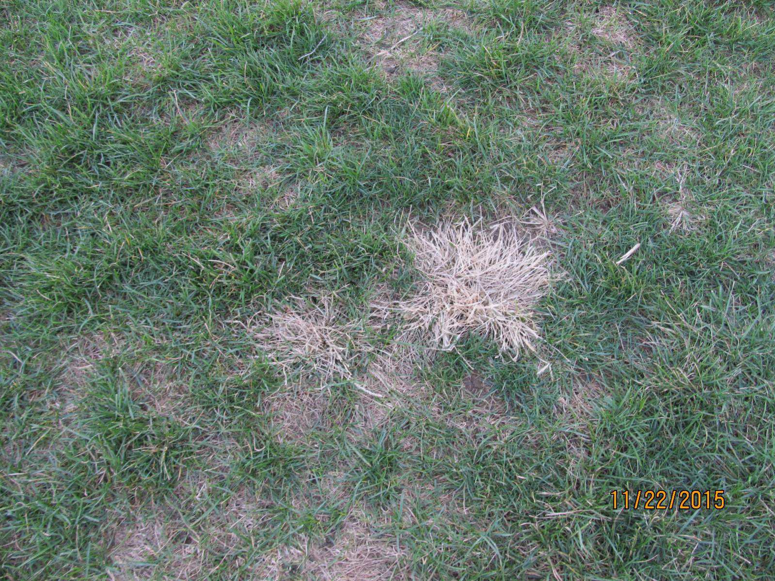

**Update on this from the OP. From the comments and suggestions made, I did my homework and used a new herbicide that appears to work on many annoying grassy weeds. It's called "Turf Herbicide" (credit to xring100) and is for grassy and broadleaf weeds. It worked for me but I've only used it for a month.
It has 2,4-D and Dicamba as well as Quinclorac and I little bit of Sulfentrazone. I know 2,4-D but no idea on the others. It kills nutsedge real well. That''s the spikey yellowish grassy weed that spreads underground and is very troublesome in lawns. It also killed some odd and wider bladed grassy stuff and KO'd quackgrass quickly. Some pictures are below. See how the weed died and the surrounding grass lived? That's what I was looking for.
