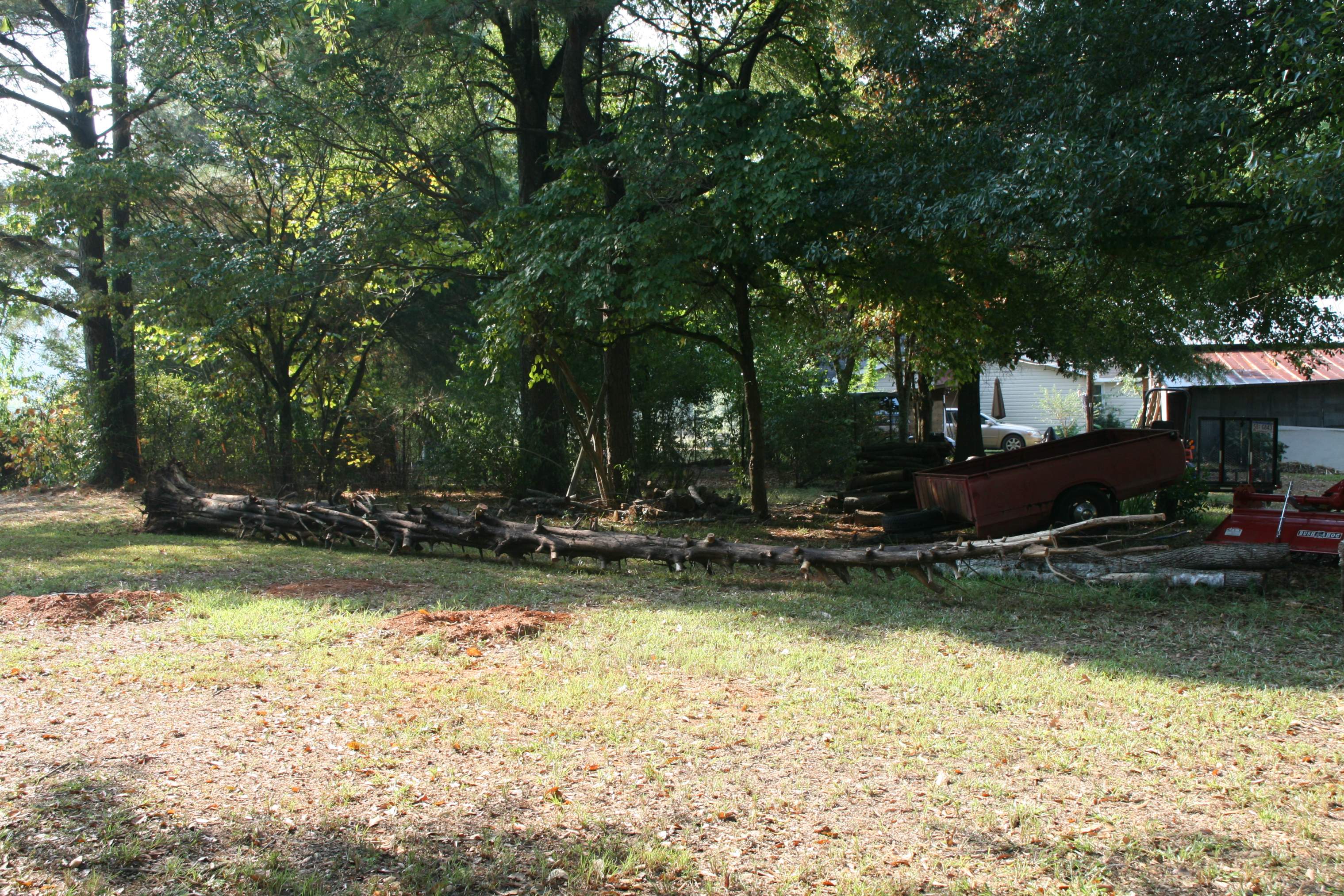

Yes - had some weight (box blade), but not near enough. When doing serious grapple work, I most always have my rotary cutter hanging on the back. In tight places, where extended length will cause problems, I'll go to my big rotary tiller. On this particular day, I had dropped my RC to do some BB work. My thinking was, it's a cedar - shouldn't be too heavy. Just didn't figure the weight of that clay packed root ball. Pressure washed that thing and, besides the clay, it was also packed with fist sized rocks.
Guess I could breakout some old texts and figure the physics of my error, but to what end. Bottom line - alignments were wrong and tractor mass (distribution) was inadequate for this job.
With this episode filed away, been thinking - what can I do to make such work safer? Outriggers ("training wheels") might have helped. How about the boom-less end of a backhoe attachment? Could I rig a way to attach my K5 (thru trailer hitch) to the 3-pt on my tractor? For the time being, if faced with similar circumstance, will either chain the rear-end of tractor down low on some adjacent trees or go do something else.
