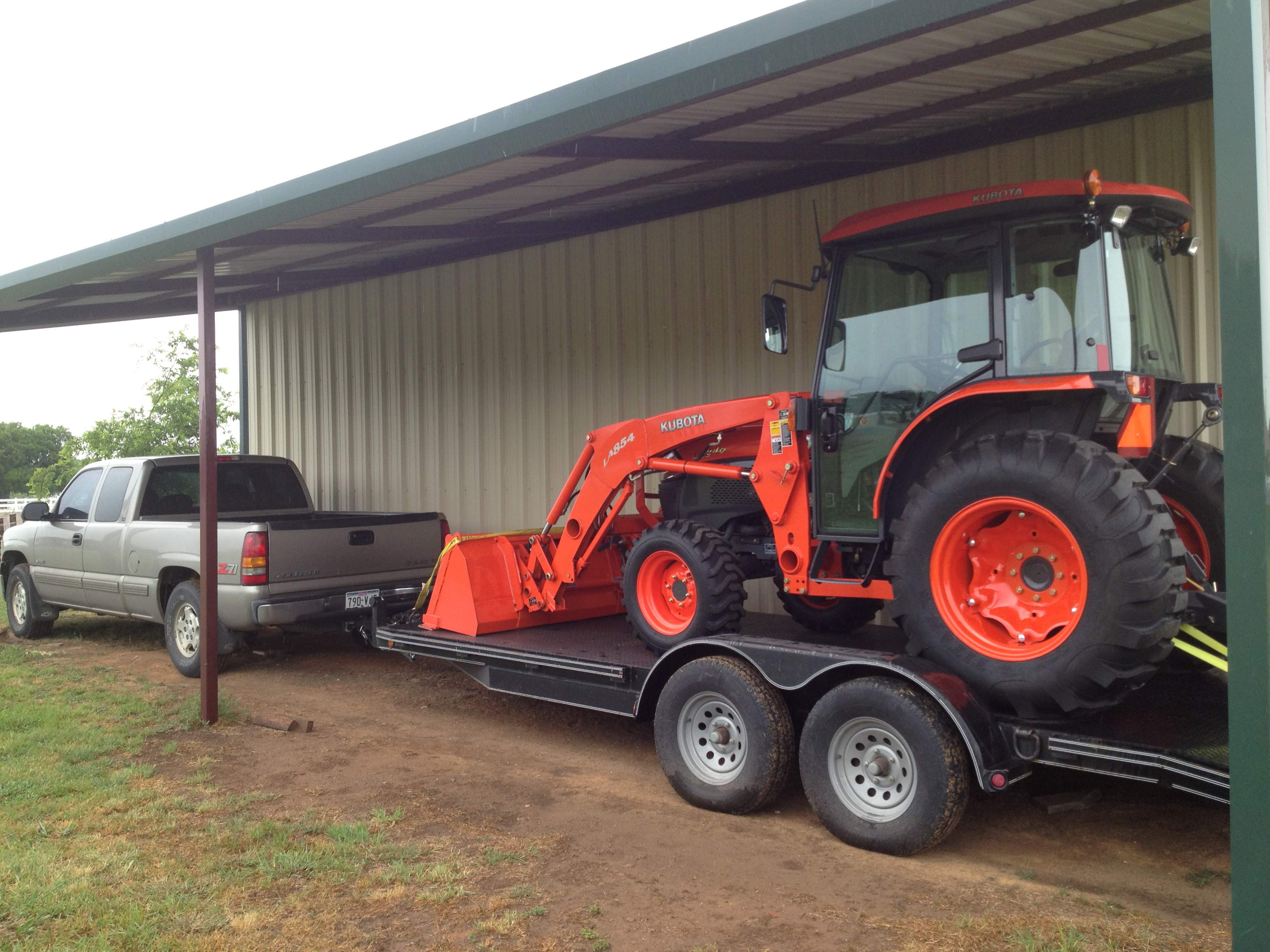

What kind of trailer? You have to add that weight as well. Is this a 1 time deal or will you be doing it regularly?
You can do it, but I think the wiser question to ask is should you?
I could do this, but I shouldn't have and will never do it again. Luckily nothing bad happened and I got caught up in rushing out and picking up my new/used tractor and grossly underestimated the wight. Got it home and started looking adding up the weight (loaded tires, FEL, HD Bucket, CAB) before I drug it out to the land and realized I over taxed the trailer by around 4k lbs!! :shocked:
Weight distributing hitch + Good trailer brake helped but I'll be borrowing my BIL's Megacab CTD and HD trailer from now on.
