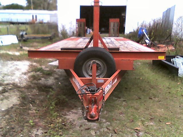

George, my trailer has a little (business card size) MFG metal sticker about weight etc and serial # I will try and show picture of it.. Got it !! just in front of spare and to the right of tongue jack facing front, can you see it?
   / Can I legally tow a 20,000 lb. trailer with my F-450? #174
It says right on the little tag, 14K pounds
   / Can I legally tow a 20,000 lb. trailer with my F-450? #175
Yes, I see it. Mine have tags (1 is metal, 1 is a decal) which have the ser. # and maximum cap. As I said I have been told by both trailer mfgs. that I must subtract the trailer weight from the max cap. number to get the actual weight I can haul. Its too dark here to get a pic of mine right now. I think if you call the mfg. they will tell you the same thing I was told.
Some do and some don't. Usually the number stamped on the metal tag is the GVWR which is the sum total of the empty weight of the trailer + the cargo weight.
So a 14K trailer that weighs 3K has an 11K cargo capacity.
Some bigger trailers will say "10 TON" on a decal on the frame rail meaning they might have a cargo capacity of 20,000lbs + the empty weight of the trailer.
It's all done to confuse owners and make it easier for law enforcement to catch you doing something wrong.

Builder, I agree, that is how trailers are sold in this part of the country as you said. The total weight of the empty trailer and load = the GVWR Max capacity. I obtained my CDL many years ago so I've never had to worry about this problem. I think Gamma's answer will have to be determined by the state he lives in since apparently other states have different rules.
