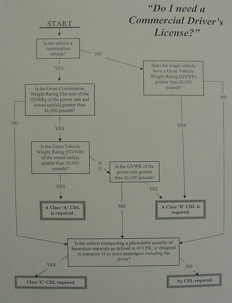

   / Can I legally tow a 20,000 lb. trailer with my F-450? #163

Please take a look at the following photo, it is a flow chart which answers the question: "Do I need a Commericial Driver's License?"
   / Can I legally tow a 20,000 lb. trailer with my F-450? #164
Good chart but are they going by sticker gvwr or registered gvwr weight. Big difference
My truck is 17,500 and trailer is 14,000 = CDL
Registered weight of truck 10,000 and trailer is 14,000 = Legal
   / Can I legally tow a 20,000 lb. trailer with my F-450? #165
Could be whichever is higher!!!!! That's why you need to read your CDL manual and call your state's DOT dept and ask them!!
They're open today! ;)
My understanding is it goes by the REGISTERED weight. That's what you paid for and how you are declaring you'll use your truck.
   / Can I legally tow a 20,000 lb. trailer with my F-450? #166
Going off of what Builder said, Each state is different. So, you really do need to find out. But, caution is needed. I went to the DMV with questions and they gave me this
Sure looks like I need a set of USDOT numbers. In fact every one behind the counter emphatically stated I was REQUIRED to get them. I called the number and they also stated that I needed the USDOT's. BUT - after a 2 1/2 hour visit to the local trooper station, calls to the weigh station where each officer gave different answers and then the trooper had to call the state headquarters -finally an answer backed by reference to the published laws! No USDOT needed for farm plates and farm trailer plates. I even have 2 different pieces of legislation dealing with it to back up my lack of USDOT# and educate the man in blue. Should the need ever come about.
Not the exact deal with your question, but it shows this is no push over topic and even the experts and enforcement officers have a hard time keeping up with the ever changing laws.
Again on your flow chart - it states if the GCWR is over 26,001# and defines GCVR as the sum of GVWR (Gross Vehicle Weight Rating -> that's the sticker number -NOT the registered weight for the truck and trailer). You are into CDL area. But as Builder also stated - check with the experts, or just get a CDL.
