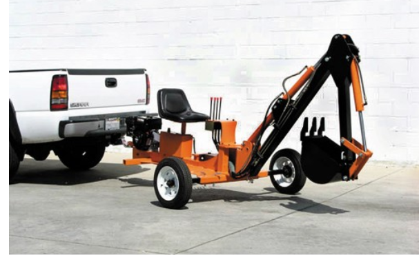

I would not try to put a backhoe on my tractor. I'd get a mini-backhoe that I can tow or leave in place - where it moves on its own power.
Here is a link.
Towable Backhoe - Jansen USA
