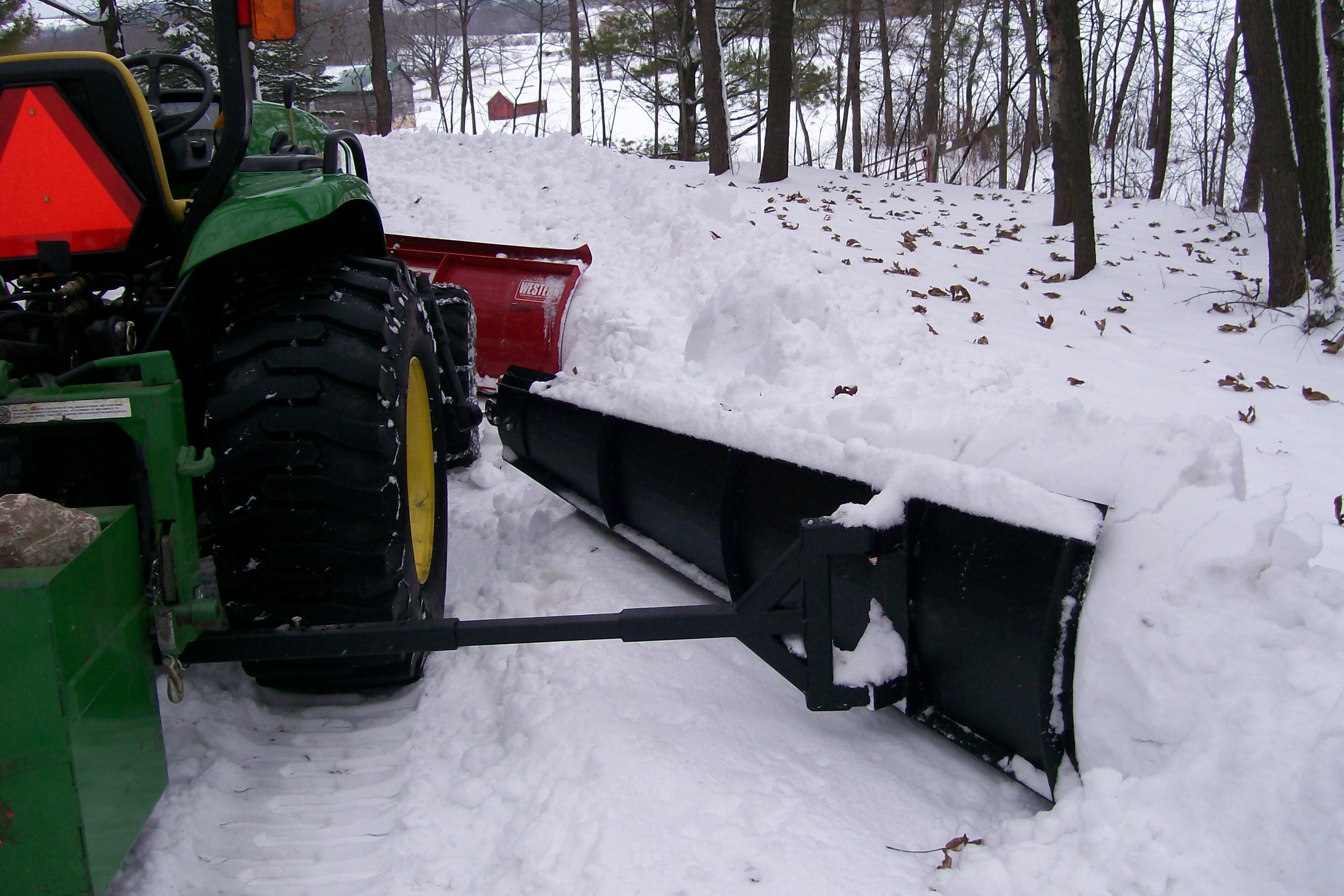

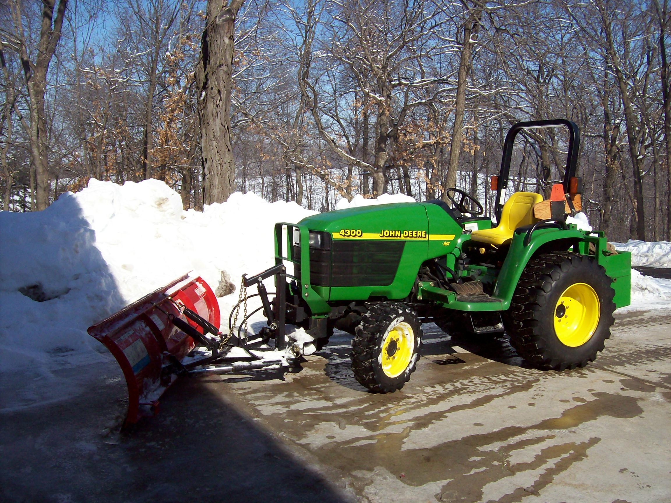

Agree about having to use a bucket to clear snow, a bummer and no fun at all (for me).
It's why I mount a 7' Western plow and move snow quickly. Even piles up snow as the front tires will ride up on the plowed snow. No problem plugging the front grill up with packed snow.
Our recent two snow storms and now some drifting, almost has me ready to mount the wing plow to move snow back.
