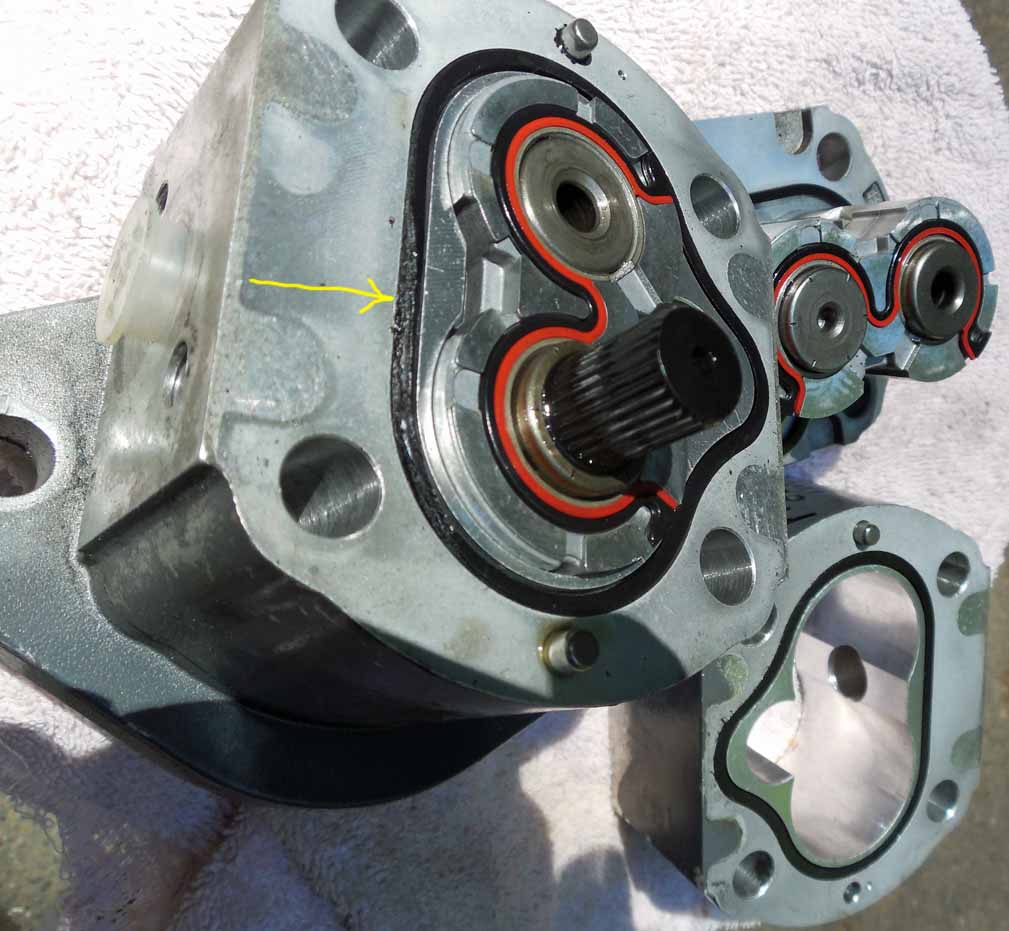

It is not hard to do, if you can get a rebuild kit. The seals are very special, and specific to the
make of the pump. The brand, at least, of the pump is usually on the casting. Have you
researched it?
Here is a Cassappa pump that I did for a Kioti. It is still working, last I heard. Kioti
changed their brand of pumps to Joyang, but only sells the rebuild kit for the Cassappa,
resulting in a Big Hassle.

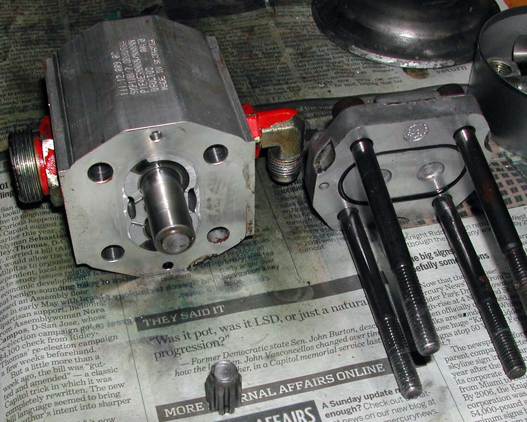

   / Can I rebuild the hydraulic pump for a Mitsubishi MT 372 D/Satoh 370 Beaver #3
If your pump looks like this one I'd buy a new one off Ebay I think I paid around $280. The shaft broke on mine and dealer wanted $1,200.

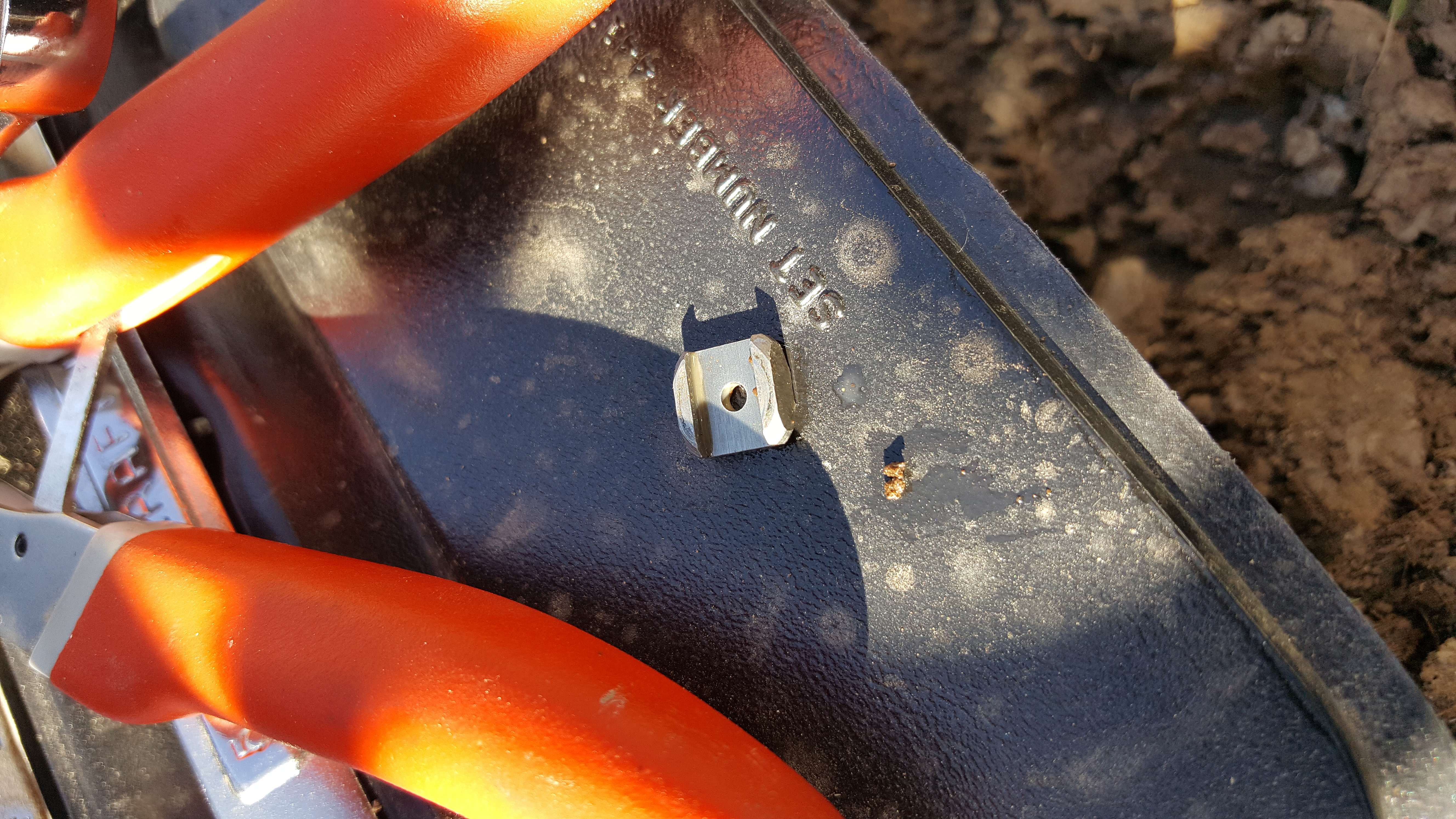

So I lose hydraulic pressure to raise my bucket whether it's empty or loaded. I seem to have pressure for my bucket tilt. I change lines at the control box and the last line I go to change, which happens to be the bucket lift line, this little square metal thing falls out. I'm pretty sure nothing came out of the other lines. What is it? 1491346323830-1684111086.jpg
   / Can I rebuild the hydraulic pump for a Mitsubishi MT 372 D/Satoh 370 Beaver #8
It may be a flow re-stricter to cushion lower the loader. I've never seen one in that location before but then I haven't seen that many.
#9
Billrog;
Oh yeah that's exactly what it is. After I swapped my hydraulic lines to the different valves I lifted the bucket but when I hit the down, holy cow did it go down quick. Thanks for the help.
