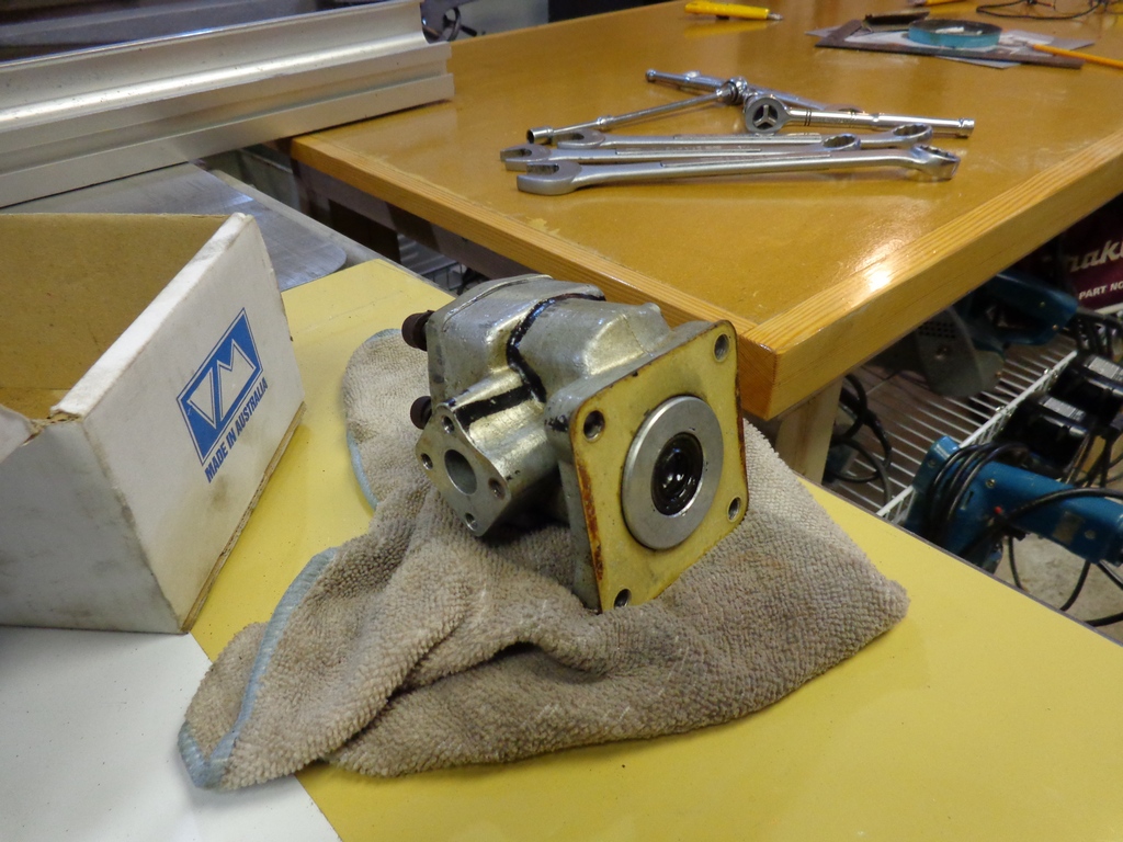

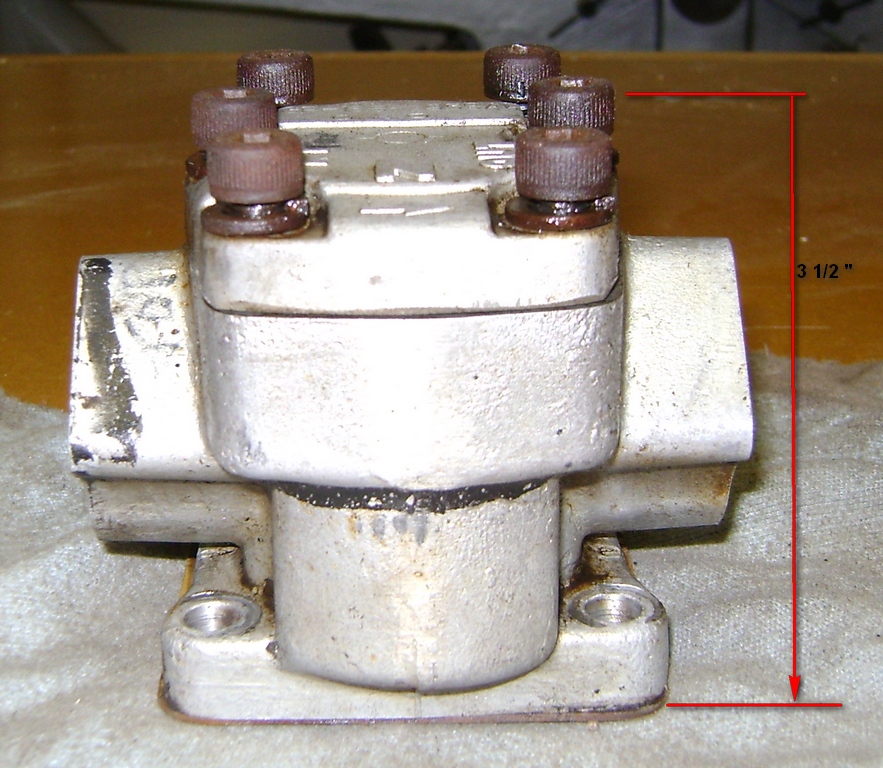

View attachment 504601View attachment 504602
If your pump looks like this one I'd buy a new one off Ebay I think I paid around $280. The shaft broke on mine and dealer wanted $1,200.
How easy or hard was it to change your pump? My replacement will be arriving today and was wondering what is involved to exchange the pumps.
Thanks for the assistance.

I got the used pump today and it's a little dirty on the outside (expected), no biggie. Can I completely open the pump and inspect it, or will I need to buy new seals once I crack it? I would like to look inside of it before installing it.
   / Can I rebuild the hydraulic pump for a Mitsubishi MT 372 D/Satoh 370 Beaver #16
You could open it without needing to replace seals but I'd recommend not. The "little dirty on the outside" can wind up being a little dirty on the inside and precision mechanical components do not bode well with even small amounts of dirt being introduced, especially hydraulic pumps and motors which dirt is the #1 enemy of. The risk to reward wouldn't be there in my opinion. Try it out as-is and see if anything has changed.
