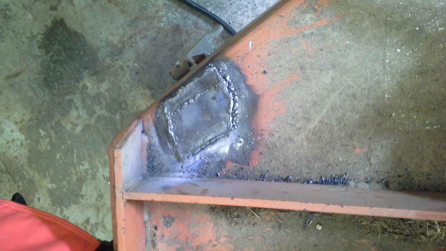

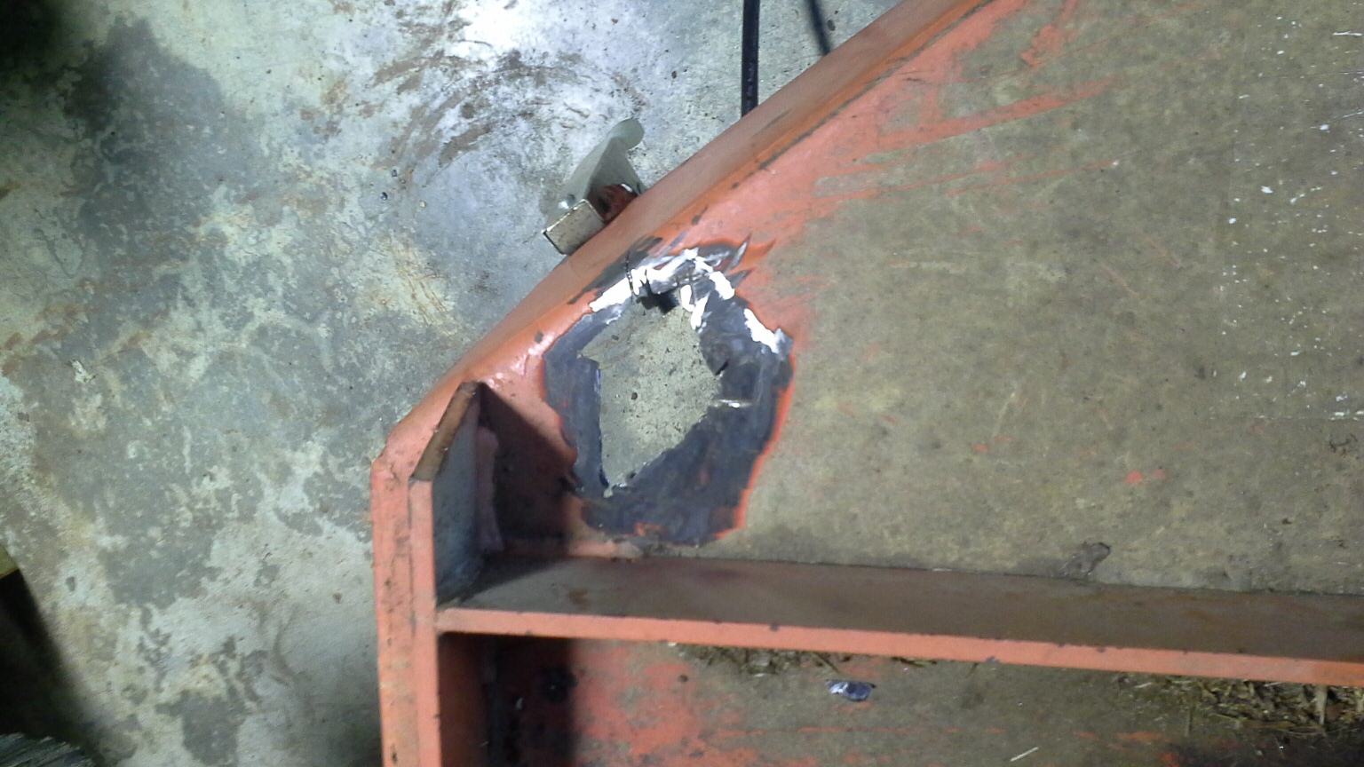

I used 10 gauge to patch a hole in my brush hog.
I know it looks like bird poo, but it held after I patched a couple of holes.
I gave it the hammer test, then used it for an hour or so.
But that was my first weld w/ my $265 PA 300, I had to run it at about 28 amps w/ 1/16 rod and I still blew holes.
A mig would have been more appropriate.
/edit - I could not imagine hogging with a bush hog with 20 gauge metal on the deck, my rocks would fly right through it.
