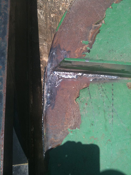

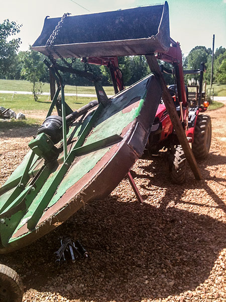

Why pay $80 an hour? He likely has a minimum charge of 1 hour even if the pro is only there 10 minutes. Those patches you need to add are not structural in nature at all. Based on what I can see in the pics even less than ideal welds will hold perfectly fine. Preventing burn through is your biggest hurdle which should be reasonably easy on 16 gauge (or thicker metal) with stick. Less than 16 gauge is asking too much though of the stick process (but still doable with a backer plate of copper with care).
5/64" 6013 with electrode negative would be my first choice (or AC polarity if that is all you have). 5/64" are hard to find but do not flex all over like a 1/16 diameter will so I love em for applications when mig is unavailable. It is worth having a pound of these around.
1/16" 7014 would be my 2nd choice (I mostly hate all 1/16" diameter rods but 7014 runs so darned easy it makes this one 1/16 diameter rod tolerable). Again worth stocking a pound of these.
3/32" 6010 or 6011 would be my 3rd choice. Move real fast and jump around to utilize the fast freeze properties or you will burn through with that forceful arc of either.
3/32" 6013 electrode negative would be my 4th choice.
In short I would trial and error any of these 4 in my bags of tricks and see which worked best and make the best of it. Do not expect prettiness but functionality. Frankly that ole cutter is not pretty anyhow in its current condition.
With the way you have that bush hog hanging you can even get to the patches from both sides so use that to your advantage too. Weld from both sides or to use a scrap of copper as a backing plate which will help prevent burn through too.
Personally, I would not use 7018 on this thin of stuff as even 3/32" 7018 diameter will burn through the thin sheet metal much too easily imop.

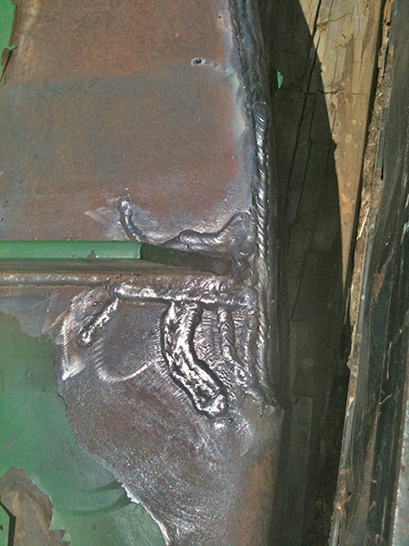

I repaired this bush hog for a guy I used to work with, You can see the patch on the side in the 1st pic and some of the welding where I had to weld up cracks and some small holes in the unit. All of this was welded with 1/8" dia. 7018 rods. with a Miller Synchrowave 200.

Nice work on the JD cutter repair, but that appears to be a heck of a lot thicker metal (3/16" thick or more) than the OP is trying to repair. No reason 7018 would not work fine on 3/16" thick metal without burn through.

That's a very good idea. I found a guy that will come here for $80/hr, has all the mig stuff on his truck. I doubt it would take him an hour to do this if I get everything prepped.

The unit metal was just a little thinner than 1/8".....like about 12 gauge. I used 1/8" plate for the patch on the bush hog.

Thanks, I planned to do some tests once I cut an old piece out and can weld it to the patch material. Haven't used 7014, I'll get some and give it a try, storing 7018 is a pain. I've got a good bit of experience with 6013 too, so I'll see how that works. Yeah having it hanging up in the air makes it easy to work on, I'll probably cut out the bad areas with it hanging, then lay it down so I can weld in position.
