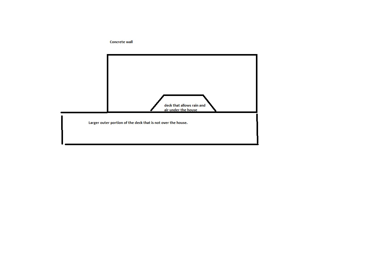

Milton, I'm not sure I understand the problem or the area in which you have to work. Your deck looks raised well above ground level behind your stairs. Unless there are things I cannot see there, I'm really confused. Are your deck joists not supported by a ledger board up against your house? I'd love to see a picture of the problem area.
I realize that I have not presented a clear picture of the problem area. I will try to draw it out, and will get better pictures. Indeed the outer portion of the porch is high off the ground, but the lot slopes steadily and the actual area under the house is close to the ground. There is partial standing space that narrows to just crawl space.
EDIT: I have tried to add a crude drawing, showing the area giving me the problem. Most of the deck is outside the house.

It is hard to visualize and I think some of us are misunderstanding the setting. As I get it, the additions were set on a footing with a short block wall that created a crawl space. The covered recessed/raised area of the deck is over that crawl space. That allows some water and a good bit of air flow to come through the lower level of the house. Am I on track here Lakngulr???

Yes, Mark, you are spot on. Perhaps this picture with my grandson Jack will help a bit. The area under him and to the right of the swing is the problem area, the deck to the left of the swing is ok. The concrete footing wall is probably right under his bottom.
