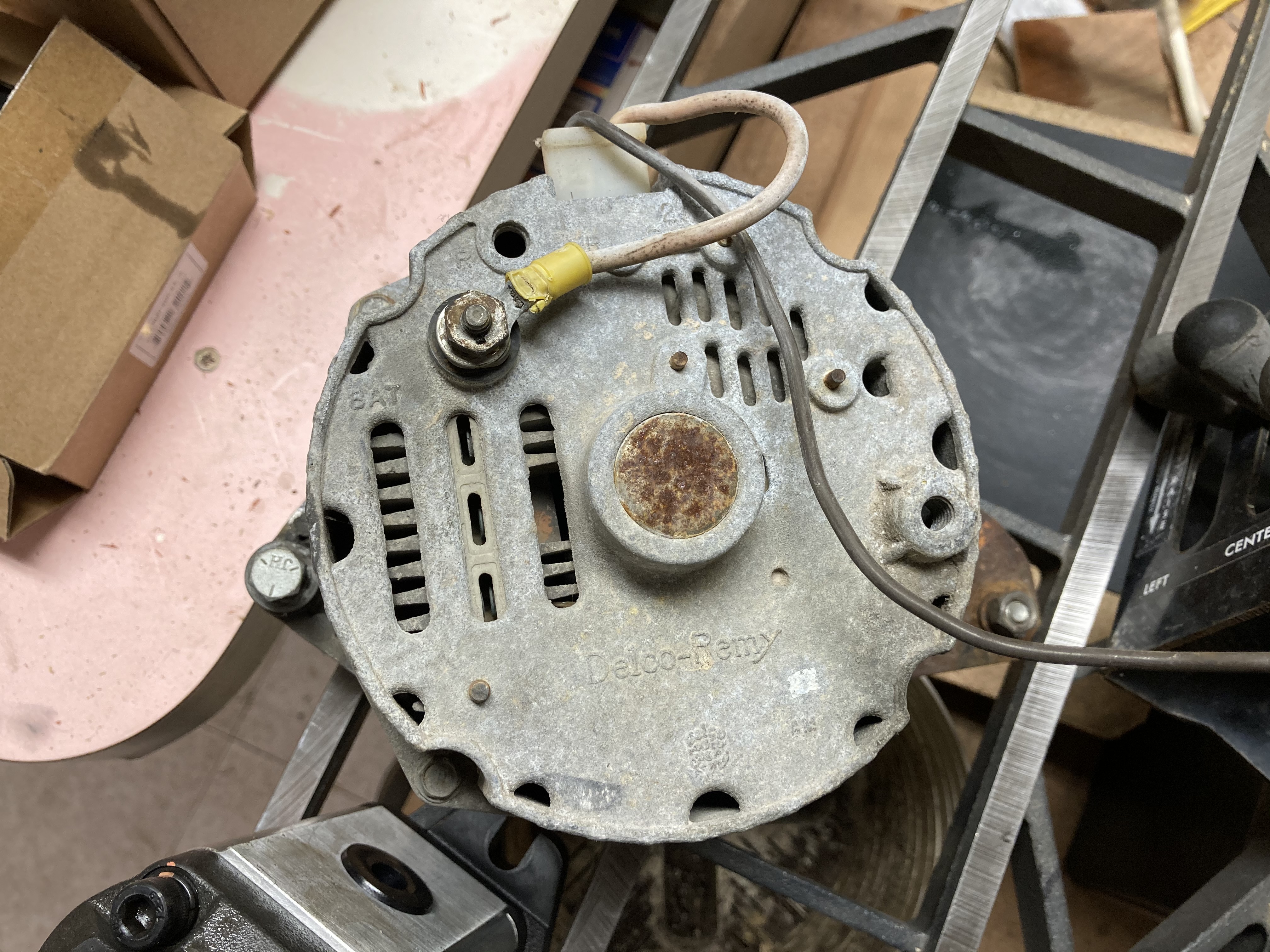

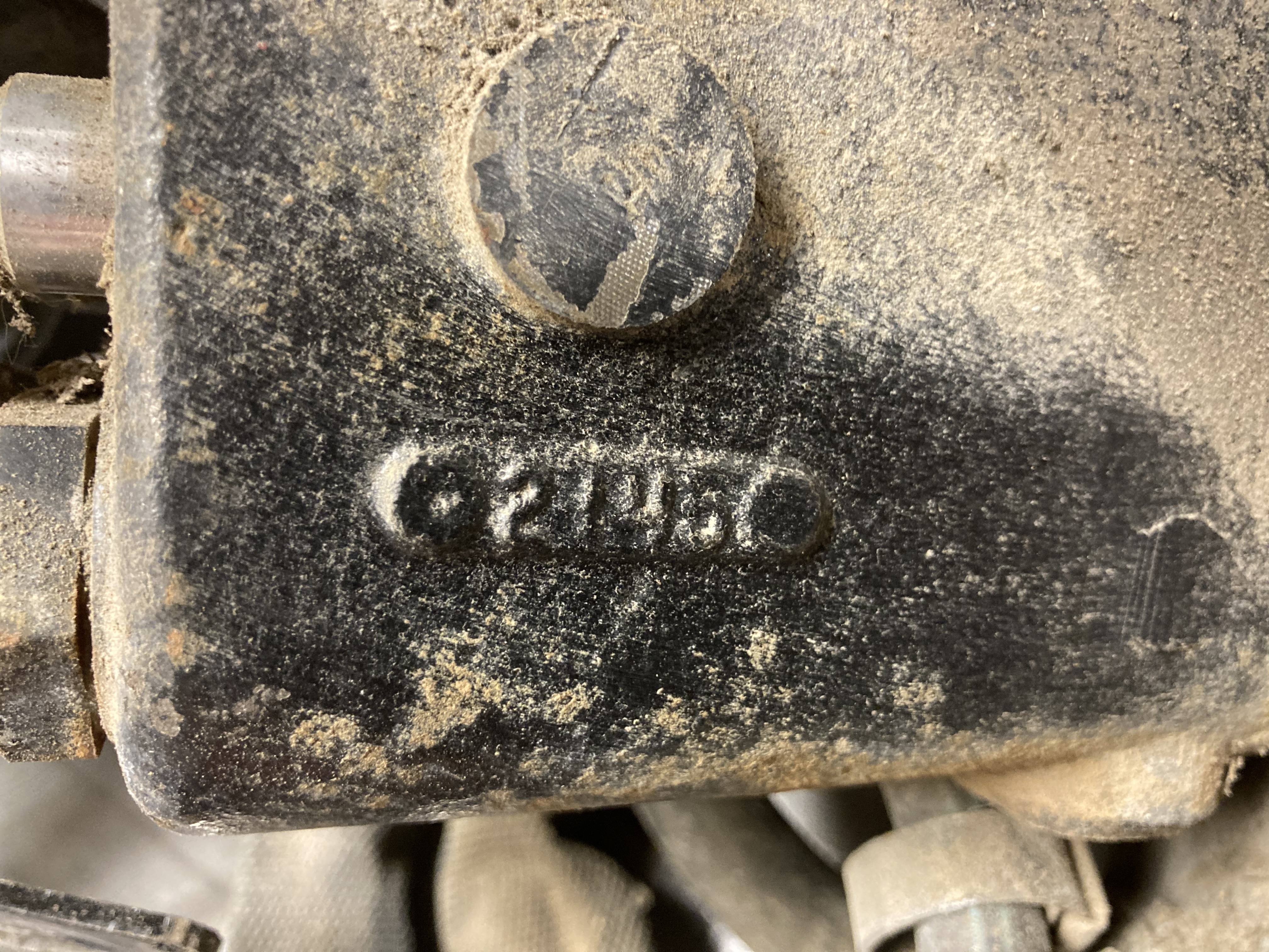

I made some time last night to putter with the Terratrac hydraulics some more. I took a bunch of measurements and did a bunch of figuring. I also pulled the alternator out so that I can figure out a way to fit both the hydraulic pump and the alternator in the space where the alternator used to be.
First of all some detail about the valve. The first two attached pictures are of the numbers I found on the bottom of the valve. I didn't see any brand name like Prince or Vickers. If these numbers mean anything to anyone please chime in. The main thing I need to determine is if this valve will handle the 10 gpm max flow of my new pump. If it helps the discussion, the hoses coming off the valve have a measured I.D. of 0.269". The OD of the rigid section is 0.382", and the O.D. of the rubber part is 0.685".
Next are the cylinders. I let the loader bucket all the way down (loosened a fitting and drained some fluid). The pin to pin distance of the lowered cylinder is 44", and the existing cylinder still has 4.5" of travel left before it is completely retracted. I'm debating between a 32" cylinder stroke and a 34" cylinder stroke. The retracted lengths are 40" and 42" respectively. The shorter stroke gives me an extra 7" of downward travel past level at the bucket and a 7 foot dump height. The longer stroke gives me 3.5" of extra downward travel and an 8 foot + dump height. In my little brain the dump height is much more valuable than the extra few inches of downward travel, but that's why I post here... for different opinions. Are there reasons why one might want that extra few inches of downward travel?
I also measured my cylinder O.D. at 3.016". I still need to look up specs to see if that correlates to a 2" cylinder or 2.5" cylinder.
The last question isn't exactly hydraulic related, but there's a stray wire on my Delco-Remy alternator. In the last attached picture there is a white wire that the positive terminal (to battery) was connected to. Then there's the black wire that wasn't connected to anything. What is it? Should I connect it to something?

I think I may have answered my own question about the hose size. I found a calculator on Surplus Center
It gives the formula Q = 2.45 X D squared X V where Q is GPM, D is the hose diameter, and V is the velocity. The recommended velocities are also listed on the same page. At max flow I actually need a 3/4" hose to stay at the minimum recommended velocity. I think I may be able to get away with 1/2" for the hoses to the cylinders, but I'd better be a little bigger for the pressure line coming into the valve.
The bottom line is that my valve is likely too small. The good news is that I have a bigger valve on my massey 1215 tractor. It only puts out about 2.2 gpm. I may be able to swap the valves. It may be good to have a third function on my tractor loader anyway. Stay tuned.
