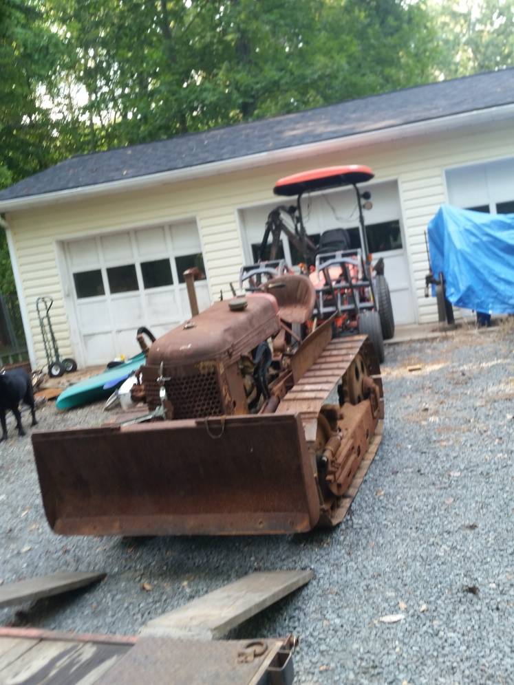

Thats a cool little crawler, I have a Oliver OC3 that I one day hope to restore.
On mine the hyd. pump is driven directly off the front of the crank, not sure if you'd be able to do that on yours. Mine has a heavy duty grill that allows a little more room for the pump.
First of all, tell me more about your crawler... year? make? model? history as you know it? I assume everything runs well?
The original configuration on my crawler was also to drive the pump directly off the crank. Whatever coupler may have existed is no longer there, and some of the old bolts are sheared off in the holes of the crank pulley. I maybe could have put more thought into it before I bought a clockwise pump, but I'm committed now. I still think that a belt driven pump will be the right answer. I opened the UPS package yesterday and it looks like there is a race on the pump housing to put an outboard bearing if I can find one with a 14mm ID and a 24mm OD. I'm planning a trip to my local bearing shop today.
Does anyone have any more thoughts about the cheap eBay cylinders? That sure seems like the answer to my single acting cylinder problem unless these are known to have recurring problems.

I also should mention that I got the valve pulled out of the reel mower last night. Here is a picture of it sitting on the track of the crawler. It just kind of looks like a dead squid right now.

I think the quality of the cylinders will be fine for your application, you wont put a lot of hours on that thing. But I think you need a larger bore you wont have near enough lifting power with a 2” bore. Them are sized for a garden mower. Get the double acting, you wont be sorry.

I kind of struck out at the bearing place. The only bearings that they had of the right size were not sealed. They wouldn't last. I'm wondering if I'll end up with a bearing on the mounting plate and a shaft extension running back to the pump.

You don't want to block the unused port in the valve, the pump would go over pressure relief every time you operated the valve in that direction. Plumb the unused port on the valve to tank, that way when you're moving the valve in that direction, the oil is just going thru the valve, out the extra valve port and right back to tank. Not the most efficient way to use a valve but you've got to use what you've got.
Put a filter of some sort on the unused port on the cylinder to keep dirt out, a rear end vent for example......Mike
What model mower is that out of? I have a couple of Jacobson reel mowers for parts, if any of those valves are for the reel motors then they most likely won't work for the cylinders since they are open in neutral to allow the motors to spin down on their own.
Its a 1952 Oliver OC3, 42in track with an A.C. Anderson blade. I don't know much of its history, was bought from someone that was helping a widow sell off her late husband's equipment. Appears he was working on restoring it as there was a few peices that have been replaced.
I did get it running and drove it around a little when I first brought it home, that was 4years ago. Since then its been on the back burner unfortunately.
