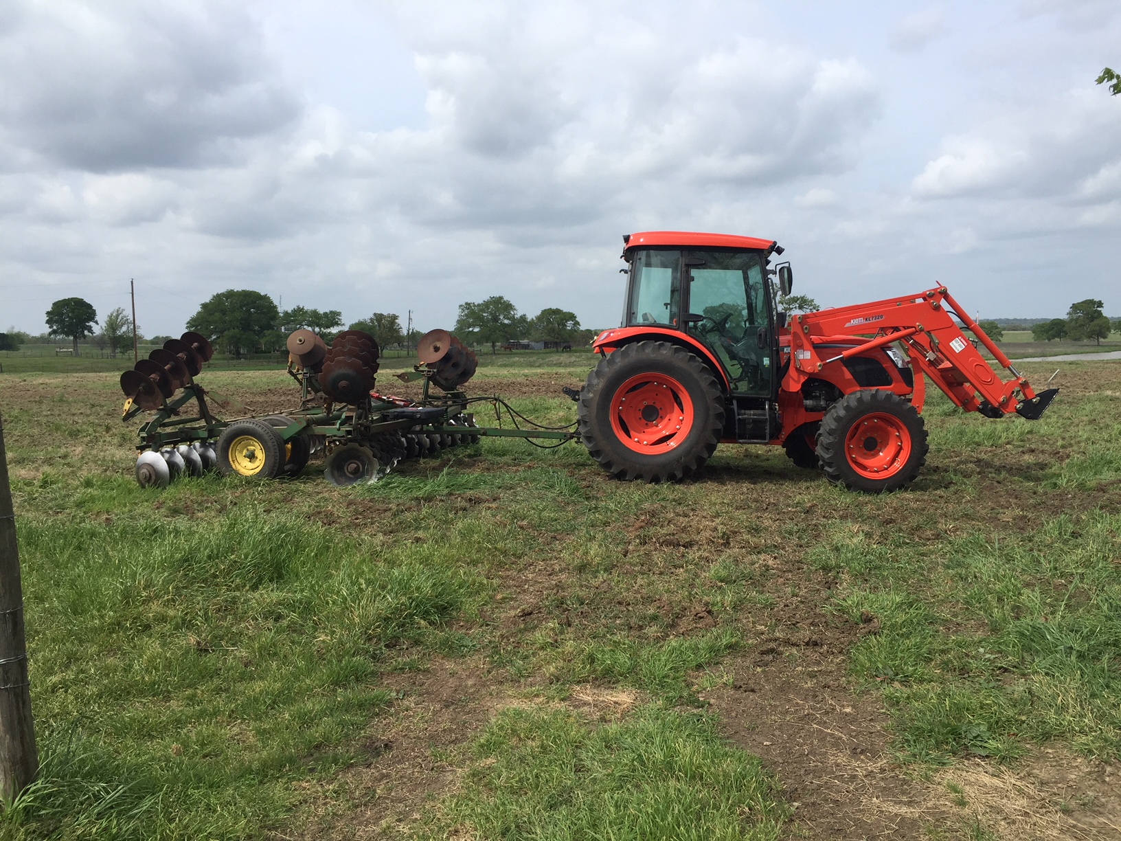

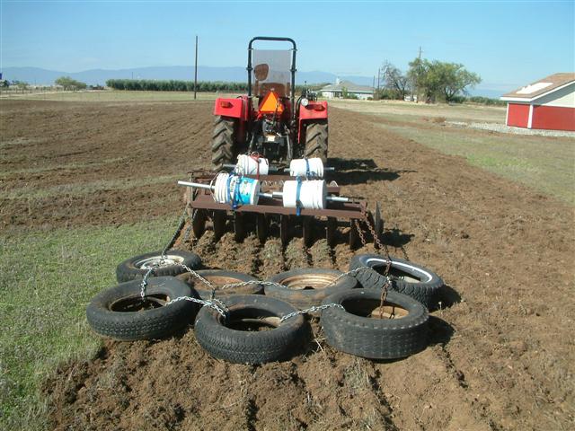

I have the Kioti 7320 which seems to be their version of the 7060 and am discing and planting 30 acres of old cattle pasture now. I borrowed the neighbors John Deere folding disc (12 foot wide folded and 20 when it is open) and I am not having any problems with it. When I started about a month ago the grass was very low and two passes with the disc really broke the soil up nicely. Then we had two good and heavy rains so now I am running the shredder cutting low before discing to get decent results. If the disc gangs on the 8' JD that was offered turn freely you will probably want to add some more weight to the disc (400 pounds would be a good starting point) to get it to really cut. Just remember that it is really not that many acres so treat it like a good learning experience if nothing else. discing.jpeg

I had a disk of similar size and setup which I was able to pull with a 45hp Kioti with R4 tires, and your machine is much larger. The R4 tires are your biggest limiting factor, but you should still be just fine. As others have said, you can pull it, but it won't produce good results fast (or maybe at all). Mowing first will help, but may not be enough. Turning sod into a prepared seedbed in a short period of time (days) requires a plow or a rototiller.
Is this a paying job? I would price it for at least four passes with the disk, plus mowing before if at all possible. And talk to the owner about reasonable expectations, because it is not likely to look like a long-farmed Illinois farm field in spring when you're done.

I concur with previous posters. It would help the quality of disking tremendously to mow to the ground, nuke with a high dose of glyphosate and then disk about four weeks later. The M7060 will pull that harrow in high range if you want to. The herbicide will brown the grass down to the root and prevent the root clod clumping which will want to cause the harrow to ride over the top and not really sink in well. Even so, if you can't spray, if you go over the field in a criss cross pattern enough it will suffice.
