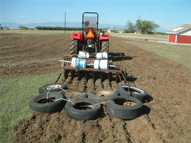

Sure. Your 70 hp tractor will handle that ancient 7-ft tandem disc (4 axles in an "X" configuration) with no problem.
I plow my 7 acre hayfield with a 7-ft offset disc (2 axles in a "V" configuration) using my 55 hp Mahindra 5525. To get that disc to work anywhere near decent, I needed to add nearly 500 lb of weight (four 120 lb concrete weights).
BTW offset discs are primary tillage implements used to plow native (unplowed) ground. Tandem discs are secondary tillage implements used on already plowed ground to break up the clods and smooth the field. That disc of yours is a lightweight implement with an angle iron frame. Heavyweight discs are built using square tube frame with 1/4" wall thickness.
Good luck
