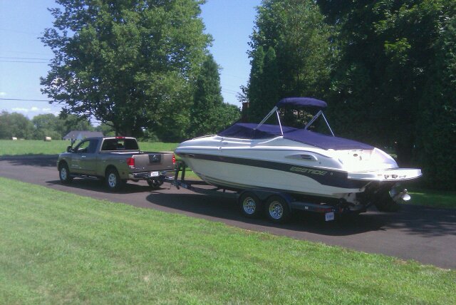

I have a 08 Titan and would not hesitate to put 9,500# behind it. Like others said the first thing is to make sure you are set up with brakes. The second is you will need a draw bar and 2 5/16" ball, and the third is you really need a WD hitch but that short of a trip you can get away with out it.
I pull 7,500# with mine 150 miles each and every weekend from May to October with no issues and have towed 11,000# once to help out a buddy with a broken Diesel Suburban.
