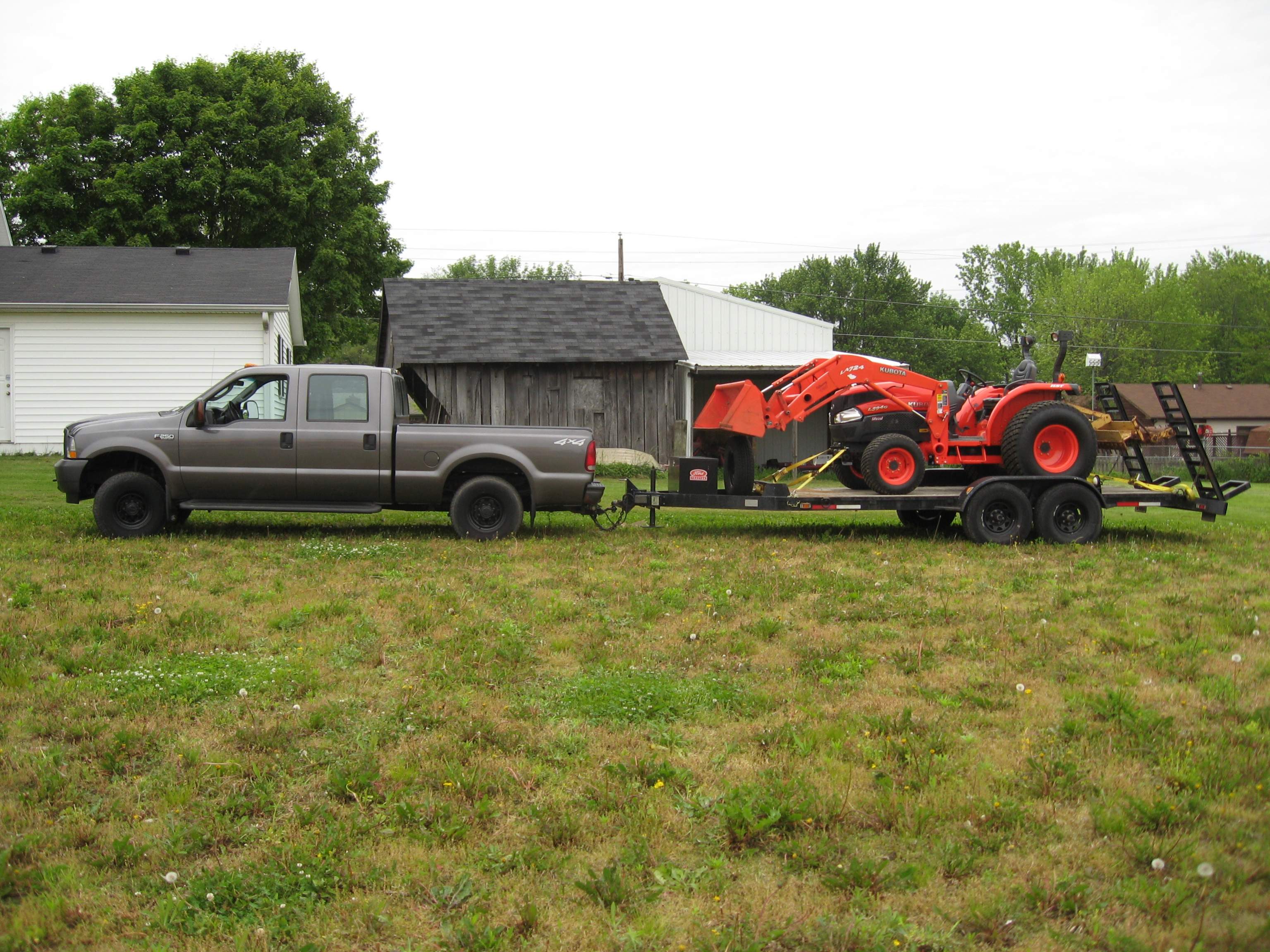

Here is my L3940 with FEL and pulverizer. Trailer is 10K 16' +2'. 2-5/16" ball is must. You will have or be near 1K tongue weight. Brakes are VERY important. Good luck. Philip.

Well the trailer will and should have brakes, thats of course the most obvious point. Tongue weight should be able to determined by you loading the tractor accordingly. I towed a 12,xxx lb mini excavator with my 3/4 ton and while i was not fond of the idea i centered the load over the trailer with a little bit of tongue weight, the truck barely sagged at all and towed just great with the trailer brakes dialed in it was no worse than my 6x12 enclosed with no brakes.

Don't blame the truck for the operator's inability to get the load properly balanced. If the front end is that light, someone has put way too much wt. on the trailer tongue. Any properly equipped late model 1/2 ton has the suspension to handle ~10% tongue wt. on a 9-10K trailer.
