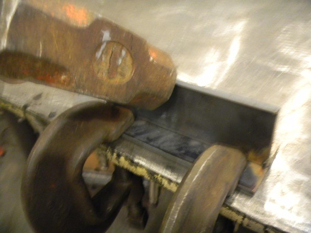

Jim years ago I did some fillet weld break tests, on mild steel flat bar. 6010 5P-plus broke with 10-blows from a 4-pound hammer. 7018 that never seen the inside of a rod oven broke with 18-blows. 7018 right out of the rod oven broke with 23-blows.

Ductility of the 6010 is lower than 7018, so I'm not at all surprised by that hammer test outcome. Given the application the OP is asking about, I'd still choose the harder rod that's designed to handle impurities in the base over one which won't. I've welded just enough farm steel to make sure I have the exhaust fan on before striking an arc on it. It's not only usually soaked in oil, chemicals, and dung, but also some of the worst metal poured out of a vat. I'll take the rod that says "Oh boy, my favorite!" instead of one that might turn to swiss cheese under the flux. Adding to that, the ease of running it out of position is a plus. If the OP reinforces the joint so the weld's not directly in shear, then I don't think it'll matter what rod is used.
