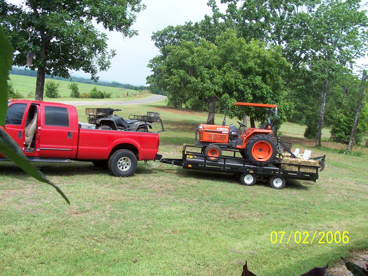

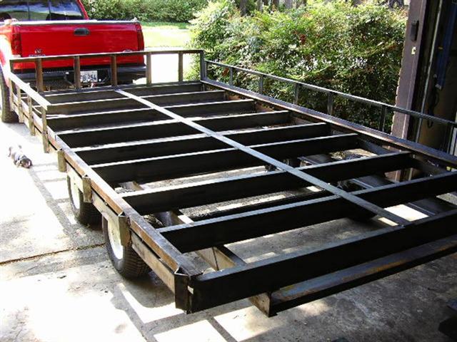

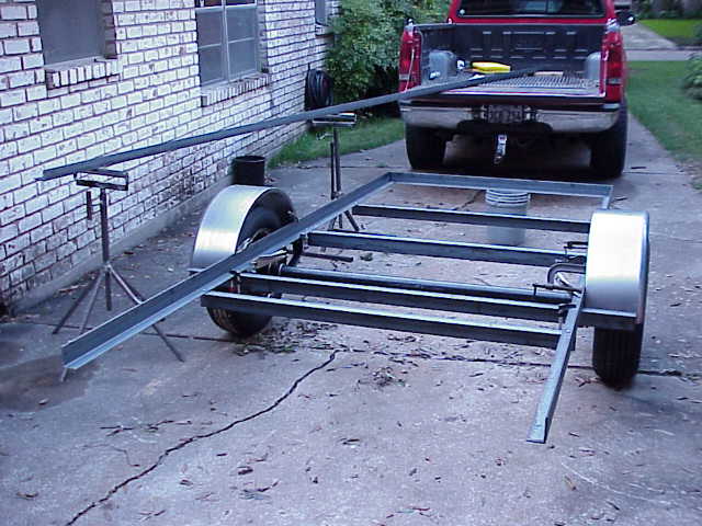

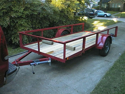

I think you'd be fine with the 1/8". Carrying your tractor with an implement, FEL and all might be a bit much for a long haul. Short haul no problem. Your axle mounts are going to be 3+ feet apart to spread out the load. Plus if you use 2x6 or 2x8 to deck it you'll get those to spread out the load. Also what many forget is if you weld on the side rail you've now got a quasia truss type support on both sides. $45 is dirt cheep for that metal.
Here is a 5x12 I built about 10 years ago.
Good Luck,
Rob

RobJ, Thanks for the good word. That trailer looks good. I do plan on using 2x6 or 2x8 decking and build a 12" or so high side rail as you mentioned. I plan to copy the pattern of that from an engineer designed truss from a bridge or a trailer. Could you tell me how many cross braces you used under the deck and what was the load capacity you ended up with? I understand why people shy away from giving advice on something that may be a questionable project, but trust me I don't intend to do a half apple job.

Just put your cross braces ("joists" if you will) on 20-24" centers. I put them 30"OC on my dump truck,overlaid with 3/4" subfloor plywood and 1/8" steel sheet...nothing has broken though yet. It ain't like you're gonna load a 2 ton steel wheeled tractor on this thing.

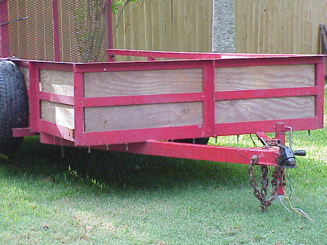

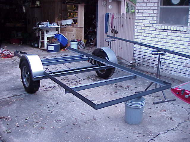

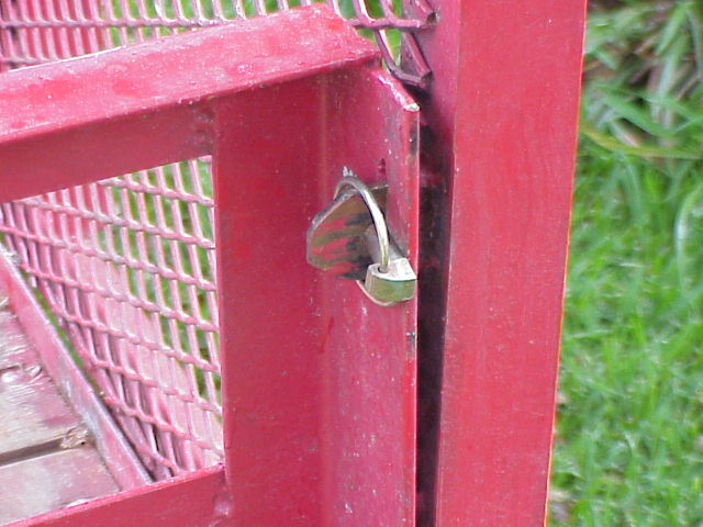

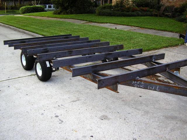

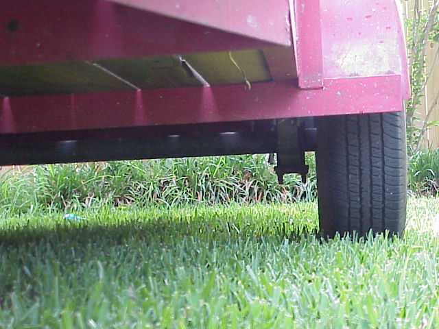

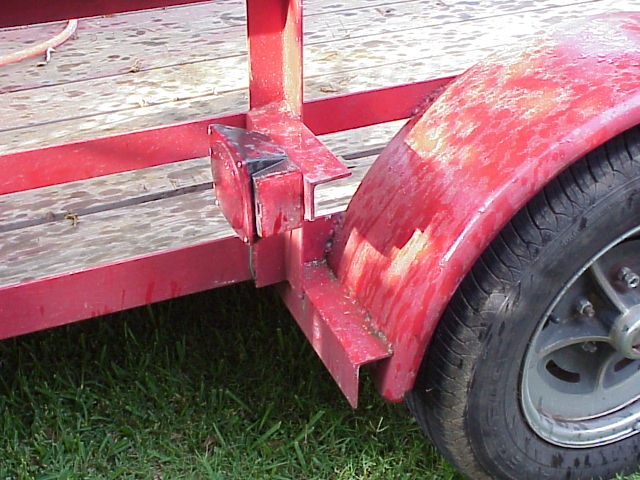

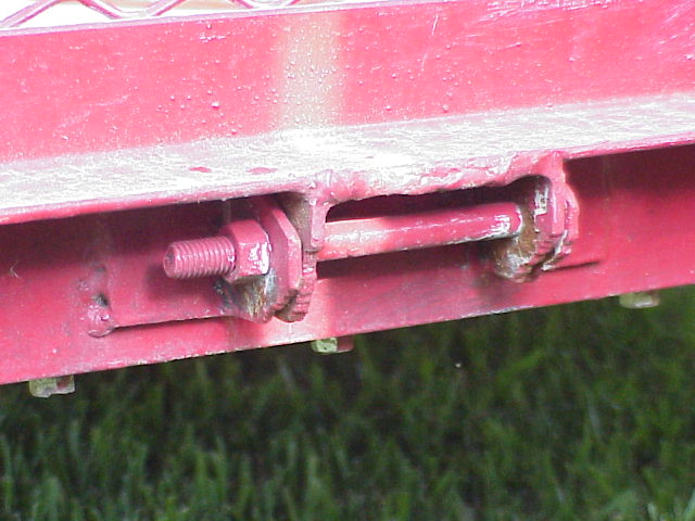

Here is a few more pics for you. I don't know what it's exactly "rated" for. I build it to haul what I need. Specs were the same as bought trailers. The place where I bought the parts (Husky) said to take my time and take all the measurements I wanted from their trailers on the lot. Not a problem. Key is the axle is 60/40 split. 40% of the lenght behind the axle. I did mess up the rail height. Can recall why I designed it that way but as you can see I had to go back and add a middle strap. A standard Igloo cooler would slip under it!! I also built the ramp and all. If you have extra steel, just toss it in the supports, instead of 24"oc, go 16"oc, etc. I think I ended up with more around the axles, the front hitch V will add more support up there.
When I got the tractor I sold that one and build one a little bigger. 7'.5'x14' sled style. In hindsight 16' would have been nice (and I had the steel), but in reality the RC hangs out the back if needed.
The pics..

RobJ: Thanks for the pictures. I'm hoping to build something similar to the red trailer you have/had. Thanks for the detail shots too. They are very useful.
