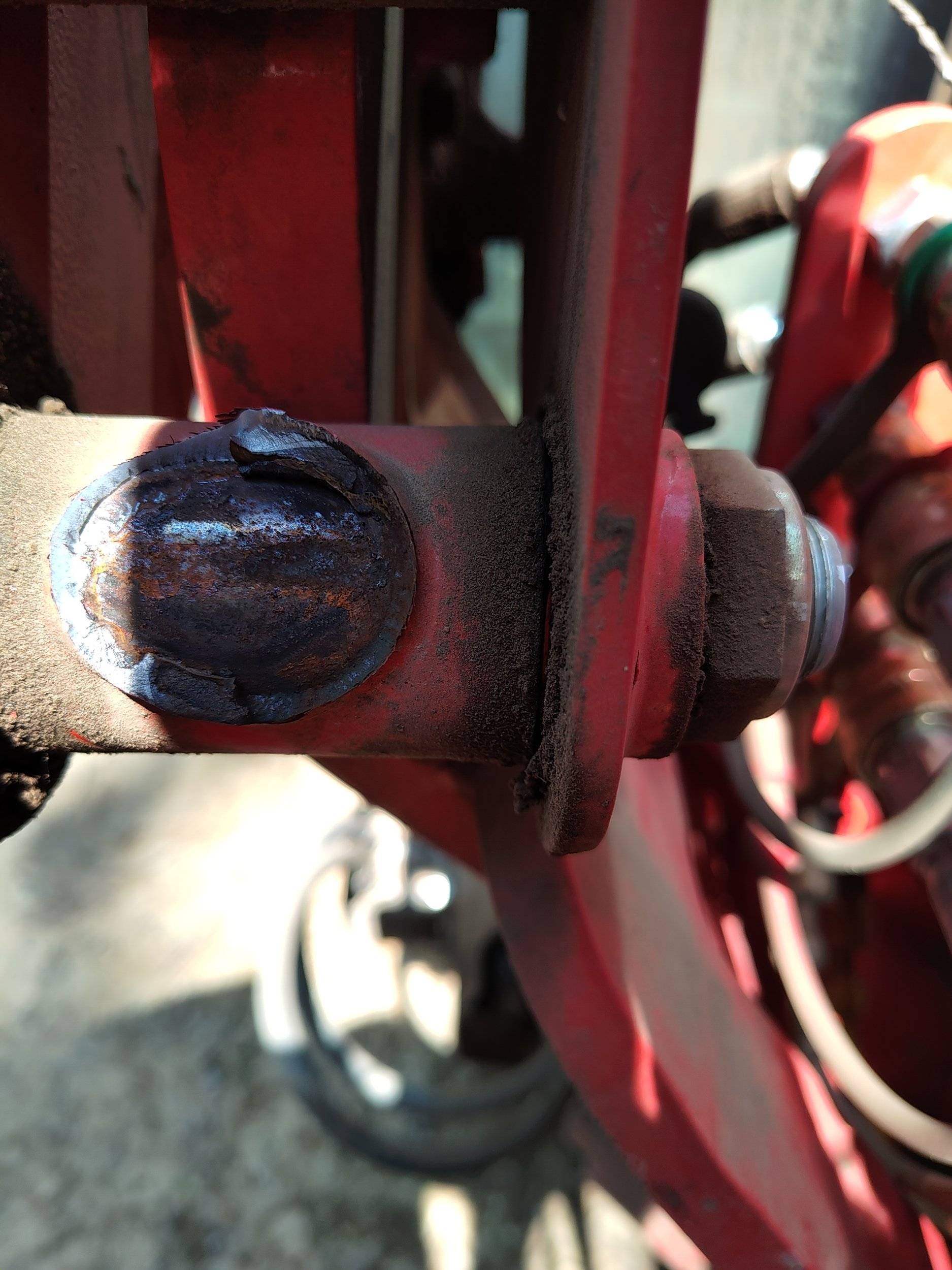

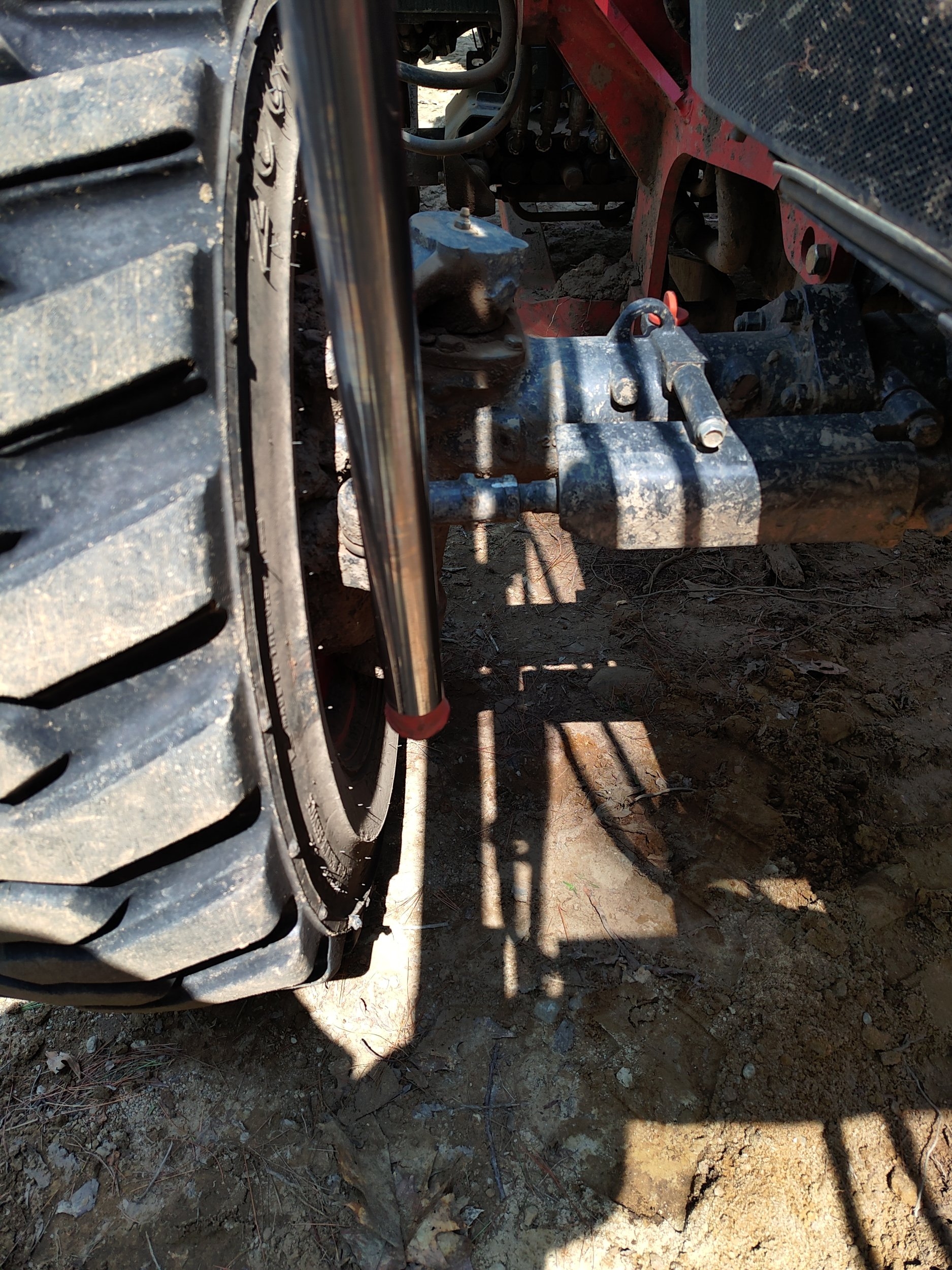

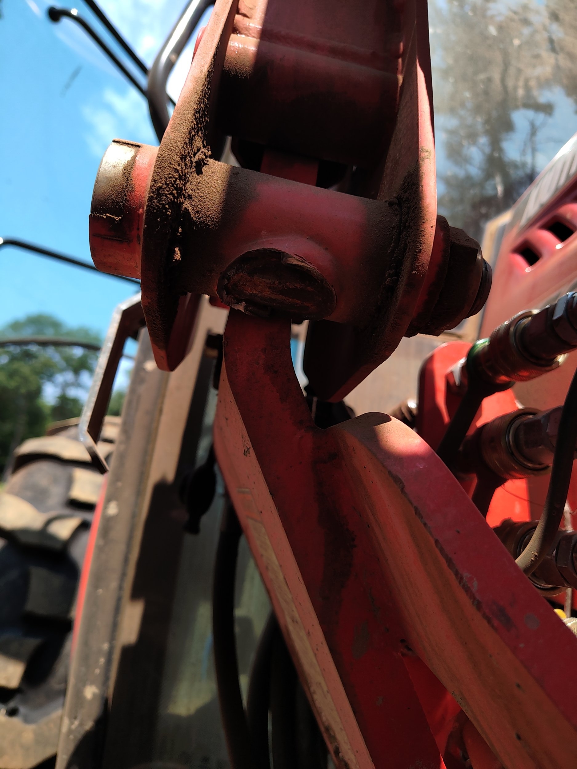

Was moving some rocks today when all of a sudden I saw my loader cylinder dangling. Looks like a break at the weld. I am thinking this can just be repaired. Is that the case or do I need to buy a replacement?

Yes, it can be easily repaired by just welding it again.
Clean the old welds with a grinding disc or a flapper wheel, put a good chamfer on the end of the rod. Then put a good weld bead on it.
If you're the one taking the job, make sure you cover the rod as close as possible to the weld so the weld spatter won't damage the chrome.

Should have been much more weld than that. Looks like they didn’t bevel a thing. I would be looking at rewelding the other side also to prevent another break.
   / Can this hydraulic cylinder be rewelded or do I need to replace? #7
It can be re-welded. Cost is hard to say because I don't know what weld shops charge in your area. Before I retired I told customers to bring me clean stuff to weld because I would charge them shop rate to clean their stuff. So save yourself some money and clean the area very well. And, like Alan W. mentioned, have the other rod looked at too. Clean up the other rod area so the welder can get a good look at it. In fact, clean up anything that the welder may need to handle. Welders hate cleaning oil, grease, dirt, and mud from stuff that needs welding.
