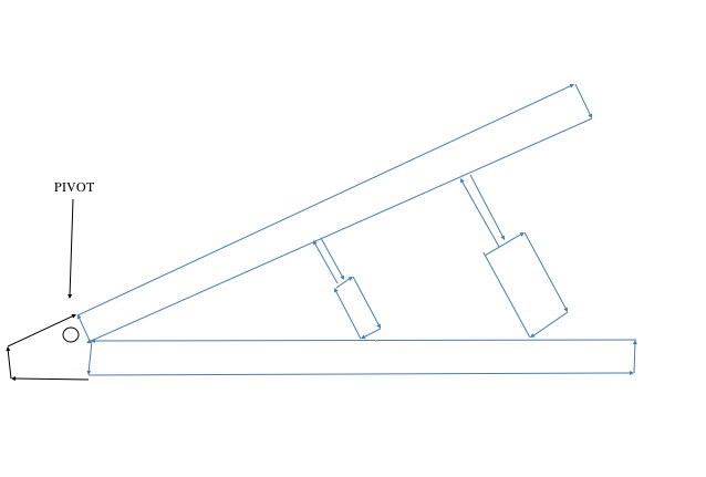

If they are acting in unison on the same mechanical function or leg?
I have a constraint that only allows for a certain length of retracted cylinder, but at the same time require more of a radial arc than one cylinder can provide on it's own, if I add a linkage, and change the directions of the push/pull, I can add a second cylinder, but am not sure how the function of two potentially different sized hydraulic cylinders will act on the same circuit.

The big cylinder will fully extend before the small one moves because the larger cylinder requires less pressure to lift the same load.

The small one will extend first because it takes a smaller oil volume. If you are trying to use them together like on a loader you will bend something most likely. Retracting force varies with piston size and rod size. It is all based on the square inch displacement, multiply by by psi and you have the force.

How about a sketch of what you are doing, then we could help more.
   / Can two hydraulic cylinders of two different sizes, be plumbed together? #8

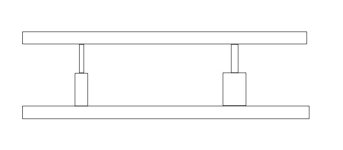

They will work together, each to their best ability, it they are mechanically forced to, like this diagram of a boom.
If they can operate independently, like this lift platform, they won't lift evenly.

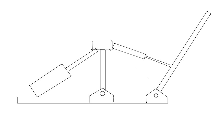

Not like a loader. they will be inline with one another, operating a single articulating "dump/curl" mechanism so to speak.
   / Can two hydraulic cylinders of two different sizes, be plumbed together? #10
Functioning something like this, mechanically?
