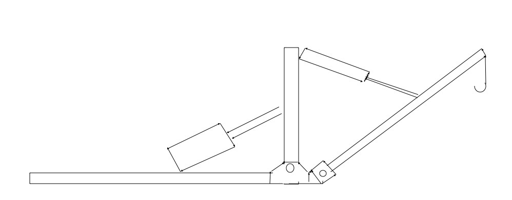

What about when retacting the cylinders? Could the larger one pull the rod or damage the packing of the smaller one?

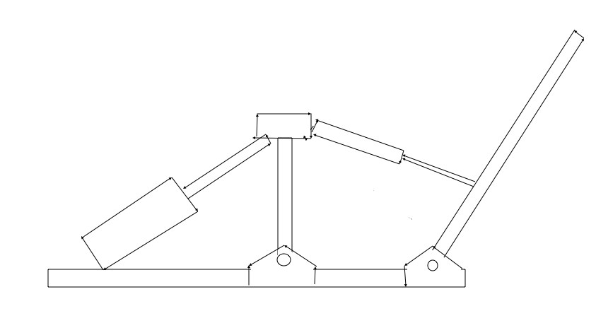

No because the cylinders won't be connected, and actually the drawing above isn't exactly the way it's going to be.... the larger cylinder will push and pull like it does above, but the the small cylinder will push and pull the entire assembly on its own fulcrum. they will not share fulcrums, so the only overload potential is from payload.

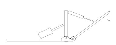

If I am reading this right, you have a boom you want to make move a total of 65degrees, vertical/horizonal doesnt matter. Is there some reason the cyl must have 17in of stroke, or can one of a shorter stroke work. I cant see why you cant make it work with only one cyl, size the cyl to handle the maximum load and keep it simple.

I need 110 degrees of motion. It will essentially work like a hoe bucket, except instead of a linkage between the bucket and cylinder, there will be another cylinder. My attachment points on the machine side do not allow for manipulation of radial arcs based upon advantages leverage points.. ie: attaching the cylinder low on the lever to maximize swing with a given stroke allowance.

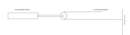

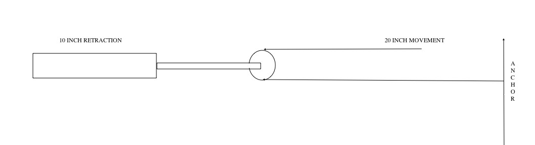

As stated earlier, I need 17" of stroke length, but do not have adequate area to install a cylinder of that retracted length. Again, if I could utilize only one cylinder I would.

I've been in fabrication for 23 years, a Machinist for 5, all of my loads and leverages are calculated and accounted for. The question was about cylinder function, not design input. The design side was brought in as inquiries by other members. Your opinion is based upon assumptions, and while I thank you for taking interest in my posting, please reserve your judgement for someone else. As far as my research has shown, there has never been a design/ function like what I am trying to build, and am intentionally trying to be discreet with specifics. Additionally I stated that I need 17" of total stroke, not necessarily from the same cylinder, but in total to achieve the necessary arc at the given fulcrum and load points.

The design only has one constraint and that is space. It absolutely must be as compact as possible, while still meeting the minimum performance requirements.
