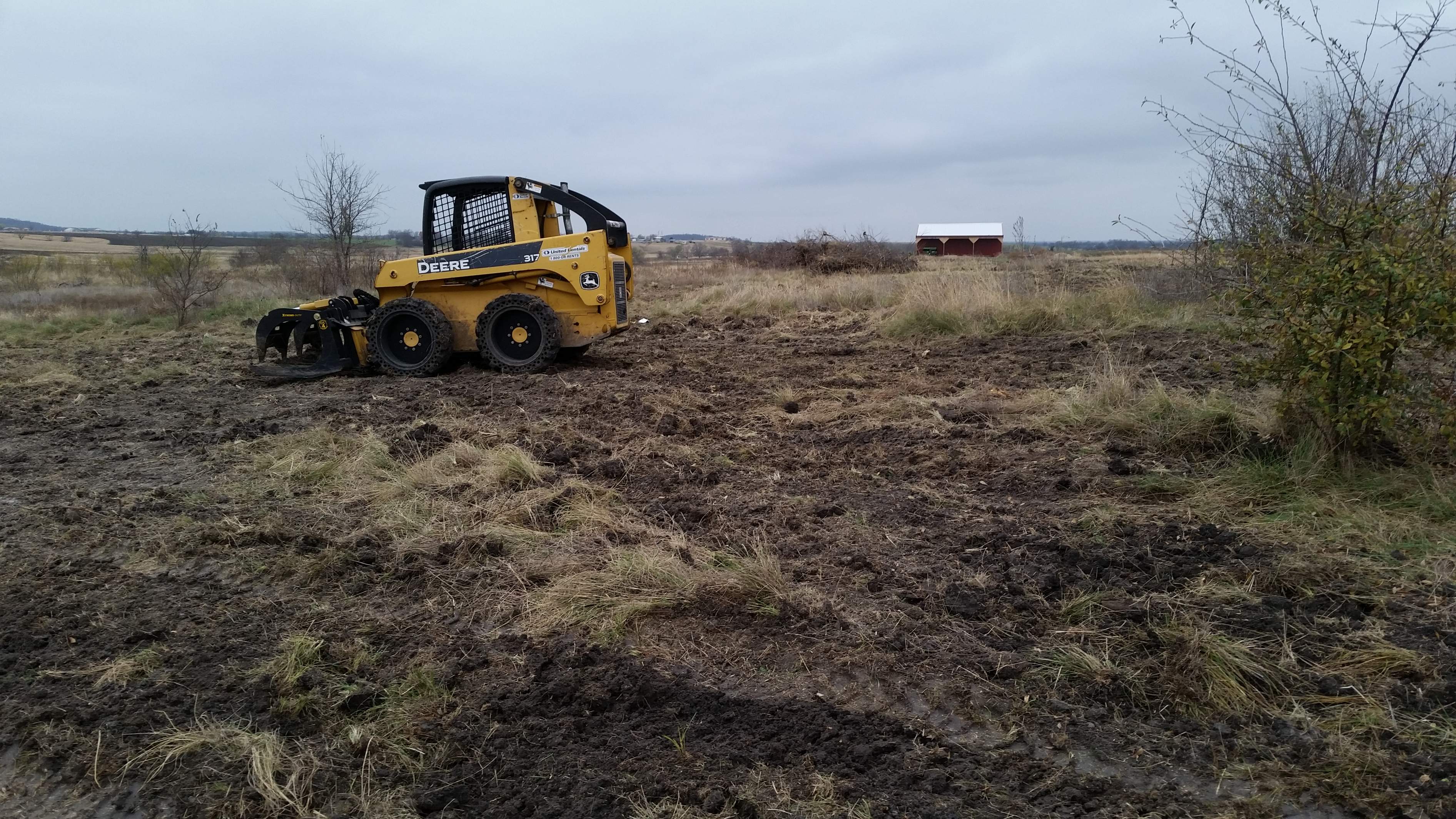

I back drag with my skid steer rake all the time, usually with the grapple down for better visibility. Mine does have a 3 inch pipe about 10 inches up from the tine points.

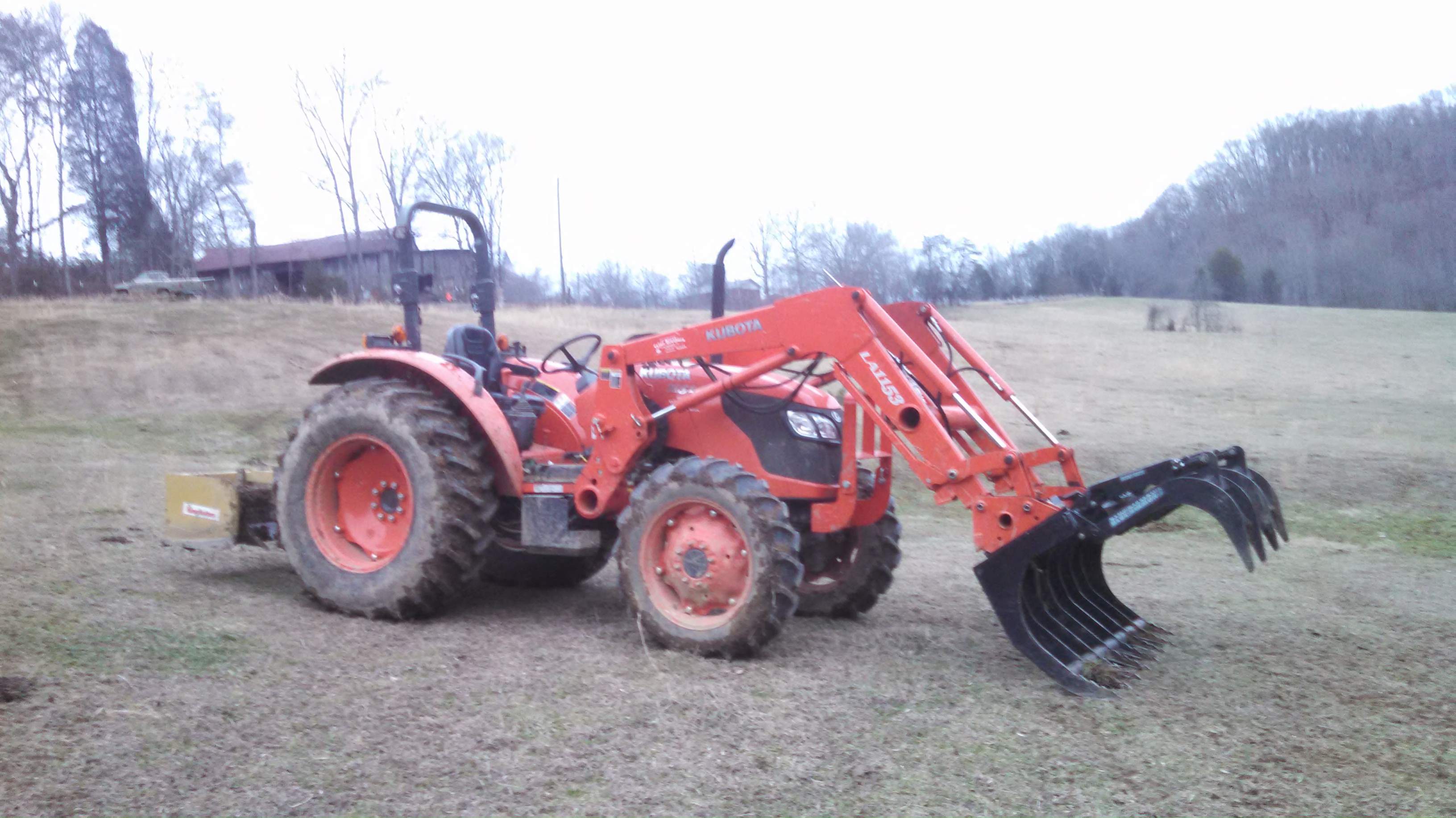

Compared to a typical rake grapple that has one lid and many tines, a typical 2 lid L grapple with only 4 tines will not back rake worth a dang. But they can do an "okay" job.
What are you trying to back rake?
   / Can you back drag, or back rake effectively with a dual hydraulic grapple? #6
It will not do dirt, but pulling brush backwards works really well.
Limbs, woody debris, roots from a clear cut
