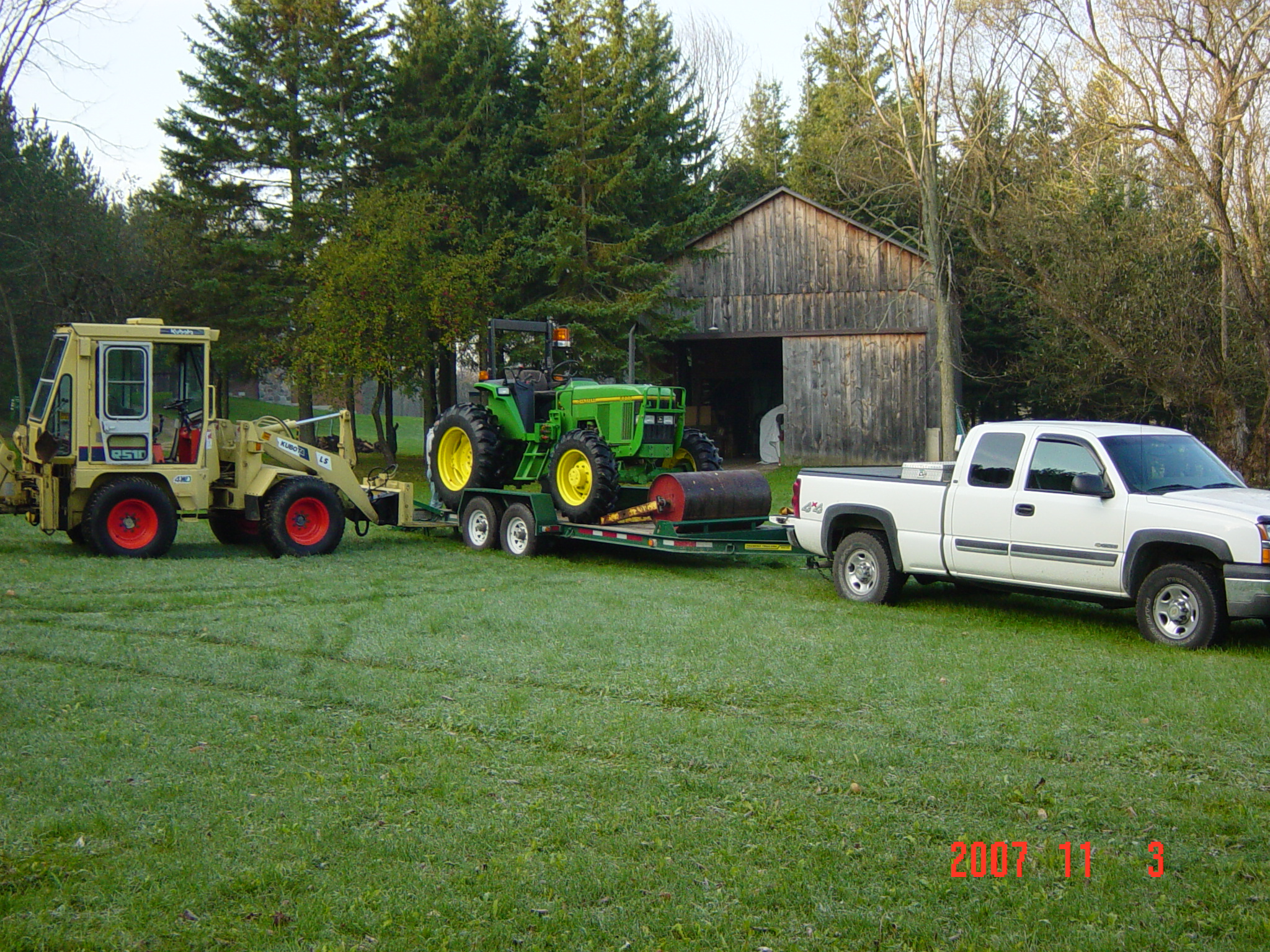

A few years ago, I had a friend with his half ton and brand new double axle hauler offer to take my JD 6200 (less 640 Loader, loaded rear tires) to a shop for some work. Back roads, maybe 15 miles. We could not get the front tractor wheels past the fenders and didn't want to scratch the new trailer so the tractor was just kind of hanging off the back of the trailer with the trailer trying to lift the arse end of the truck up.
THAT, was a most interesting trip, the sensations even as a passenger, that I will never forget!

I thought I might have a picture. Well, it seems we could not get the BACK wheels past the fenders and put that roller full of gravel in the front for ballast. Funny the picture doesn't look like anything is really wrong, and yet the ride was quite unsettling.

I thought I might have a picture. Well, it seems we could not get the BACK wheels past the fenders and put that roller full of gravel in the front for gravel. Funny the picture doesn't look like anything is really wrong, and yet the ride was quite unsettling.
Unsettling is putting it mildly!!!! The real danger begins when you try to slow down!!!! :)

I don't remember why the tractor needed work. In hind sight, we should have left the loader on.
