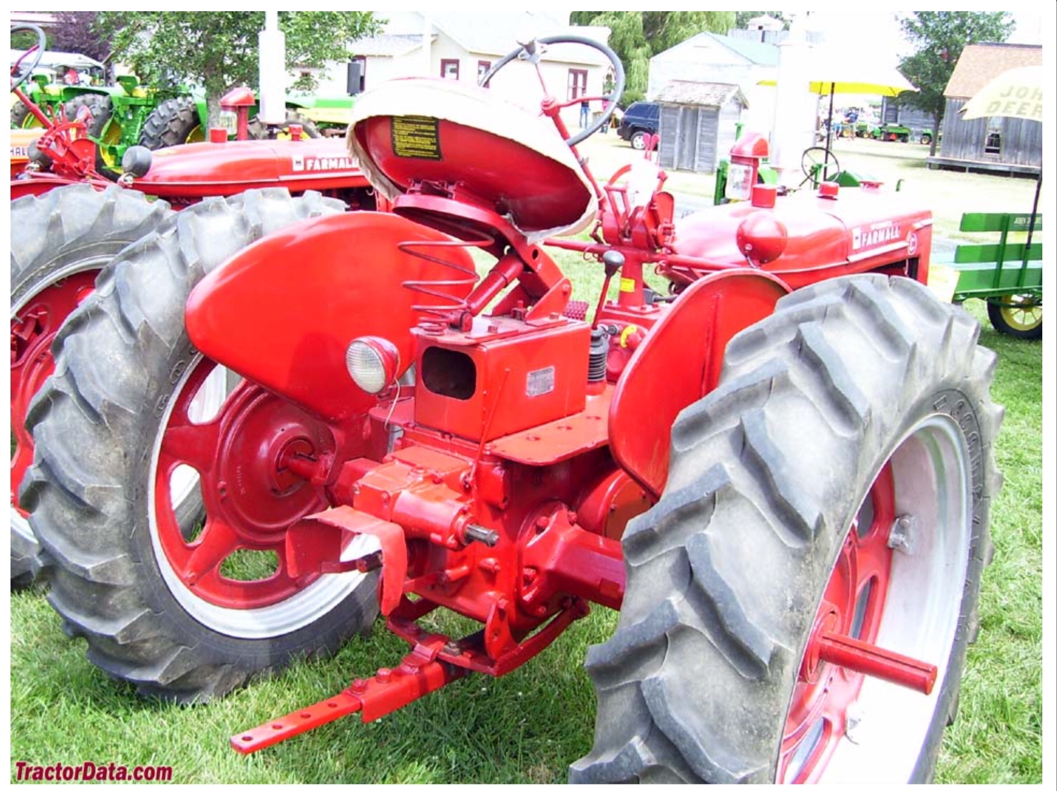

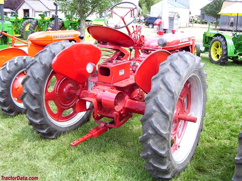

I thought so too, but Tractordata says the C came with 9-36’s on rear, the Super C with 10-36’s, H’s with a wide variety including 9-38’s and 10-38’s....
That website also shows this picture of a C’s rear:
And this for a Super C
   / Can you identify this tractor just by looking at the back #14
Those last pics clearly show the C's rectangular 'box' piece underneath the seat with serial number plate on it that distinguishes it from & H.

A friend who bought a Super C 25 yrs ago said it has an independent PTO that C lacks. He hated the thought of use any implement without it, esp brush-hog.
