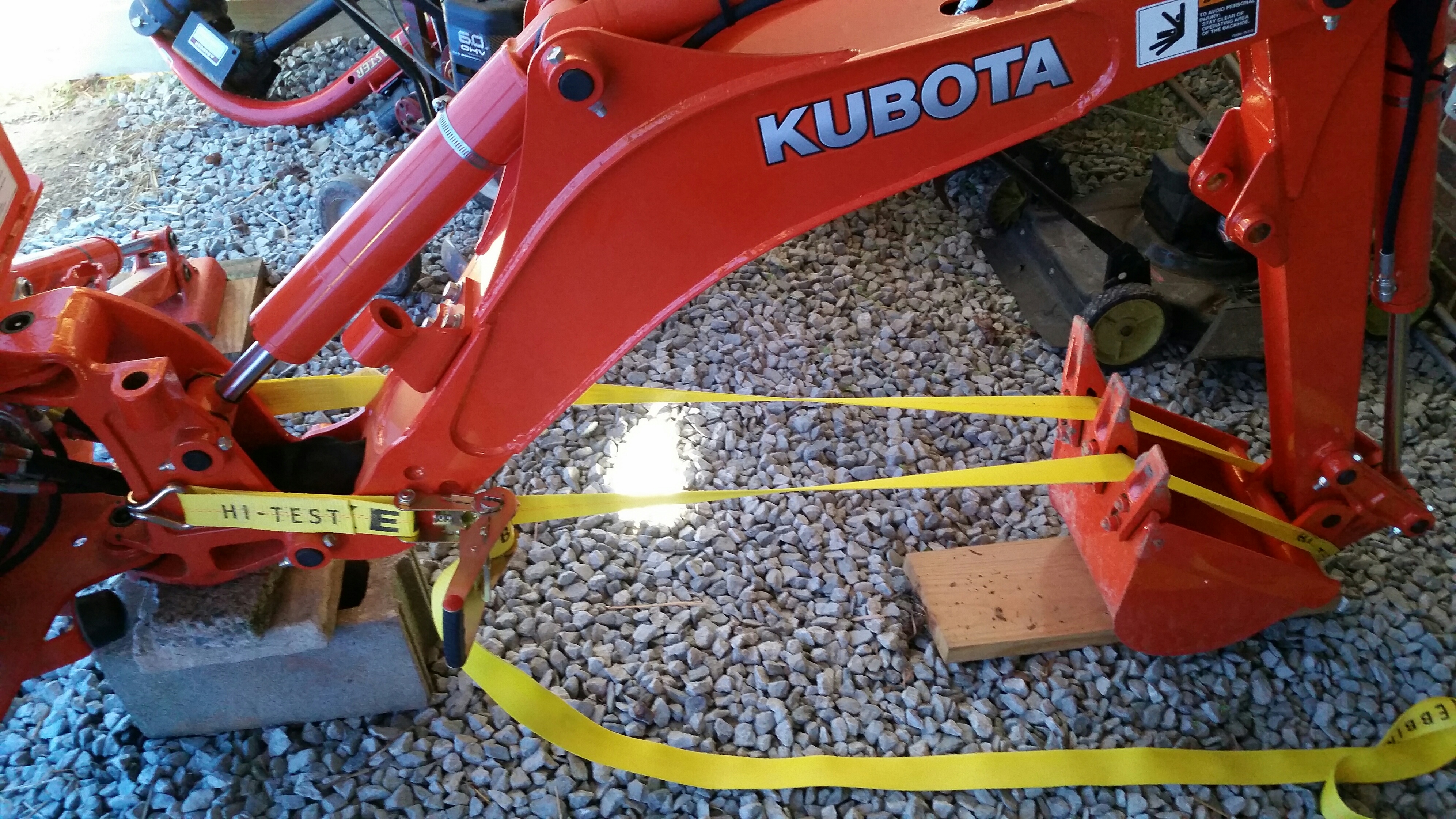

I've started removing my FEL when mowing simply because it was slowing me down as I was trying not to hit things with it - heh. Once I learned how to take off the FEL, it goes pretty quick. The BH on the other hand, is never hooked up unless I specifically need it. Hooking up the BH was always a problem because it squatted over time so I've started using a 3" ratchet strap on the arm and set the unit on blocks to help keep it where I can hook it up faster. BHStrap.jpg
