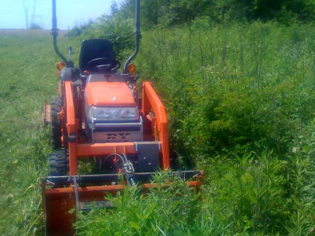

I spent most of the weekend on my 23 running my 4 foot rotary cutter on some ground that had not been mowed since last August.
I wasn't concerned with quality but it did pretty well if I overlapped a little.
I snapped a cell phone pic, sorry it's not very clear but I think you can get the idea.
You can see the average size sapling in the background. Some were larger and I have a guard on the belly and have had no problem runnign over stuff like that.
