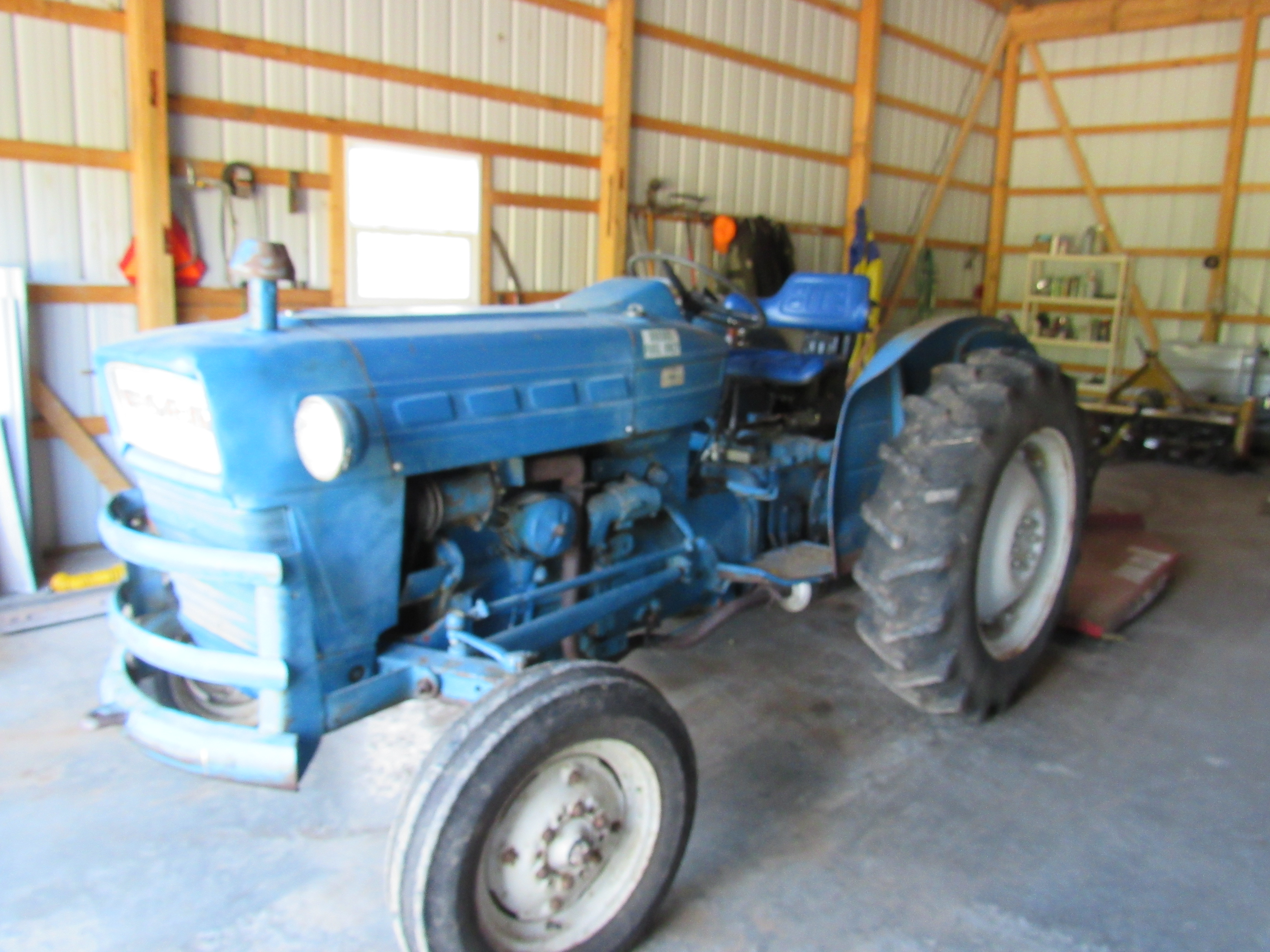

1966 Ford 2000 Diesel 8sp

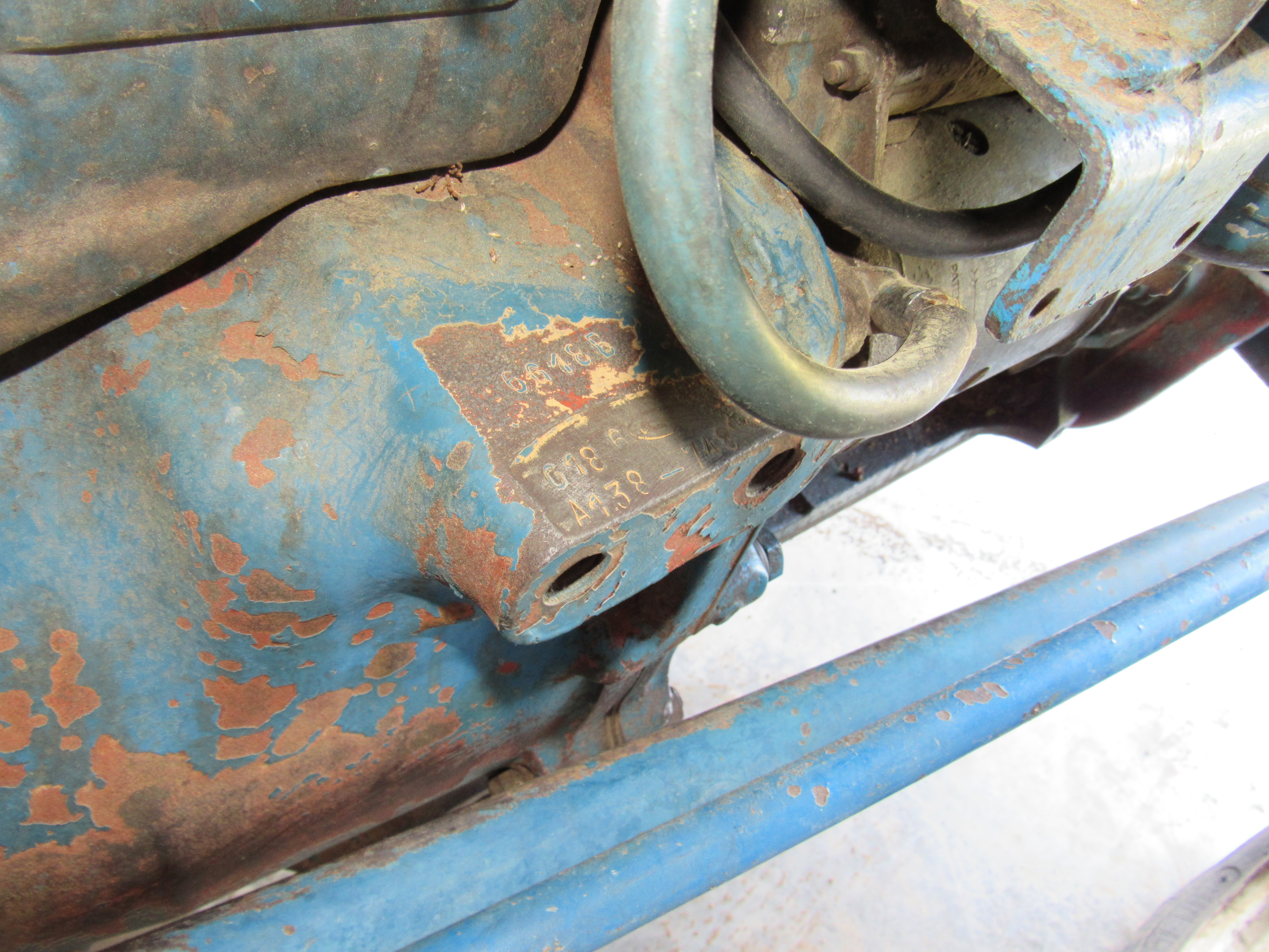

I think its a 1968 but I'm a little confused by the stampings because they are worn and hard for me to read. Any help is appreciated. IMG_0094.JPGIMG_0093.JPGIMG_0095.JPG

If yours is the three cylinder as it looks like it was made between 1965 to 1975.

Post the Unit code from the foil tag under the hinged half of the hood, or post all 3 rows of numbers hand stamped in the clutch housing on the horizontal surface behind the starter and below the fuel tank shutoff.
   / Can you tell me what year this Ford 2000 diesel is? #4
well the 6g18b is the unit code (top number, bottom pic)
1966
July
18
second shift
louvered hood and wrap around grille were used from 1965 to 3 / 1968
