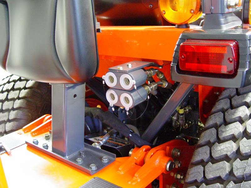

Last one

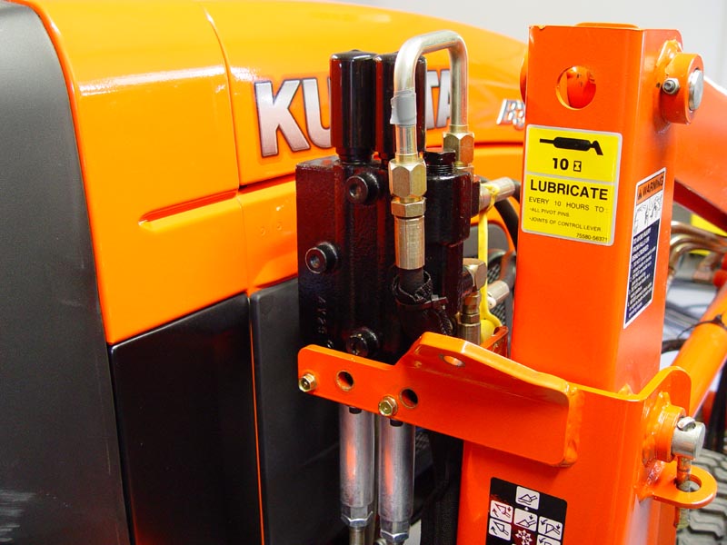

Devildog, this is pretty simple but hard to demonstrate.
The valve is upside down. The cables (coming from the remote joystick) are connected under the valve. Remember... the push/pull valve's control is over with a standard joystick and under with a remote.
The valve is bolted at angle with a standard setup and it's mounted straight up (are straight down... it depends how you look at the thing /forums/images/graemlins/grin.gif ) with a remote.
I didn't compare the part numbers but it looks like the two valves are the same but mounted in different angles. With the remote, there's no valve cover.
I hope it makes sense to you. /forums/images/graemlins/wink.gif
   / Candies for B3030 #33
Stef,
Believe or not it does make sense /forums/images/graemlins/wink.gif That was a great pic, Also thanks for the shot of the aux levers to. Now that is the kind of candies I like /forums/images/graemlins/laugh.gif
