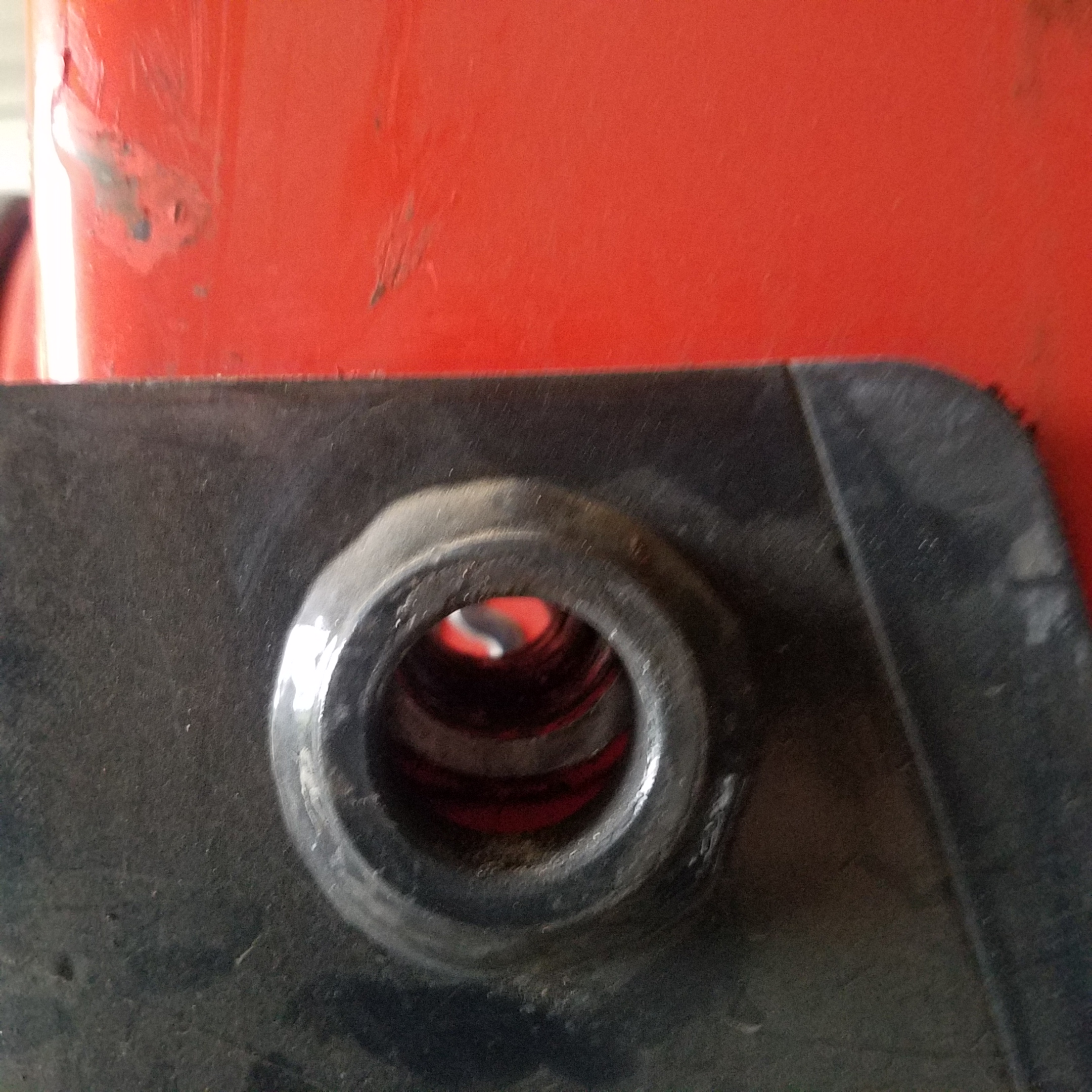

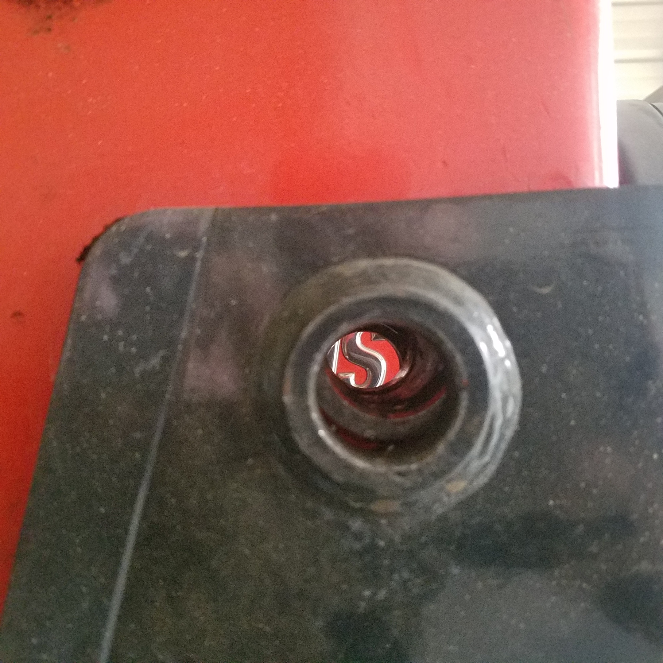

Tried again today. Just cannot get vert. alignment right. Similar on both sides.
I took away the legs and am using just bucket to see if that helps.
At this point I am able to get a couple of metal rods into the holes so at least I can lift bucket clear of ground to play with it.
I'm not sure if II am better off having bottom of bucket on ground or open end of bucket on the ground as i try this.
Here is a pic of where i am at presently. As you can see not there yet. I tried to jack up the chassis to align but did not help.

Top of the loader needs to come down. Roll bucket out for it to rock the loader arm back downward until the lower pins are resting in the cradle. Then use the lift cylinder function to change height of the top pin. Not 100% sure of my geometry but think you may have to extend the lift cylinders (raise) to pivot the top pin back down.

Now that you have it close but not quite insert a smaller pin in one side then trip lift into float position. That will allow the lift cylinders to move as need while prying to align the pin.

OK this may sound dumb, but is the lower hook point fully seated? The one time I had my loader off I had an issue connecting up, until I noticed my lower hook point was out of kilter. Once fully seated is was a non issue.

Turns out I looked at the cradles in the frame where the loader sits and there was a ton of sand in the cradles. i guess when I removed loader the sand settled.
Cleared out sand and now things are lining up however when I reattached the hydraulics I now have no loader movement !!
