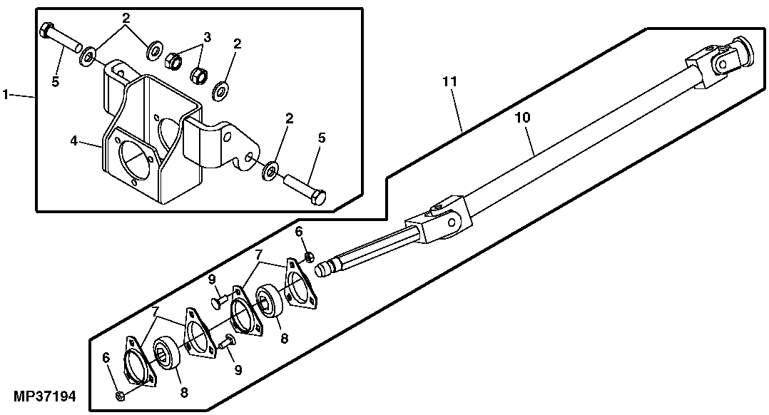

You still need to look in the snow blower catalog. Only they do not show a breakdown of the drive shaft. Key #10 is the drive shaft, LVA14109 $405. Not keyed is AN278257 cross and bearing assembly $72. I am not sure what you get with that.
Understood. We're speaking the same language now. All the diagrams I see for AN278257 do not show a lube fitting. I'll figure something out. Thanks for all your time.
   / Cannot Find Part Number For JD3520 Grease Fitting #15
Go to the 3520 parts catalog, then Implements, then 2108 59" two stage snow blower
Thanks for the heads up. I was unaware to access some equipment one had to first access the tractor parts catalog. Thanks again,Jim
