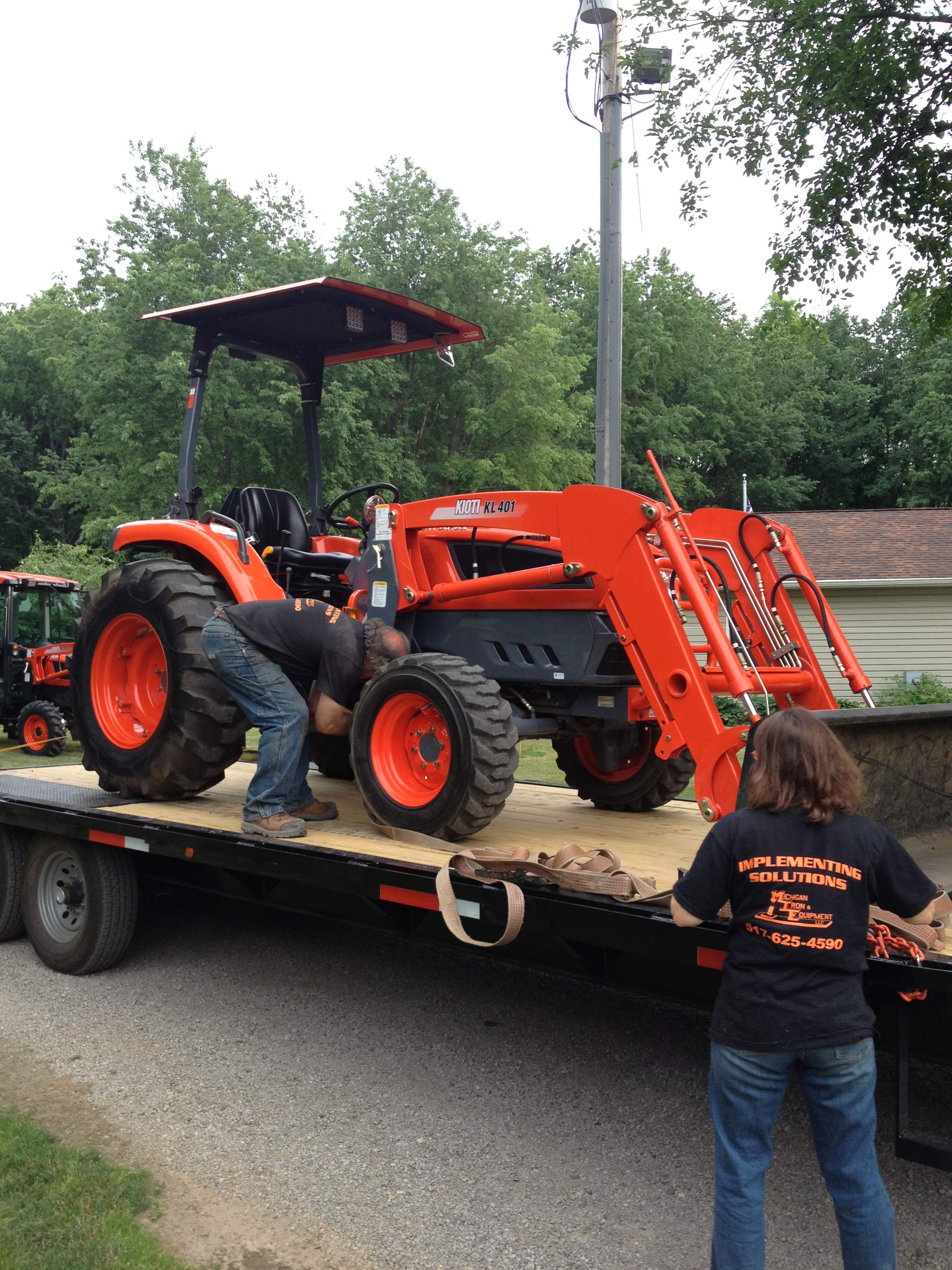

All I can remember was it took me and the salesman and his lovely wife to install it with darkness coming on. We messed with and adjusted for an hour to get it straight. She was instrumental in holding the front end up and we messed with trying to get it symmetrical and straight. it wasn't that it was so heavy but just awkward to move around and adjust. Sorry I can't be of more help.

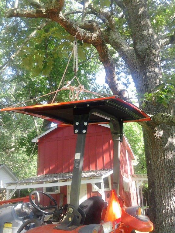

I have some updates and a request for more advice:
The canopy is definitely a Perry Ardvark, according to the shipping paperwork. It's about 47 inches wide and 58 inches long. After reading advice here (and reconsidering the difficulty of manually hoisting it) I came up with a new plan. I dug out an old 4-part block and tackle and hoisted the canopy from a tree branch. Then I drove the tractor underneath and lowered the canopy as needed to install the bolts. Here's a photo:
The canopy came without any assembly instructions. So before tightening the nuts so I thought I'd ask for guidance/help here. Specifically:
1. Do the mounting brackets/plates install with the angled side forward or aft? Does it matter?
2. Are the mounting brackets/plates designed to attach to the inside or outside of the angle frame of the canopy?
3. Should the heads of the bolts that hold the bracket to the canopy frame be on the inside or outside? Does it matter?
4. Should the brackets attach to the forward or aft set of holes in the canopy frame? Is it purely user preference?
I also emailed Perry Co with the same questions but don't know if or when they'll respond.
Thanks for any help.
Scott

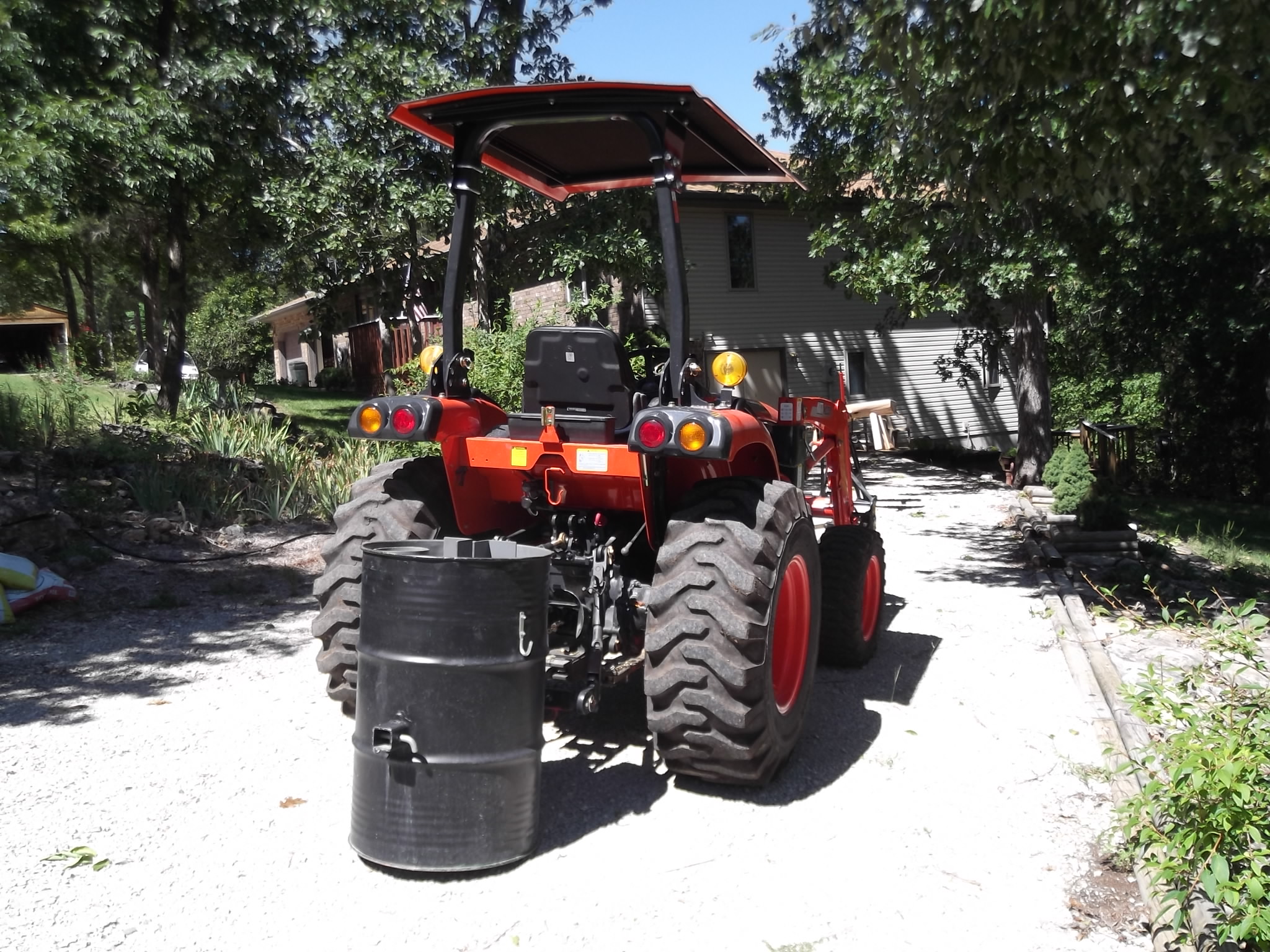

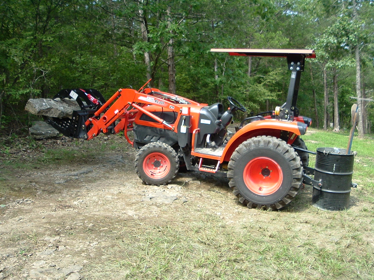

James,
What do you have in the bottom of the barrel rocks or concrete? Also how does the barrel attach to the three point, curious as that looks a bit better than my quick built counter weight.
Thanks
Rancho
/ Canopy Install Advice #8
James,
Thanks
Rancho
Concrete. Inside it is a Tractor supply "Cat 1 Drawbar with some angle Iron bolted to that for the uprights for the top link, and then the rear 2 inch reciever has a piece of 5/8 all thread thru the drawbar then welded to the 2 inch receiver and then some rebar welded at angles onto the 2 inch and to the drawbar too. Fill the whole mess with concrete leaving room at the top for chain and miscellaneous storage.

To close out this thread, Perry Co never responded to my email asking the questions in post 4, above. The canopy came with no instructions (see http://www.tractorbynet.com/forums/...opy-painted-steel-aluminum-3.html#post3804520).. So I called Perry Co and spoke with a nice lady who emailed me some instructions:
She also said the side brackets should attach to the outside of the canopy frame (I had them inside). My canopy was still supported by a block-and-tackle (post 4 photo) so I just made the required changes, let the front of the canopy drop to its natural position and snugged all the nuts. I lowered the side brackets slightly such that the ROPS is almost touching the insulation under the canopy.
In retrospect, using a hoist was vastly better than getting 2-3 folks to lift the canopy into position. With the hoist, it was an easy one-person job.

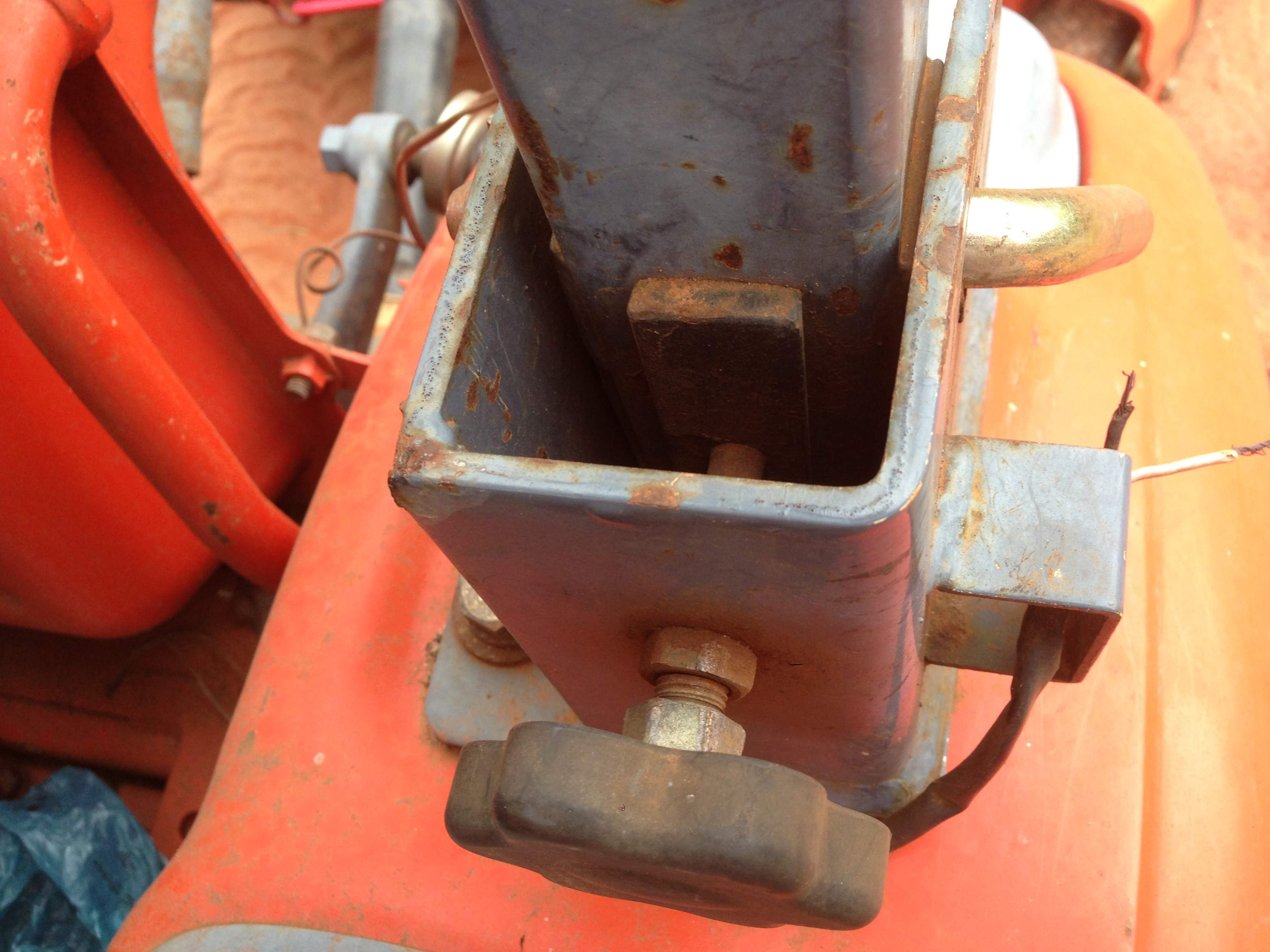

Then I gave it a trial run as I mowed a couple acres of field. This steel canopy is slightly smaller (47 in by 58 in) than the fiberglass canopies (http://www.tractorsunshade.com) sold by local tractor dealers but it still provided useful shade and I think it is less likely to get damaged in the woods.
The only issue at this point is that the whole ROPS/canopy rocks fore and aft slightly as I traverse rough ground. Tightening the screw at the ROPS base helped but did not eliminate this motion. Based on inputs from NC Redneck, I'll try to fashion some metal wedges to eliminate slack at the ROPS bottom pivot. Redneck advises that this motion will destroy the stock screw before long. I may also try a bungee (from the canopy to the loader cross piece) to eliminate the fore-aft rocking. Any other suggestions are welcome.
I did the same thing to my ROPS as I found the knob did not tighten enough to keep mine from rocking, here's a picture.

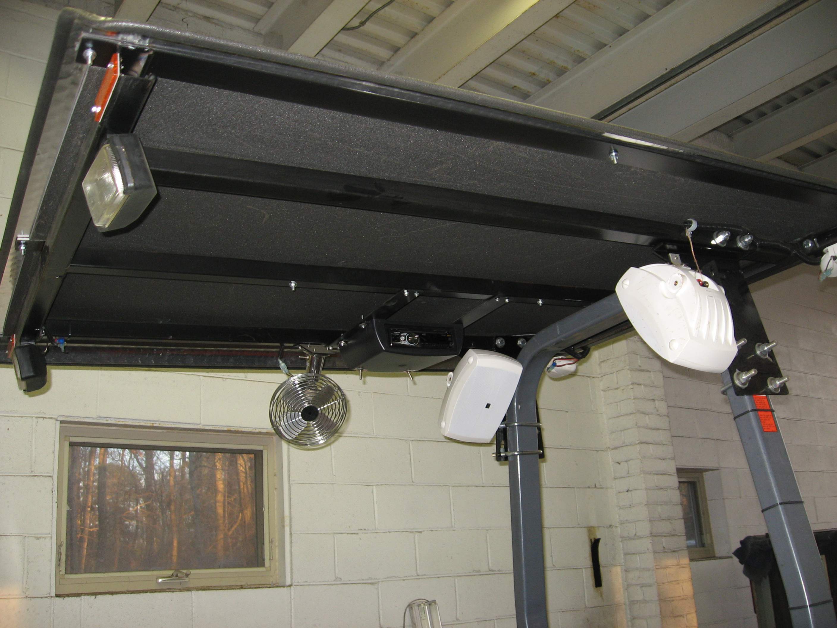

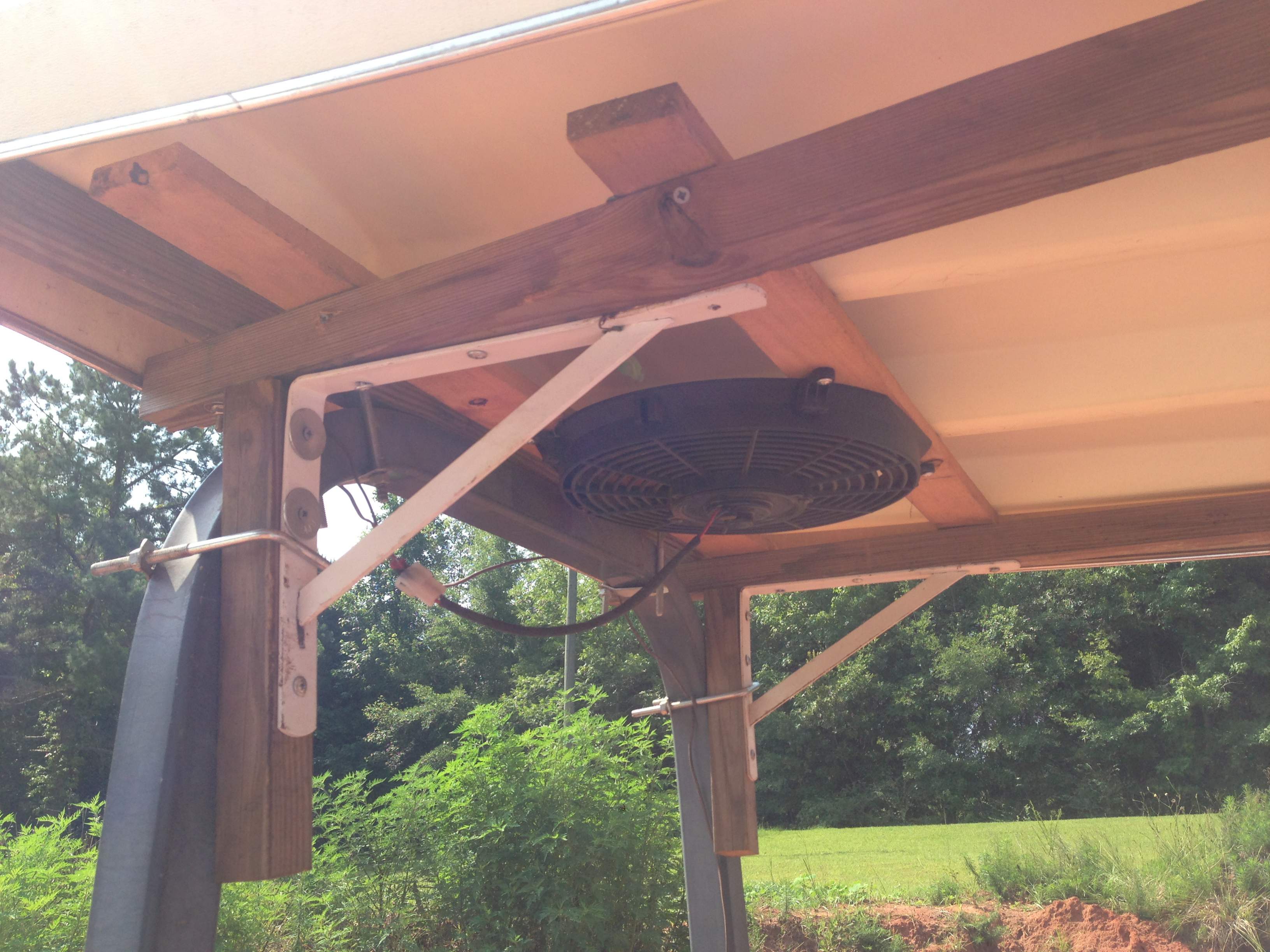

Here's a picture of the fan I added to my golf cart canopy on my tractor, it has a switch on it. Makes mowing in May through Sept. much more comfortable
Rancho

It looks like you still use the stock screw/know. Redneck felt it necessary to switch to a stronger/higher-grade screw. Maybe the stock screw is OK if there is no movement. Any comment on the stock screw?

I do have the stock screw and knob on one side and used the nut on the back of the knob to snug it up, the other side was broken off when I bought the tractor so I drilled it out and tapped it then put a grade 8 bolt in it (also with the shim). Snug and no wobble. As for the fan yeah it is the cheapest 12 volt car fan I could buy on e-bay 12" diameter I think.
Rancho
I really like your fan idea plus I think I have one laying around. I did a 12 volt RV fan but it never moved enough air, after many trailer rides at 70 MPH shaft broke. I am going to copy your idea on fan

OK, so here's my "final" solution to the rocking canopy/ROPS.
Using suggestions from others here (thanks), I replaced the stock screws with hardened (12mm x 1.75mm x40mm as I recall) number 8 bolts and glued (shoe goo) a small piece of hardened steel plate on the ROPS where the bolt contacts the ROPS.
Number 8 screws are commonly available (e,g, Lowes, Tractor Supply, etc) and 30-35 mm length may have been enough but I used 40mm. For the hardened steel plate, I sliced off two pieces from an old powered edger blade using a grinder/cutoff wheel.
I should add that the original bolts were significantly mushroomed at the ends from pressing against the ROPS and the ROPS was noticeably dented. I needed to grind off that mushroomed area with a Dremel tool before I could remove the original bolts.
Finally, it seems to me that some movement is unavoidable. The bolt does a great job of preventing movement at the upper pin. But it looks like movement at the lower pin is unavoidable considering the screw location.
But it's good enough, I think.
