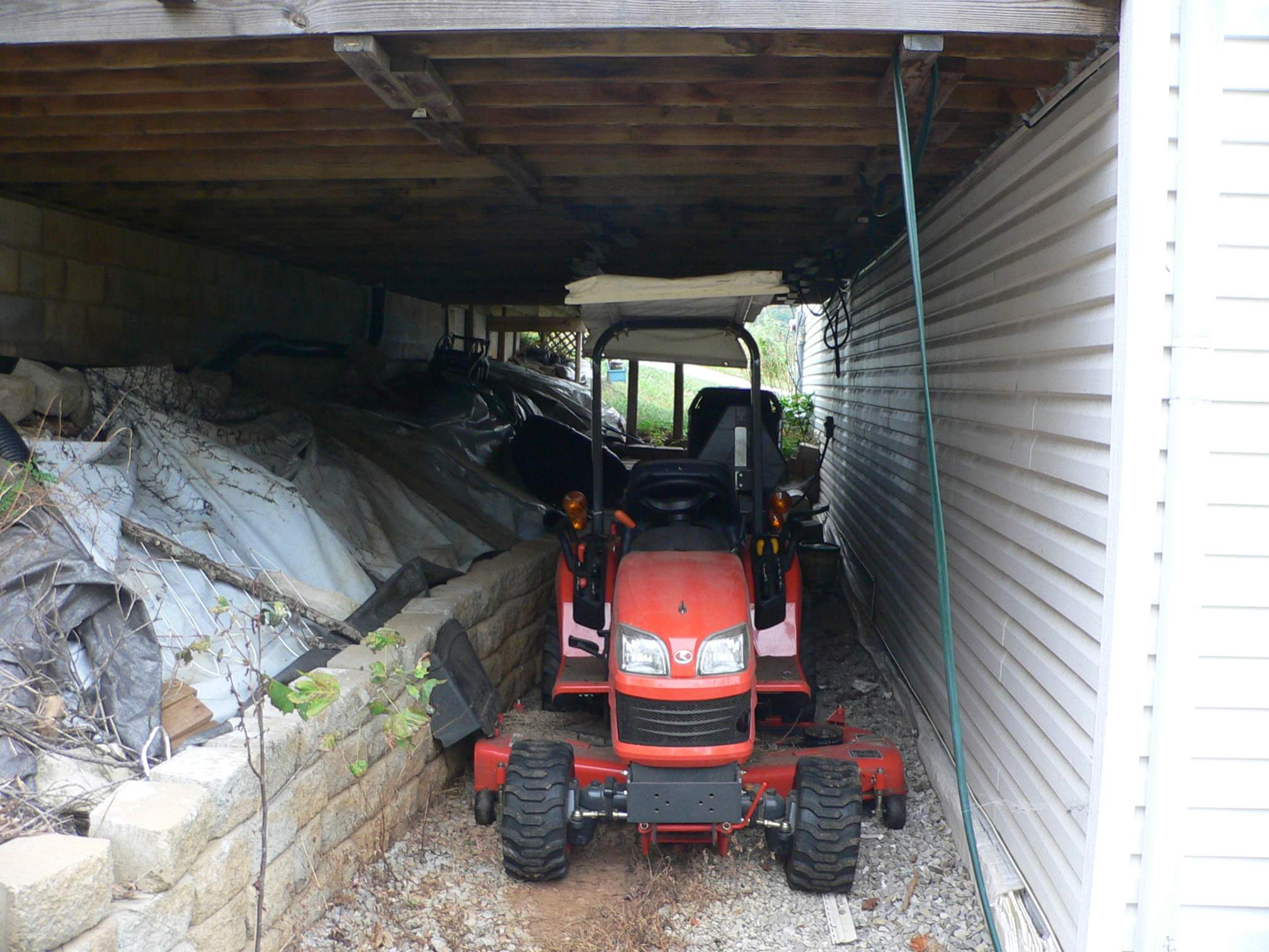

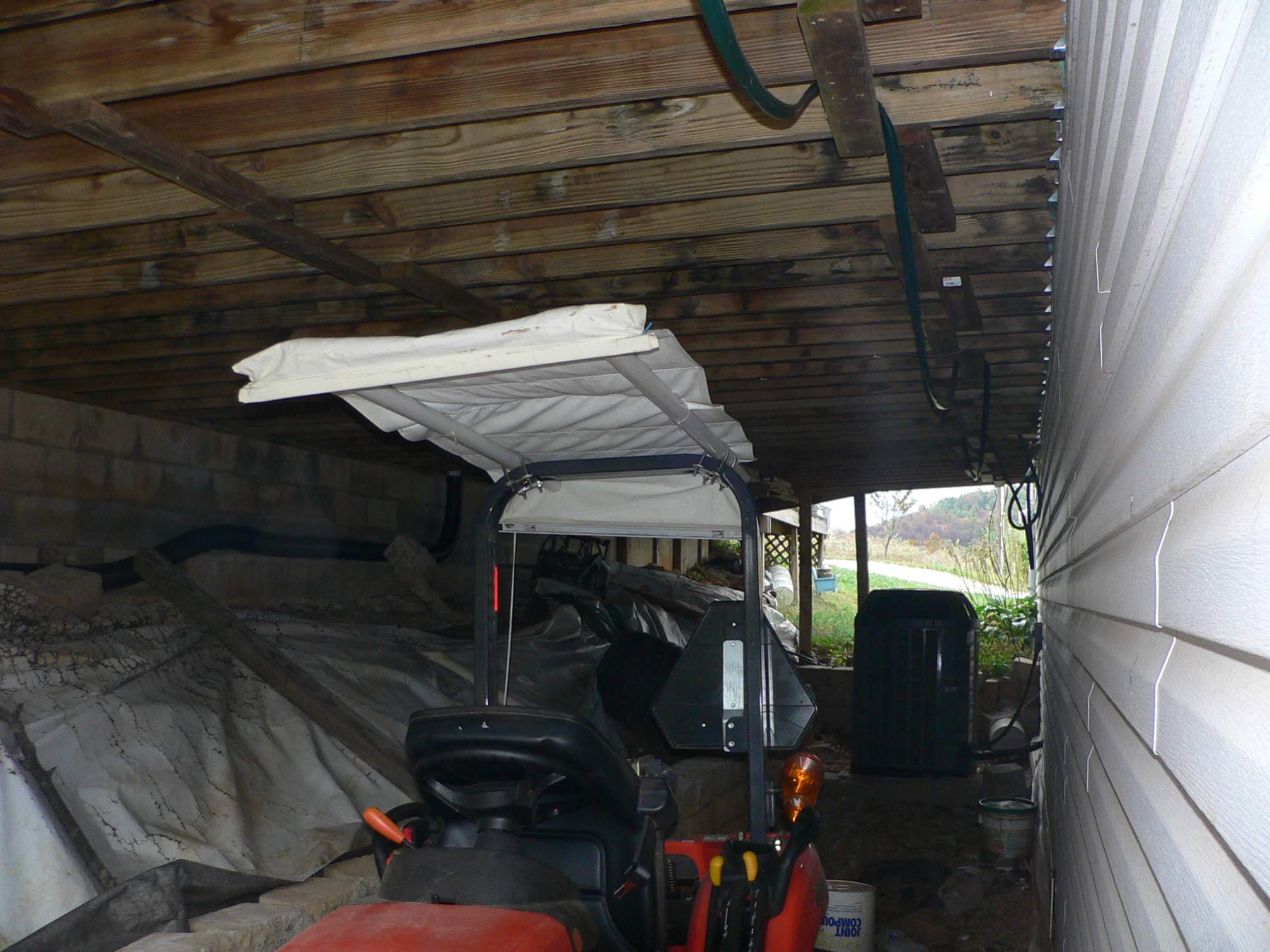

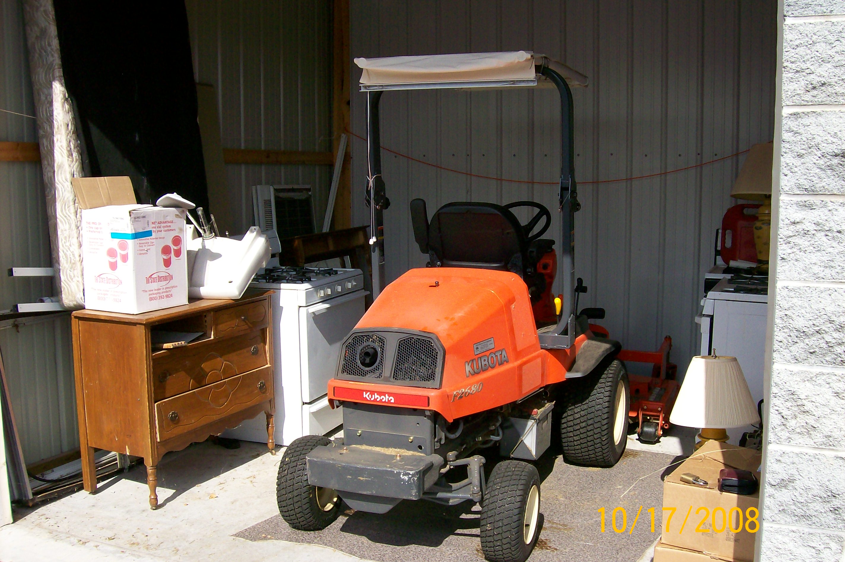

I made canopys for my F2880 and my BX. Happened to find the canvas shades (5) for $6 at a yard sale in Florence, SC and bought the stainless steel clamps at a local industrial supply company for $23. If there is any interest, I will supply more pictures of clamps.

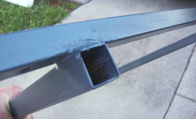

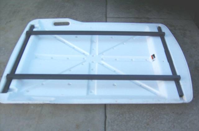

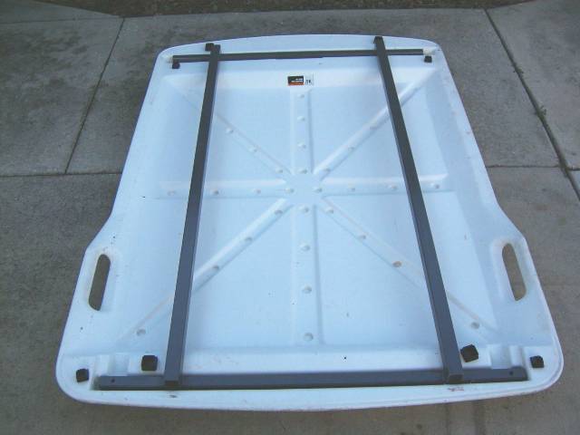

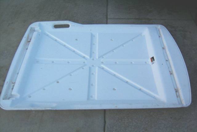

I am currently constructing one out of 1" & 1 1/4" square tubing and a hard poly golf cart cover purchased from a local golf cart refurbishing dealer.
I will take photos and post soon.
C-YA RL

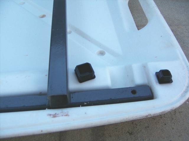

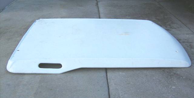

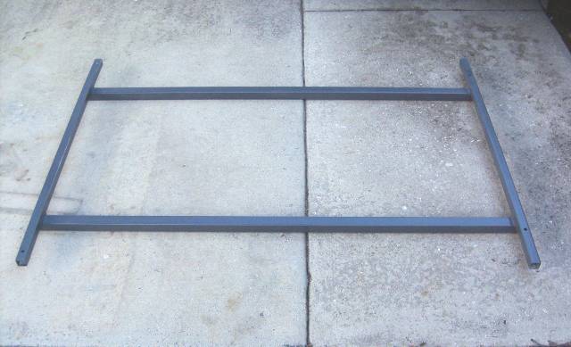

OK here are the photos that I promised. I have a total of about $85.00 in this one. That includes the cost for the tubing, tubing caps, bolts, paint, some angle for brackets and of course the poly top. I know I know it is not that cheap---but have you priced the ones from the dealer or after market shade suppliers?
I still have to weld on the mounting brackets, and I will take additional photos to show the results once mounted.
C-YA RL

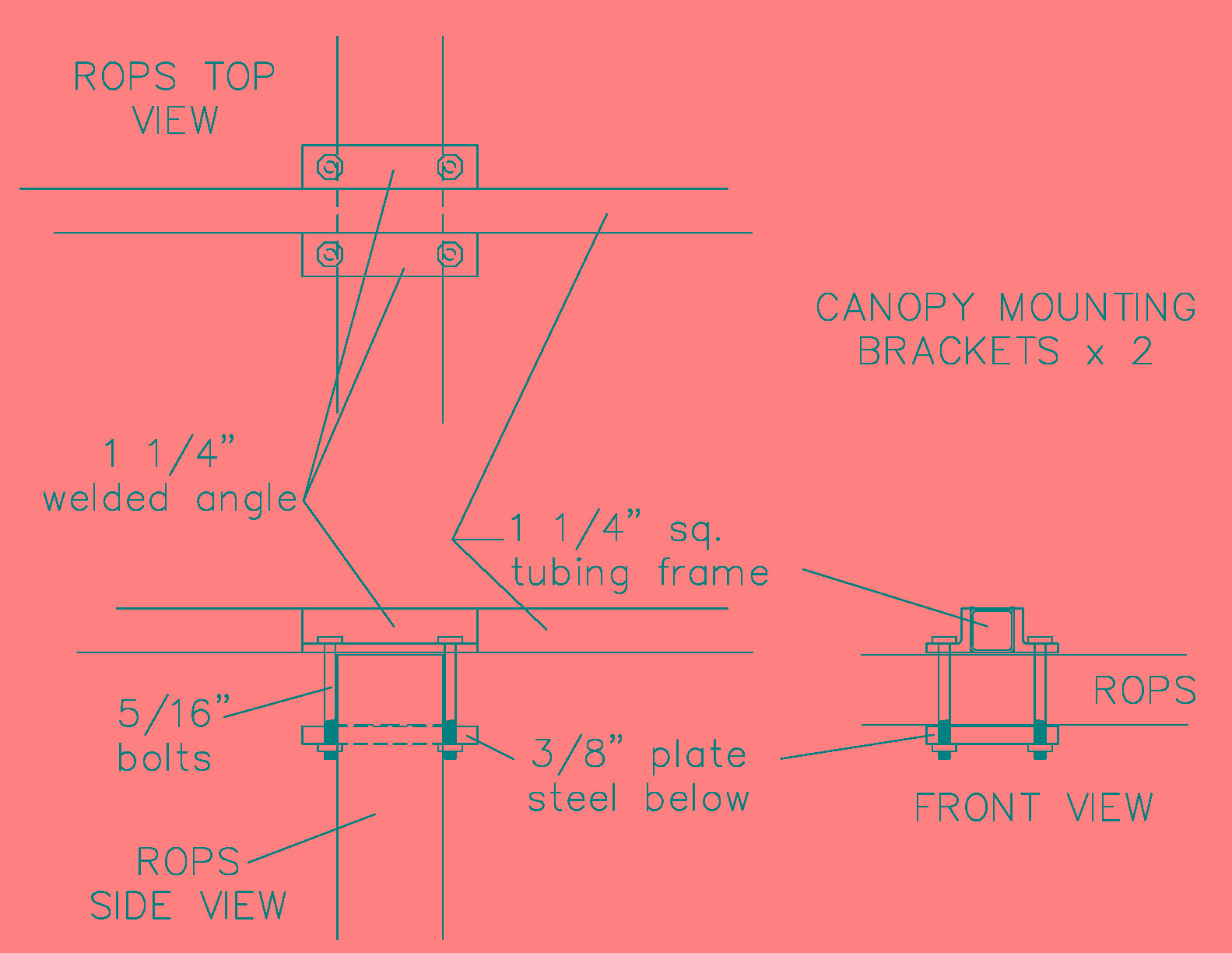

That look like it's going to work out really well. I may have to see if I can find a canopy like that around here. What are your thoughts for the actual mounting brackets on the ROPS?
/ Canopy/top for BXs' ??? #7
Here is something that I threw together on Aut-Cad. I hope you can decifer it. I know it may seem like a little overkill, but I want to make sure that the many trees that I have to maneuver through will not tear it off.
Thanks for asking C-YA RL

Sounds good, but be cautious of the PVC as it does not have that much structural strength. You wouldn't want to be wearing that canopy. LOL
Good luck C-YA RL

Looks good. That's right along the lines I was thinking. I just need to find a canopy...

With the frame that I have constructed you could use almost anything like a kids waiding pool :D, plywood, hardy panel, metal V siding, or even dimond plate---although the diamond plate might be somewhat expensive, it would be attractive.
Keep me posted on your progress.
C-YA RL

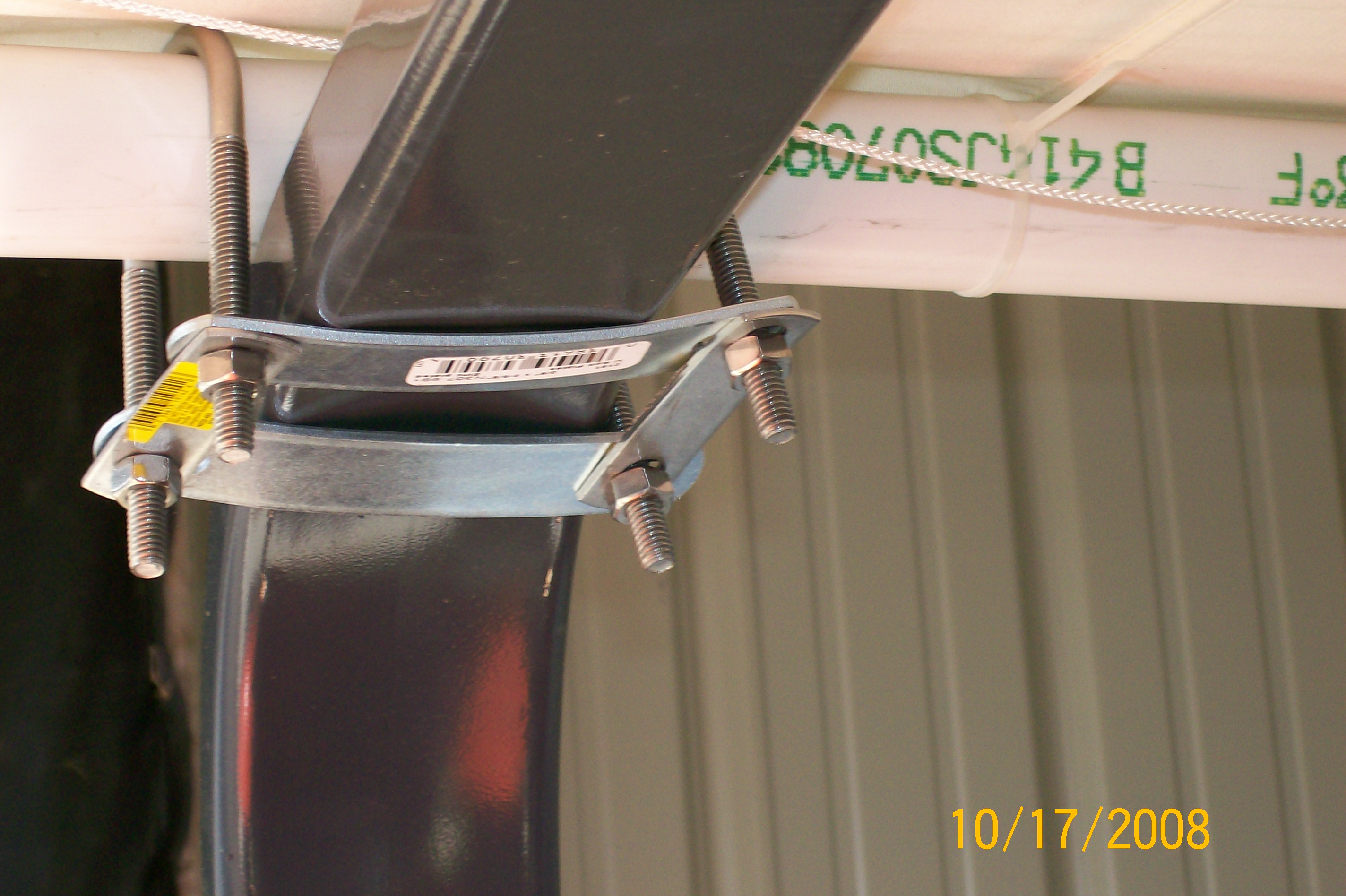

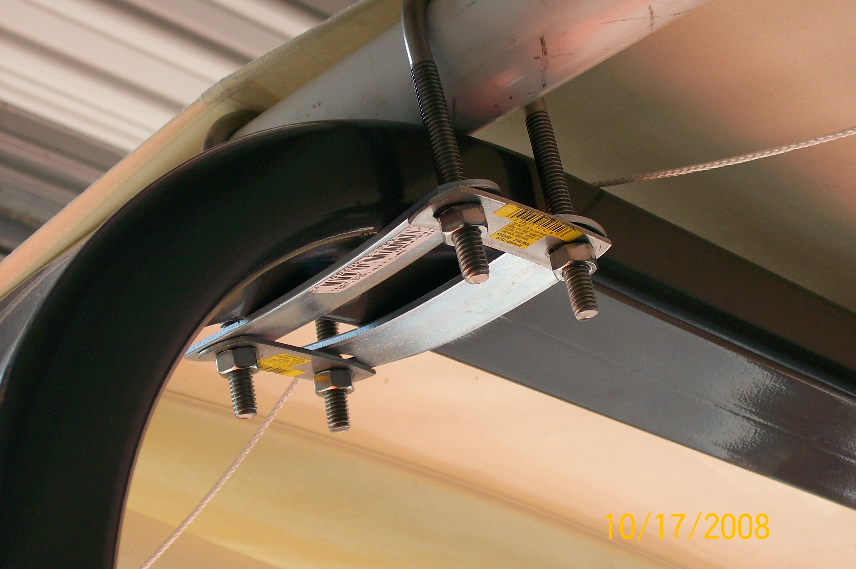

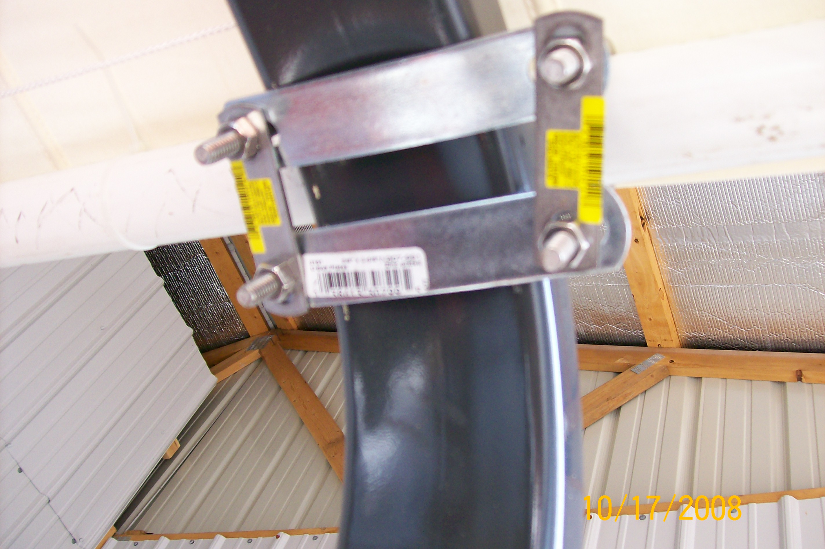

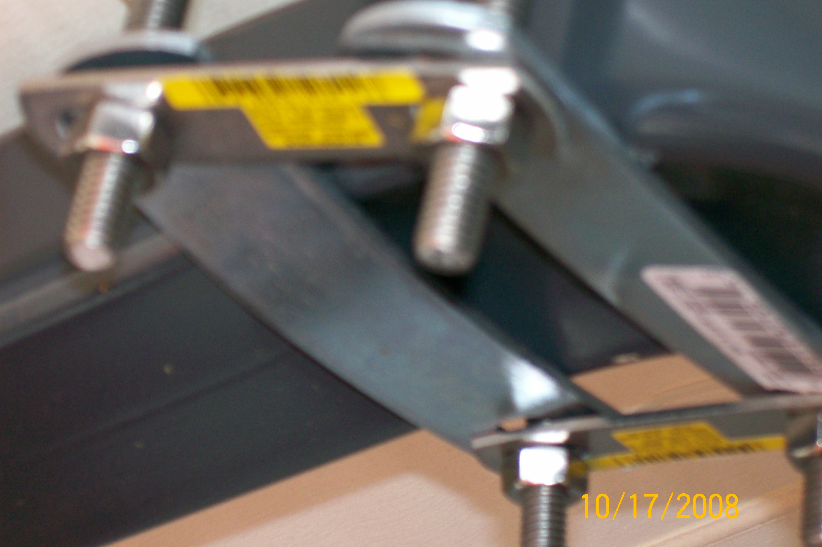

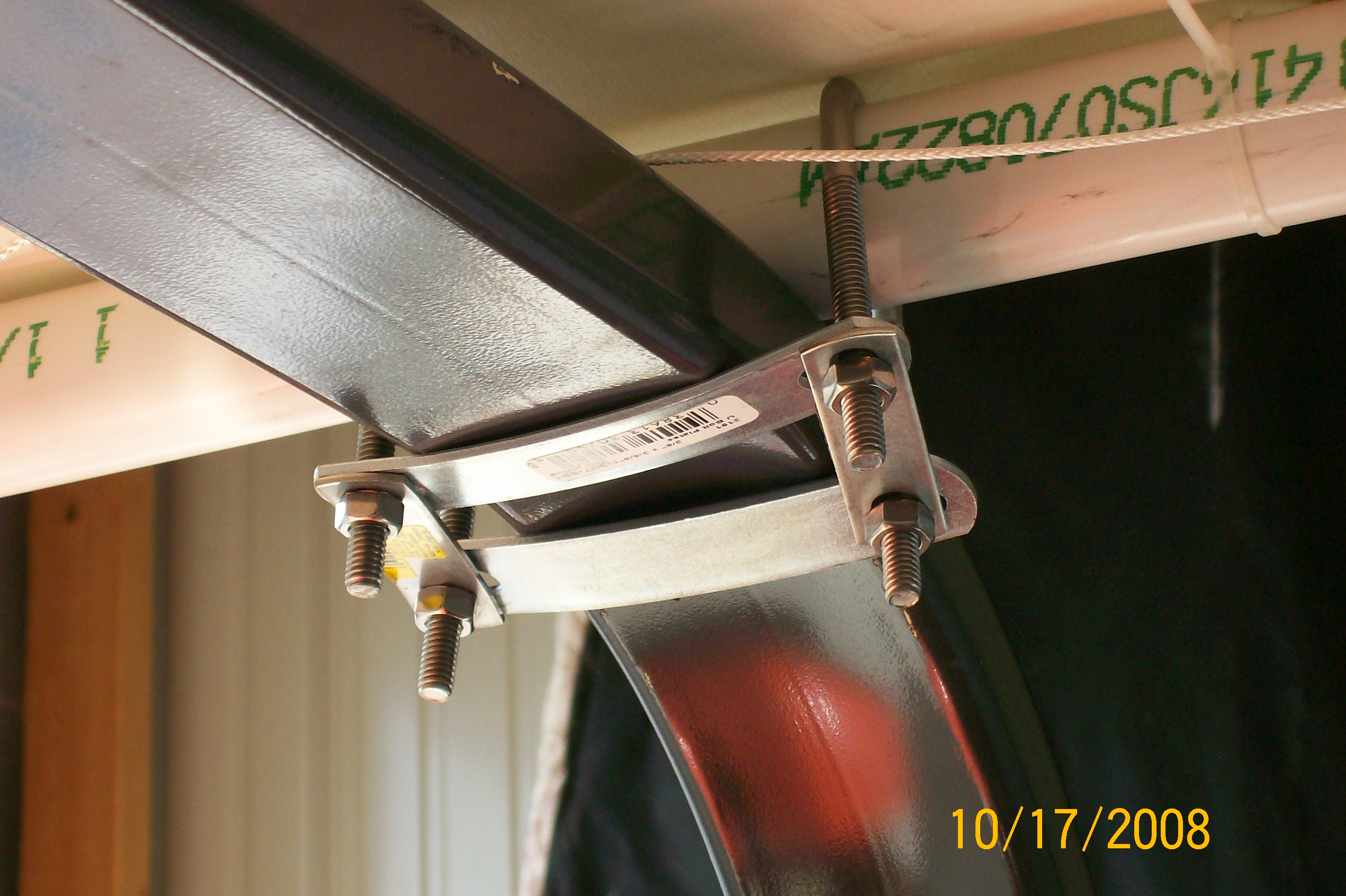

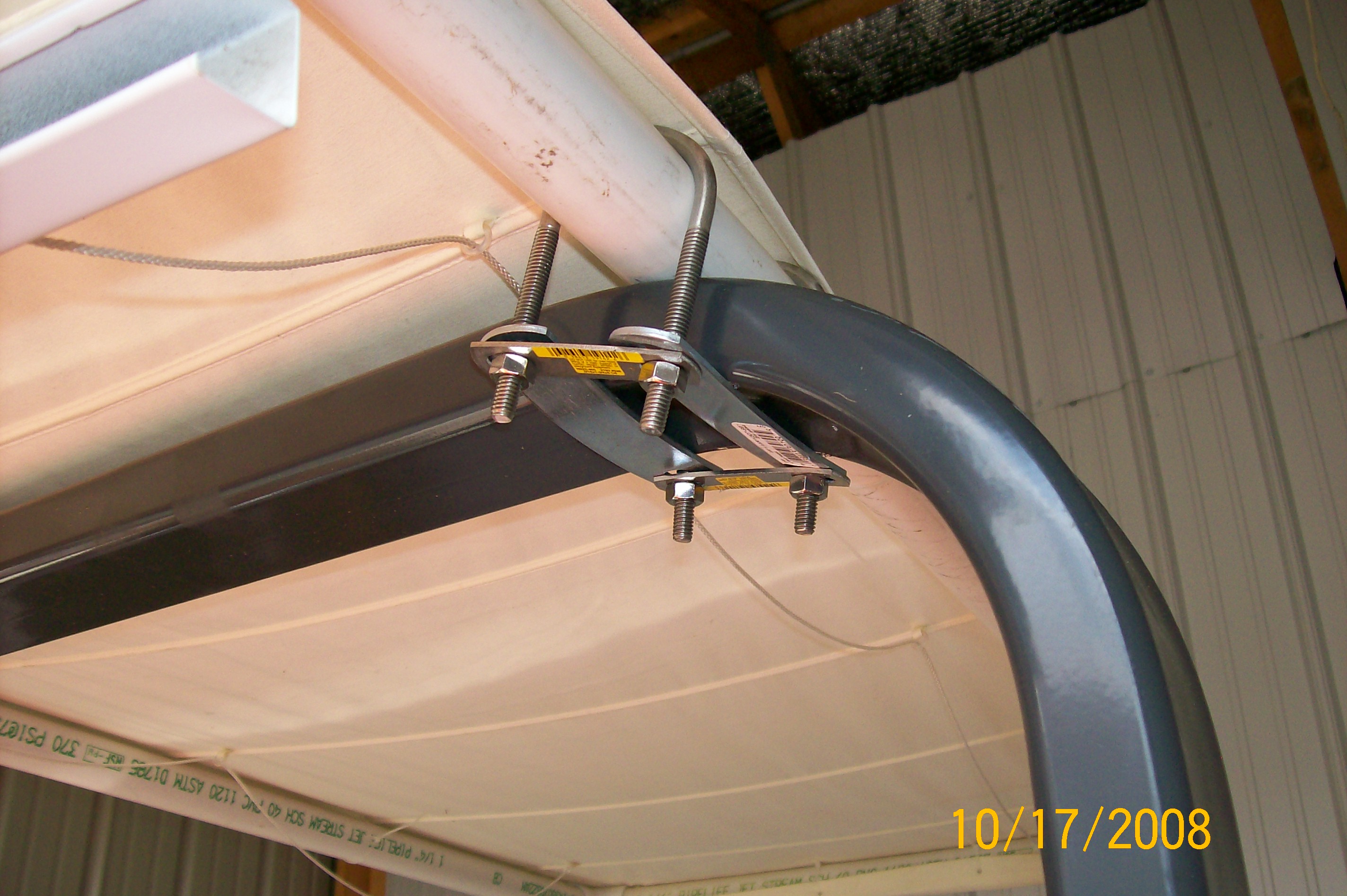

Here are pictures of the brackets I made/bought. They are stainless steel and the frame is schedule 40 1 1/2" pipe. Built one for my F and another for my BX2350. If I hit a limb the canvas slides out of the way and even if it tears it's no big loss. I just wanted cheap shade. I have the $400 cover on my L3240 and wish I had the money instead.
